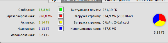

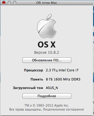

marklangovoi Posted November 27, 2012 Share Posted November 27, 2012 Hello. I have ASUS N56VZ. Ethernet AR8161 (work with kext) WiFi AR9485 (don't work) i7 3610GM Intel HD4000 (full work) gt650m 2gb ddr3 (don't work because optimum) 4 x USB 3.0 (work) i use patched chameleon (bug with ram was on original chameleon too) with own dsdt. Sleep work. In "About Mac" 8 GB RAM, in Monitoring only 3,25gb. Why? How to fix? I think system work in 64 bit, but how to check? Link to comment https://www.insanelymac.com/forum/topic/284624-not-all-ram-available/ Share on other sites More sharing options...

marklangovoi Posted November 28, 2012 Author Share Posted November 28, 2012 But what problem with ram? Link to comment https://www.insanelymac.com/forum/topic/284624-not-all-ram-available/#findComment-1869499 Share on other sites More sharing options...
p.H Posted November 28, 2012 Share Posted November 28, 2012 But what problem with ram? Try using only one ram and see what it shows ? Link to comment https://www.insanelymac.com/forum/topic/284624-not-all-ram-available/#findComment-1869535 Share on other sites More sharing options...
marklangovoi Posted November 29, 2012 Author Share Posted November 29, 2012 Bios don't have any memory parameters, only show how much ram i have. I and my friend find bug: chameleon (latest from SVN and an another versions) show parameters of ram's slots, but use only one slot minus graphic memory (Intel HD4000, in bios is parameter for setting how much memory i want) Link to comment https://www.insanelymac.com/forum/topic/284624-not-all-ram-available/#findComment-1869759 Share on other sites More sharing options...
