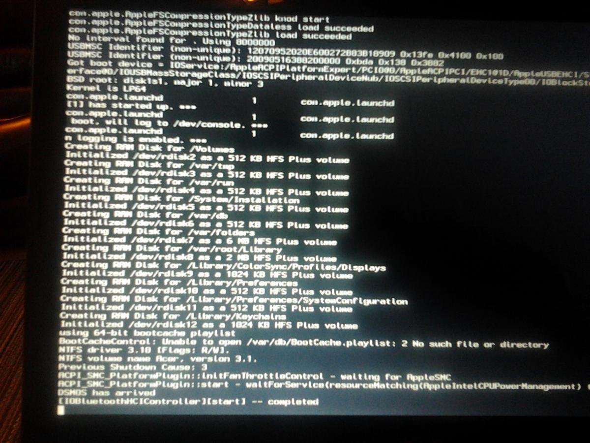

helpmehackintosh Posted September 19, 2012 Author Share Posted September 19, 2012 ok i got the retail version made the usb bootable using uuunnniiibeast latest version and now when i boot the acer it just comes up with the apple logo and the spinning circle thing below it like its loading and it just stays there forever how do i get past this? i need help doing this retail install i purchased the mountnlion but im confused been messing with this for hours help please? Link to comment https://www.insanelymac.com/forum/topic/281956-mountain-lion-108-on-my-acer-aspire-5742-7047-yes-or-no/#findComment-1853875 Share on other sites More sharing options...
artur_pt Posted September 19, 2012 Share Posted September 19, 2012 hi u can help us, if u boot -v and post a photo of the boot to see what happen the apple logo is nice, but don't say nothing, only the apple is eat... good hack Link to comment https://www.insanelymac.com/forum/topic/281956-mountain-lion-108-on-my-acer-aspire-5742-7047-yes-or-no/#findComment-1853879 Share on other sites More sharing options...
helpmehackintosh Posted September 19, 2012 Author Share Posted September 19, 2012 . Link to comment https://www.insanelymac.com/forum/topic/281956-mountain-lion-108-on-my-acer-aspire-5742-7047-yes-or-no/#findComment-1853888 Share on other sites More sharing options...
iFIRE Posted September 19, 2012 Share Posted September 19, 2012 use this boot flag : -f -v -x GraphicsEnabler=No npci=0x2000 USBBusFix=Yes Link to comment https://www.insanelymac.com/forum/topic/281956-mountain-lion-108-on-my-acer-aspire-5742-7047-yes-or-no/#findComment-1853889 Share on other sites More sharing options...

helpmehackintosh Posted September 19, 2012 Author Share Posted September 19, 2012 ok my usb drive blinked a little longer this time but still stuck on same screen just spinnin Link to comment https://www.insanelymac.com/forum/topic/281956-mountain-lion-108-on-my-acer-aspire-5742-7047-yes-or-no/#findComment-1853906 Share on other sites More sharing options...
artur_pt Posted September 19, 2012 Share Posted September 19, 2012 hi go in usb system/library/extensions and delete all kext appleintelhd*.kext boot again -f GraphicsEnabler=No u know probably u graphics don't work ? use this to see u hardware http://www.insanelymac.com/forum/index.php?showtopic=219584&hl=system%20info&st=0 good hack 1 Link to comment https://www.insanelymac.com/forum/topic/281956-mountain-lion-108-on-my-acer-aspire-5742-7047-yes-or-no/#findComment-1853912 Share on other sites More sharing options...

helpmehackintosh Posted September 19, 2012 Author Share Posted September 19, 2012 i am trying to make a hack but i have orignal mac i borrowed from friend to do this is there any easier way i downloaded and purchased mlion? i used [url="http://www.insanelymac.com/forum/topic/279450-why-insanelymac-does-not-support-tonymacx86/"]#####[/url] on mac to make the bootable but no luck am i doing something wrong ? ive been reading 10 hours straight no sleep full pack of ciggarettes and still no luck i don't like to give up hi go in usb system/library/extensions and delete all kext appleintelhd*.kext boot again -f GraphicsEnabler=No u know probably u graphics don't work ? use this to see u hardware http://www.insanelym...tem%20info&st=0 good hack hey its working for install i delted the kext files its installing but i never did that command you told me to try what was that for i guess it wont hurt install is quick i have ssd so wasted 10 hours whats a few more haha thanks for getting me this far Link to comment https://www.insanelymac.com/forum/topic/281956-mountain-lion-108-on-my-acer-aspire-5742-7047-yes-or-no/#findComment-1853927 Share on other sites More sharing options...
