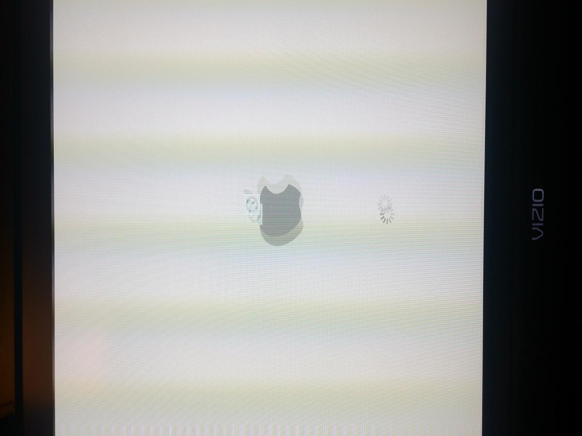

Dadycupcakes Posted August 14, 2012 Share Posted August 14, 2012 Ok, so I downloaded iatkos l2 burnt it to a dvd via transmac and it installed fine I checked all the drivers etc. I needed but when I go to boot the finished install it get hung up on the apple boot logo but a circle with a cross through it pops up after a few minutes, what is wrong with my install? specs: i7 930, EVGA x58 SLI 132-bl-e758 a1, 12GB 2000mhz XMS3, GTX 480 in SLI, 1TB WD HDD black caviar,sony sata DVD RW. Here is a pic that shows what I am talking about Link to comment https://www.insanelymac.com/forum/topic/281834-stuck-on-iatkos-l2-boot/ Share on other sites More sharing options...
rockinron_1 Posted August 14, 2012 Share Posted August 14, 2012 boot with -v then post the ouptut Link to comment https://www.insanelymac.com/forum/topic/281834-stuck-on-iatkos-l2-boot/#findComment-1844109 Share on other sites More sharing options...

Dadycupcakes Posted August 15, 2012 Author Share Posted August 15, 2012 Ok, I booted into -v and this is what it got hung up on. So I figured out that my bios was set on IDE instead of ahci so I fixed that it got past the boot then it comes to a screen that says your computer needs to be restarted hold power button etc. I ran -v again and it ran through everything and it got stuck on a grey screen after listing everything. What is the problem now? Link to comment https://www.insanelymac.com/forum/topic/281834-stuck-on-iatkos-l2-boot/#findComment-1844164 Share on other sites More sharing options...

rockinron_1 Posted August 15, 2012 Share Posted August 15, 2012 Remove one of the 480's. Boot with GraphicsEnabler=yes. Doe your mouse work at that grey screen? Link to comment https://www.insanelymac.com/forum/topic/281834-stuck-on-iatkos-l2-boot/#findComment-1844212 Share on other sites More sharing options...
Dadycupcakes Posted August 15, 2012 Author Share Posted August 15, 2012 Ok that seems to have done the trick I can finally get into the initial setup of my account etc. now, but my keyboard isn't working so I can't get passed the create your computer account, any ideas on how to fix that? It's a logitech keyboard plugged in through ps2 port. Link to comment https://www.insanelymac.com/forum/topic/281834-stuck-on-iatkos-l2-boot/#findComment-1844387 Share on other sites More sharing options...
