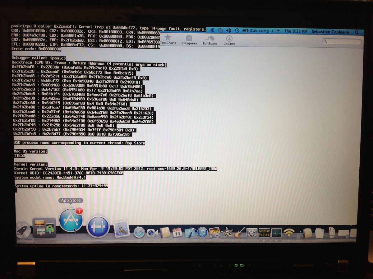

sebster101 Posted March 15, 2013 Share Posted March 15, 2013 Ok, I haven't upgraded to Mountain Lion yet, but I've been experiencing a lot of kernel panics lately with my OS X 10.7.4 installation. I have attached below an image of the kernel I get in verbose mode. What causes the kernel panic usually is plugging in the AC adapter to the laptop, unplugging it, and then launching certain applications (Mac App Store and Safari) I need help reading the kernel panic as i do not understand it myself. Could it be the Ethernet kext that i use? I've read a little about that online, but not sure. Here is the kernel panic. Any help would be gladly appreciated Thanks in advance. Link to comment https://www.insanelymac.com/forum/topic/281430-my-mini-guide-for-install-1074-on-lenovo-thinkpad-t61-7661-cto/page/2/#findComment-1896952 Share on other sites More sharing options...
HUSABER Posted March 15, 2013 Author Share Posted March 15, 2013 Ok, I haven't upgraded to Mountain Lion yet, but I've been experiencing a lot of kernel panics lately with my OS X 10.7.4 installation. I have attached below an image of the kernel I get in verbose mode. What causes the kernel panic usually is plugging in the AC adapter to the laptop, unplugging it, and then launching certain applications (Mac App Store and Safari) I need help reading the kernel panic as i do not understand it myself. Could it be the Ethernet kext that i use? I've read a little about that online, but not sure. Here is the kernel panic. Any help would be gladly appreciated Thanks in advance. Use this Ethernet kext,and also-try to test fixed DSDT for sleep :wink2: Archive.zip 1 Link to comment https://www.insanelymac.com/forum/topic/281430-my-mini-guide-for-install-1074-on-lenovo-thinkpad-t61-7661-cto/page/2/#findComment-1896968 Share on other sites More sharing options...
sebster101 Posted March 15, 2013 Share Posted March 15, 2013 Ok, unfortunately I installed the kext and installed the fixed DSDT, and sleep still wakes after 2-3 seconds (even after I set my hibernate to different modes using your guide) and I still get a kernel panic upon opening apps such as the AppStore after plugging and unplugging the computer from the AC adapter. Must I need to uninstall my old Ethernet kext? Thanks in advance. Link to comment https://www.insanelymac.com/forum/topic/281430-my-mini-guide-for-install-1074-on-lenovo-thinkpad-t61-7661-cto/page/2/#findComment-1896975 Share on other sites More sharing options...
HUSABER Posted March 15, 2013 Author Share Posted March 15, 2013 Ok, unfortunately I installed the kext and installed the fixed DSDT, and sleep still wakes after 2-3 seconds (even after I set my hibernate to different modes using your guide) and I still get a kernel panic upon opening apps such as the AppStore after plugging and unplugging the computer from the AC adapter. Must I need to uninstall my old Ethernet kext? Thanks in advance. Yes,uninstall all Ethernet.kexts(Also inside Extra folder if you use installed Ethernet.kext)and install new in System/Library/Extensions with KextWizard,after rebuild kextcache with this command on Terminal: sudo kextcache -v 1 -a i386 -a x86_64 -m /System/Library/Caches/com.apple.kext.caches/Startup/Extensions.mkext /System/Library/Extensions 1 Link to comment https://www.insanelymac.com/forum/topic/281430-my-mini-guide-for-install-1074-on-lenovo-thinkpad-t61-7661-cto/page/2/#findComment-1896983 Share on other sites More sharing options...
sebster101 Posted March 15, 2013 Share Posted March 15, 2013 Yes, that worked perfect!!! Thank you so much! You are the best! Now if I could only get sleep working... is there anything else I could try? Thank you so much. Much better now. Link to comment https://www.insanelymac.com/forum/topic/281430-my-mini-guide-for-install-1074-on-lenovo-thinkpad-t61-7661-cto/page/2/#findComment-1896996 Share on other sites More sharing options...
