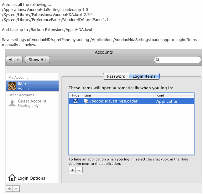

HUSABER Posted June 26, 2012 Share Posted June 26, 2012 This is work Delete old Voodoo first Copy HDA folder to Root/Library Copy App to/Aplication/Utilities Install kext to S/L/E Link to comment https://www.insanelymac.com/forum/topic/279978-do-i-have-3-sound-devices/#findComment-1829585 Share on other sites More sharing options...
raziiq Posted June 27, 2012 Author Share Posted June 27, 2012 This is work Delete old Voodoo first Copy HDA folder to Root/Library Copy App to/Aplication/Utilities Install kext to S/L/E Thanks for the file but sound is still not working. I can see the output devices but cant hear any sound. Also my System Info is not showing any details about the Sound. What i think is that i have two sound devices, one my normal Sound device and other is Graphics HDMI sound. Because of these both having conflict as system gets confused which one to use, i am not getting any sound, well its a wild guess. Tried some patches, adding device ids and all in kexts but never worked. More suggestions are welcome Link to comment https://www.insanelymac.com/forum/topic/279978-do-i-have-3-sound-devices/#findComment-1829678 Share on other sites More sharing options...

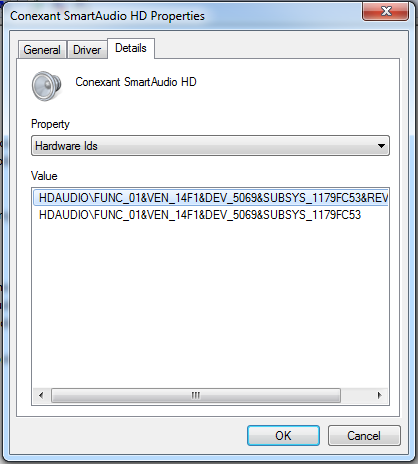

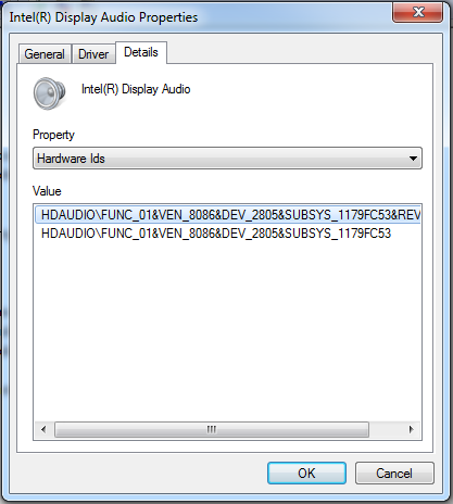

raziiq Posted August 1, 2012 Author Share Posted August 1, 2012 Well this is getting really confusing now. System Info in mac shows i have 1c20, however Device Manager in Windows says a different story. Device Manager says i have 2805. Screenshots attached! Please advise how to approach this, Link to comment https://www.insanelymac.com/forum/topic/279978-do-i-have-3-sound-devices/#findComment-1839717 Share on other sites More sharing options...
HUSABER Posted August 1, 2012 Share Posted August 1, 2012 AIDA64 show?what?I dont believe Windows ............. Link to comment https://www.insanelymac.com/forum/topic/279978-do-i-have-3-sound-devices/#findComment-1839738 Share on other sites More sharing options...
raziiq Posted August 1, 2012 Author Share Posted August 1, 2012 Ya this is really really confusing, and is driving me nuts. Tried System Info (Mac) suggested 1c20 but that didnt work either. Furthermore, Conexant device doesnt show up in System Info (mac), so dont know what to go with. Suggestions? Link to comment https://www.insanelymac.com/forum/topic/279978-do-i-have-3-sound-devices/#findComment-1839751 Share on other sites More sharing options...
HUSABER Posted August 2, 2012 Share Posted August 2, 2012 Maybe this help you for Voodoo how to enable 2 or 3 devices,for me work..... Link to comment https://www.insanelymac.com/forum/topic/279978-do-i-have-3-sound-devices/#findComment-1840162 Share on other sites More sharing options...

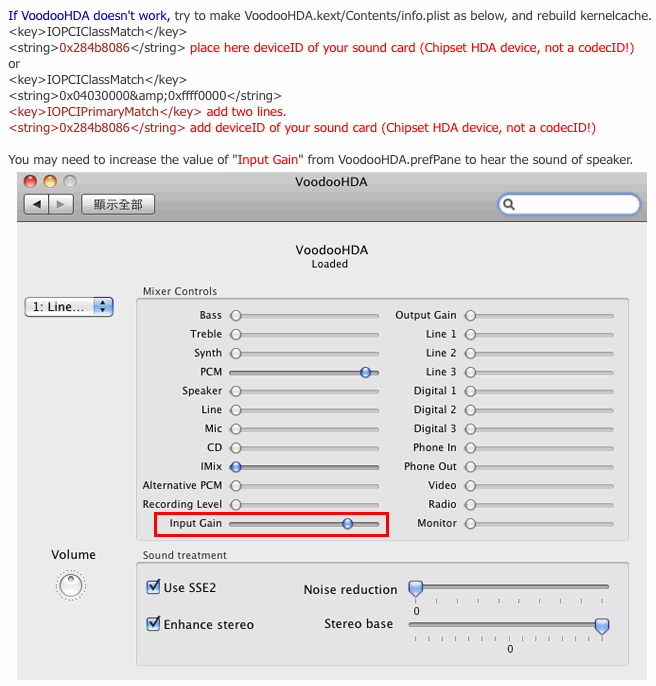

raziiq Posted August 4, 2012 Author Share Posted August 4, 2012 Did a lot, still not working. Here is the plist with voodooLoader 2.7.4, modified with my device ids <?xml version="1.0" encoding="UTF-8"?> <!DOCTYPE plist PUBLIC "-//Apple//DTD PLIST 1.0//EN" "http://www.apple.com/DTDs/PropertyList-1.0.dtd"> <plist version="1.0"> <dict> <key>CFBundleDevelopmentRegion</key> <string>English</string> <key>CFBundleExecutable</key> <string>VoodooHDA</string> <key>CFBundleIdentifier</key> <string>org.voodoo.driver.VoodooHDA</string> <key>CFBundleInfoDictionaryVersion</key> <string>6.0</string> <key>CFBundleName</key> <string>VoodooHDA</string> <key>CFBundlePackageType</key> <string>KEXT</string> <key>CFBundleShortVersionString</key> <string>2.7.4</string> <key>CFBundleSignature</key> <string>????</string> <key>CFBundleVersion</key> <string>2.7.4</string> <key>IOKitPersonalities</key> <dict> <key>HDMI</key> <dict> <key>CFBundleIdentifier</key> <string>org.voodoo.driver.VoodooHDA</string> <key>IOClass</key> <string>VoodooHDADevice</string> <key>IOMatchCategory</key> <string>VoodooHDADevice</string> <key>IOPCIPrimaryMatch</key> <string>0x1c208086</string> <key>IOProviderClass</key> <string>IOPCIDevice</string> <key>IOUserClientClass</key> <string>VoodooHDAUserClient</string> <key>InhibitCache</key> <true/> <key>MixerValues</key> <dict> <key>PCM</key> <string>90</string> <key>Rec</key> <string>70</string> <key>iGain</key> <string>0</string> <key>iMix</key> <string>0</string> </dict> <key>NodesToPatch</key> <array> <dict> <key>Codec</key> <integer>0</integer> <key>Enable</key> <integer>0</integer> <key>Node</key> <integer>11</integer> </dict> </array> <key>Noise</key> <integer>0</integer> <key>Vectorize</key> <true/> <key>VoodooHDAEnableHalfMicVolumeFix</key> <false/> <key>VoodooHDAEnableHalfVolumeFix</key> <false/> <key>VoodooHDAEnableMuteFix</key> <false/> <key>VoodooHDAEnableVolumeChangeFix</key> <false/> <key>VoodooHDAVerboseLevel</key> <integer>0</integer> </dict> <key>SoundCard</key> <dict> <key>CFBundleIdentifier</key> <string>org.voodoo.driver.VoodooHDA</string> <key>IOClass</key> <string>VoodooHDADevice</string> <key>IOMatchCategory</key> <string>VoodooHDADevice</string> <key>IOPCIPrimaryMatch</key> <string>0x14f15069</string> <key>IOProviderClass</key> <string>IOPCIDevice</string> <key>IOUserClientClass</key> <string>VoodooHDAUserClient</string> <key>InhibitCache</key> <true/> <key>MixerValues</key> <dict> <key>PCM</key> <string>90</string> <key>Rec</key> <string>70</string> <key>iGain</key> <string>0</string> <key>iMix</key> <string>0</string> </dict> <key>NodesToPatch</key> <array> <dict> <key>Codec</key> <integer>0</integer> <key>Enable</key> <integer>0</integer> <key>Node</key> <integer>11</integer> </dict> </array> <key>Noise</key> <integer>0</integer> <key>Vectorize</key> <true/> <key>VoodooHDAEnableHalfMicVolumeFix</key> <false/> <key>VoodooHDAEnableHalfVolumeFix</key> <false/> <key>VoodooHDAEnableMuteFix</key> <false/> <key>VoodooHDAEnableVolumeChangeFix</key> <false/> <key>VoodooHDAVerboseLevel</key> <integer>0</integer> </dict> </dict> <key>OSBundleLibraries</key> <dict> <key>com.apple.iokit.IOAudioFamily</key> <string>1.1fc9</string> <key>com.apple.iokit.IOPCIFamily</key> <string>2.1</string> <key>com.apple.kpi.iokit</key> <string>9.0.0</string> <key>com.apple.kpi.libkern</key> <string>9.0.0</string> <key>com.apple.kpi.mach</key> <string>9.0.0</string> <key>com.apple.kpi.unsupported</key> <string>9.0.0</string> </dict> </dict> </plist> Link to comment https://www.insanelymac.com/forum/topic/279978-do-i-have-3-sound-devices/#findComment-1841040 Share on other sites More sharing options...
raziiq Posted August 4, 2012 Author Share Posted August 4, 2012 <string>0x1c208086</string> not good , rename to <string>0x80861c20</string> Remember for next time- first is Vendor ID 8086,next is Device ID 1c20 Didnt Work. Here is the plist with Ven_ID first and Dev_ID later. <?xml version="1.0" encoding="UTF-8"?> <!DOCTYPE plist PUBLIC "-//Apple//DTD PLIST 1.0//EN" "http://www.apple.com/DTDs/PropertyList-1.0.dtd"> <plist version="1.0"> <dict> <key>CFBundleDevelopmentRegion</key> <string>English</string> <key>CFBundleExecutable</key> <string>VoodooHDA</string> <key>CFBundleIdentifier</key> <string>org.voodoo.driver.VoodooHDA</string> <key>CFBundleInfoDictionaryVersion</key> <string>6.0</string> <key>CFBundleName</key> <string>VoodooHDA</string> <key>CFBundlePackageType</key> <string>KEXT</string> <key>CFBundleShortVersionString</key> <string>2.7.4</string> <key>CFBundleSignature</key> <string>????</string> <key>CFBundleVersion</key> <string>2.7.4</string> <key>IOKitPersonalities</key> <dict> <key>HDMI</key> <dict> <key>CFBundleIdentifier</key> <string>org.voodoo.driver.VoodooHDA</string> <key>IOClass</key> <string>VoodooHDADevice</string> <key>IOMatchCategory</key> <string>VoodooHDADevice</string> <key>IOPCIPrimaryMatch</key> <string>0x80861c20</string> <key>IOProviderClass</key> <string>IOPCIDevice</string> <key>IOUserClientClass</key> <string>VoodooHDAUserClient</string> <key>InhibitCache</key> <true/> <key>MixerValues</key> <dict> <key>PCM</key> <string>90</string> <key>Rec</key> <string>70</string> <key>iGain</key> <string>0</string> <key>iMix</key> <string>0</string> </dict> <key>NodesToPatch</key> <array> <dict> <key>Codec</key> <integer>0</integer> <key>Enable</key> <integer>0</integer> <key>Node</key> <integer>11</integer> </dict> </array> <key>Noise</key> <integer>0</integer> <key>Vectorize</key> <true/> <key>VoodooHDAEnableHalfMicVolumeFix</key> <false/> <key>VoodooHDAEnableHalfVolumeFix</key> <false/> <key>VoodooHDAEnableMuteFix</key> <false/> <key>VoodooHDAEnableVolumeChangeFix</key> <false/> <key>VoodooHDAVerboseLevel</key> <integer>0</integer> </dict> <key>SoundCard</key> <dict> <key>CFBundleIdentifier</key> <string>org.voodoo.driver.VoodooHDA</string> <key>IOClass</key> <string>VoodooHDADevice</string> <key>IOMatchCategory</key> <string>VoodooHDADevice</string> <key>IOPCIPrimaryMatch</key> <string>0x506914f1</string> <key>IOProviderClass</key> <string>IOPCIDevice</string> <key>IOUserClientClass</key> <string>VoodooHDAUserClient</string> <key>InhibitCache</key> <true/> <key>MixerValues</key> <dict> <key>PCM</key> <string>90</string> <key>Rec</key> <string>70</string> <key>iGain</key> <string>0</string> <key>iMix</key> <string>0</string> </dict> <key>NodesToPatch</key> <array> <dict> <key>Codec</key> <integer>0</integer> <key>Enable</key> <integer>0</integer> <key>Node</key> <integer>11</integer> </dict> </array> <key>Noise</key> <integer>0</integer> <key>Vectorize</key> <true/> <key>VoodooHDAEnableHalfMicVolumeFix</key> <false/> <key>VoodooHDAEnableHalfVolumeFix</key> <false/> <key>VoodooHDAEnableMuteFix</key> <false/> <key>VoodooHDAEnableVolumeChangeFix</key> <false/> <key>VoodooHDAVerboseLevel</key> <integer>0</integer> </dict> </dict> <key>OSBundleLibraries</key> <dict> <key>com.apple.iokit.IOAudioFamily</key> <string>1.1fc9</string> <key>com.apple.iokit.IOPCIFamily</key> <string>2.1</string> <key>com.apple.kpi.iokit</key> <string>9.0.0</string> <key>com.apple.kpi.libkern</key> <string>9.0.0</string> <key>com.apple.kpi.mach</key> <string>9.0.0</string> <key>com.apple.kpi.unsupported</key> <string>9.0.0</string> </dict> </dict> </plist> With this way, i cant even get a speaker icon on menu bar, and there are no output device in Settings>Sound. Furthermore i get a "Cant get registry blah blah" in Setting>VoodooHDA Link to comment https://www.insanelymac.com/forum/topic/279978-do-i-have-3-sound-devices/#findComment-1841060 Share on other sites More sharing options...
