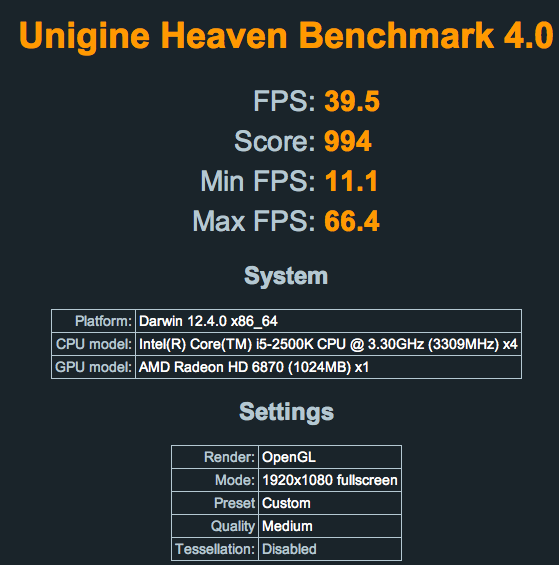

camillionario Posted July 3, 2013 Share Posted July 3, 2013 Muchas Gracias amigos,,,He conseguido que funcionen todos los conectores de mi Shappire Radeon 6870 HD con sonido HDMI y reconocida por el Sistema en Mountain Lion 10.8.4. Radeon_bios_decoce PCI ID: 1002:6738 Connector at index 0 DisplayPort (10) Encoder: INTERNAL_UNIPHY2 (0x21) OSX senseid: 0x1 Connector at index 1 HDMI-A (11) Encoder: INTERNAL_UNIPHY2 (0x21) OSX senseid: 0x4 Connector at index 2 DVI-D (3) Encoder: INTERNAL_UNIPHY1 (0x20) OSX senseid: 0x6 Connector at index 3 DVI-I (2) Encoder: INTERNAL_UNIPHY (0x1e) OSX senseid: 0x5 Redsock_bios_decoder Connector Object Id [19] [DISPLAY_PORT] encoder obj id [0x21] INTERNAL_UNIPHY2 osx txmit 0x12 [duallink 0x2] enc 0x4 Connector Object Id [12] [HDMI_TYPE_A] encoder obj id [0x21] INTERNAL_UNIPHY2 osx txmit 0x22 [duallink 0x2] enc 0x5 Connector Object Id [3] [DVI_D] encoder obj id [0x20] INTERNAL_UNIPHY1 osx txmit 0x11 [duallink 0x1] enc 0x2 Connector Object Id [2] [DVI_I] encoder obj id [0x1e] INTERNAL_UNIPHY osx txmit 0x10 [duallink 0x0] enc 0x0 El resultado es este: 0000000 00 04 00 00 04 03 00 00 00 01 00 00 12 04 04 01 Puerto 0 DP 0000010 04 00 00 00 14 00 00 00 00 01 00 00 10 00 03 05 Puerto 1 DVI-I 0000020 00 08 00 00 04 02 00 00 00 01 00 00 22 05 01 04 Puerto 2 HDMI 0000030 04 00 00 00 14 00 00 00 00 01 00 00 11 02 06 06 Puerto 3 DVI-D mi Boot.Plist es este: <key>Credits</key> <string>Created with Champlist</string> <key>GenerateCStates</key> <string>Yes</string> <key>GeneratePStates</key> <string>Yes</string> <key>Kernel</key> <string>mach_kernel</string> <key>Kernel Flags</key> <string>darkwake=10</string> <key>Legacy Logo</key> <string>Yes</string> <key>Timeout</key> <string>1</string> <key>UseKernelCache</key> <string>Yes</string> </dict> </plist> Funcionando sin ningun inyector grafico via Chameleon. Saludos Link to comment https://www.insanelymac.com/forum/topic/278122-guia-instalaci%C3%B3n-de-ati-radeon-6850-en-lion/page/4/#findComment-1929958 Share on other sites More sharing options...
juanerson Posted July 3, 2013 Share Posted July 3, 2013 Para inyección nativa desde la DSDT o cualquier otro inyector, se recomienda establecer el parámetro como GraphicsEnabler=No porque la opción por defecto (con o sin flag) en Chameleon es GE=Yes. Saludos. Link to comment https://www.insanelymac.com/forum/topic/278122-guia-instalaci%C3%B3n-de-ati-radeon-6850-en-lion/page/4/#findComment-1929960 Share on other sites More sharing options...
camillionario Posted July 5, 2013 Share Posted July 5, 2013 Gracias juanerson,, lo he tomado en cuenta y lo he insertado en el c.b.p. Link to comment https://www.insanelymac.com/forum/topic/278122-guia-instalaci%C3%B3n-de-ati-radeon-6850-en-lion/page/4/#findComment-1930443 Share on other sites More sharing options...
