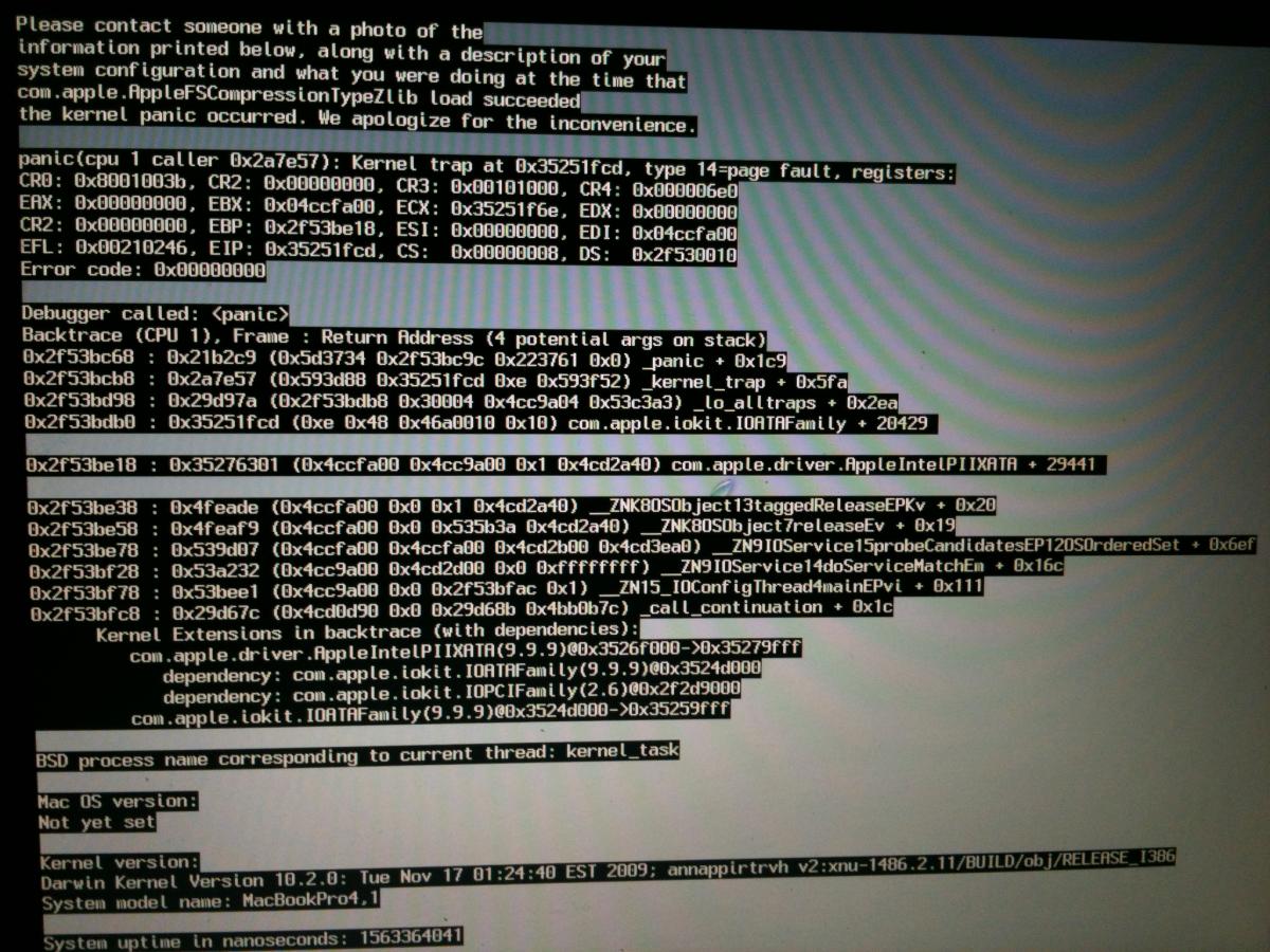

dbzu Posted April 5, 2012 Share Posted April 5, 2012 ive tried to install hazard 10.6.6i on my ibm but i got a kernel panic.. what should i do ? intel core 2 due 5600 1.83GH 2gb ram 120g hard drive Quote Link to comment https://www.insanelymac.com/forum/topic/277855-kernel-panic-on-my-ibm-t60/ Share on other sites More sharing options...
sirbow2 Posted April 6, 2012 Share Posted April 6, 2012 you need to change the AHCI/IDE settings in your bios if you have them. if you dont have AHCI/IDE settings in bios, then you will need another kext. Quote Link to comment https://www.insanelymac.com/forum/topic/277855-kernel-panic-on-my-ibm-t60/#findComment-1811448 Share on other sites More sharing options...
tobiask Posted April 6, 2012 Share Posted April 6, 2012 try to boot with -x -v (Safe Mode and Verbose Mode) and look if you can start the install program. And look for the AHCI settings. Quote Link to comment https://www.insanelymac.com/forum/topic/277855-kernel-panic-on-my-ibm-t60/#findComment-1811504 Share on other sites More sharing options...

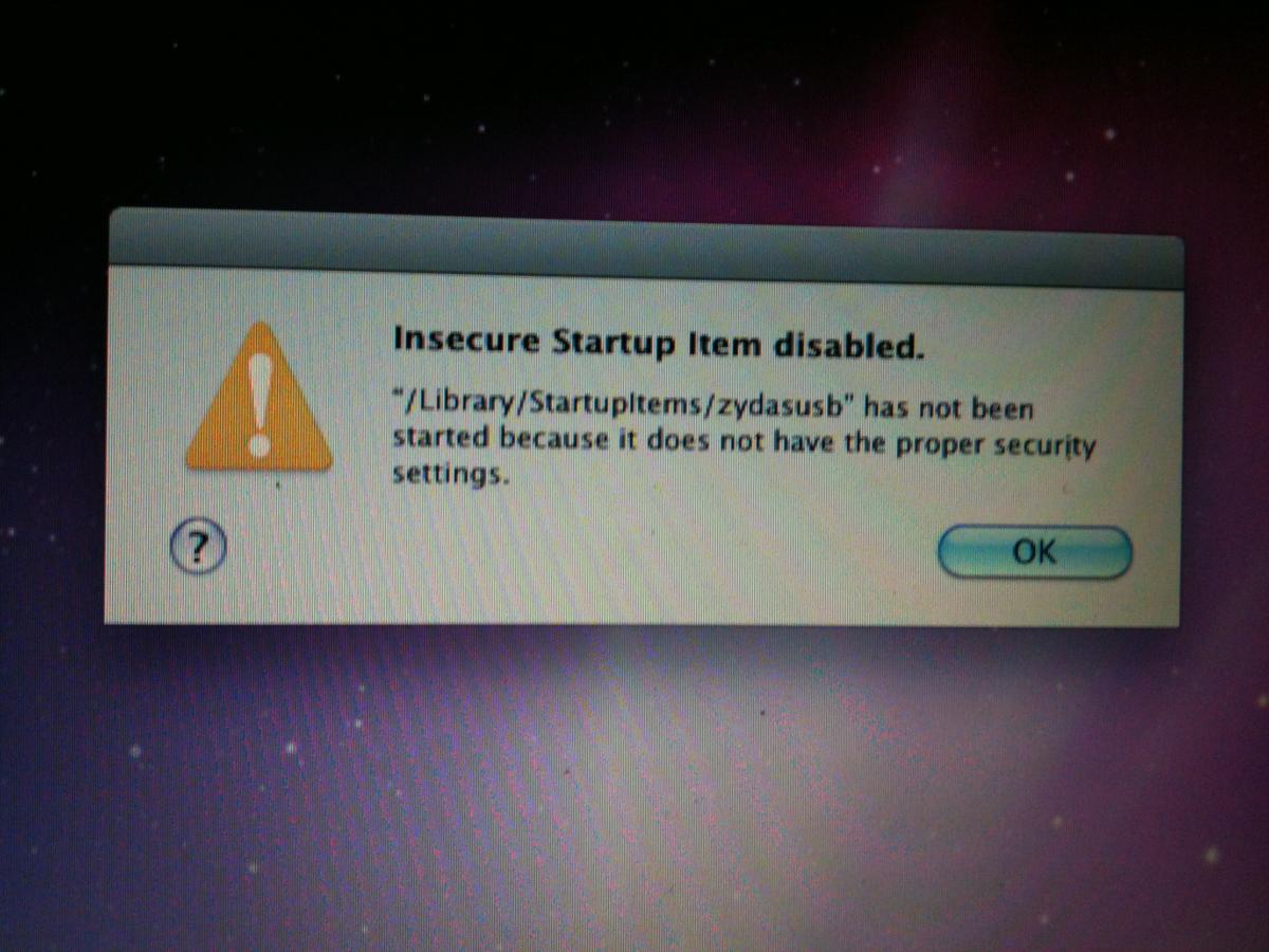

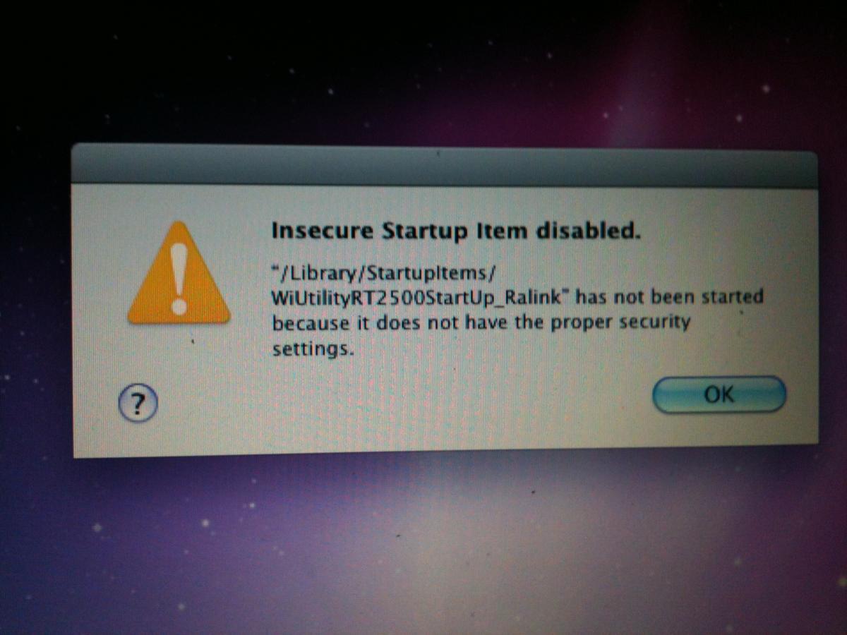

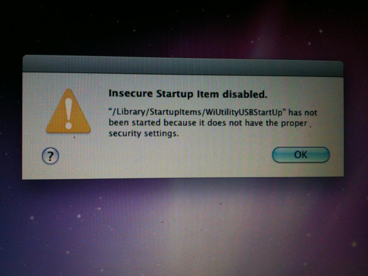

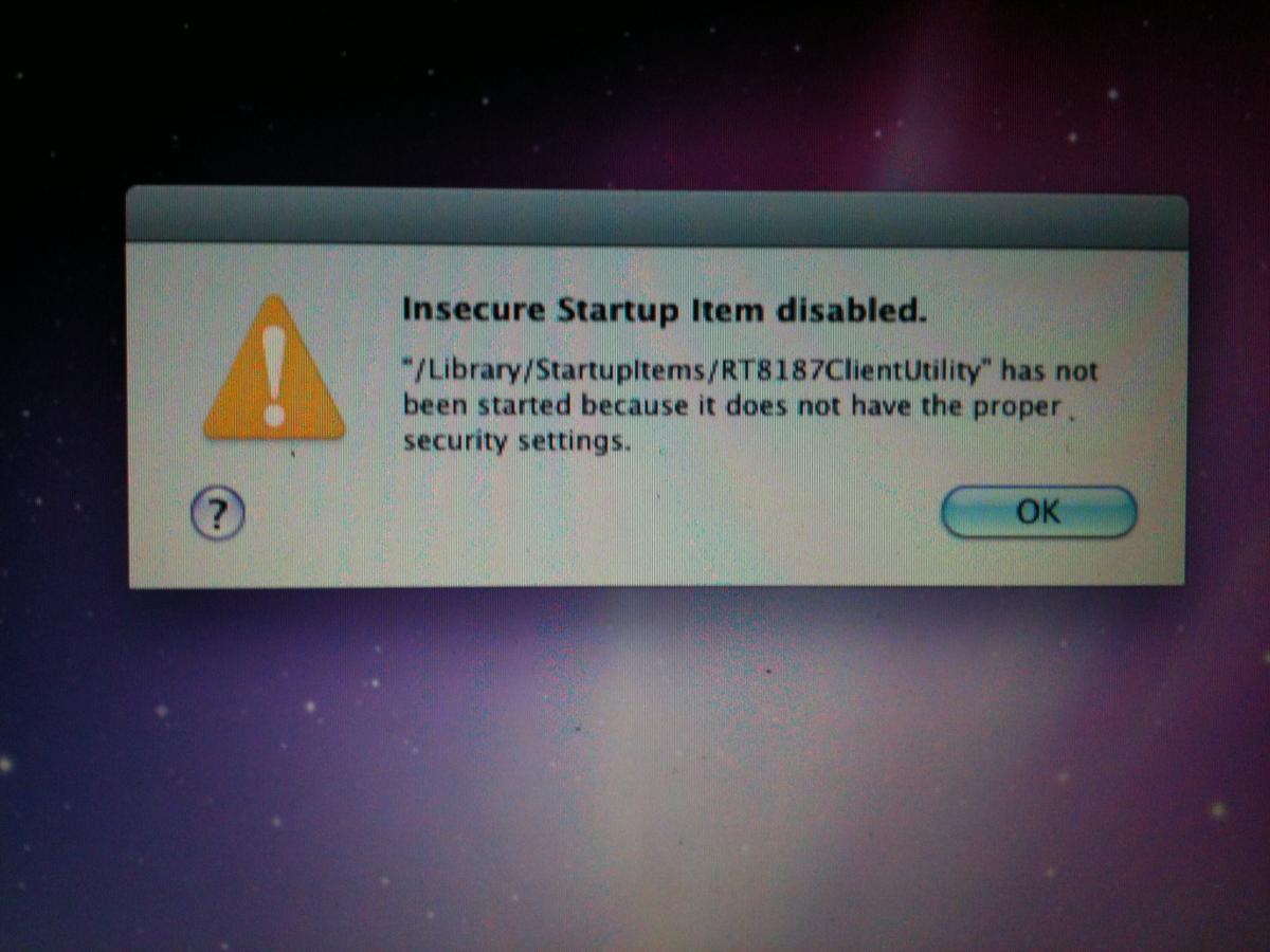

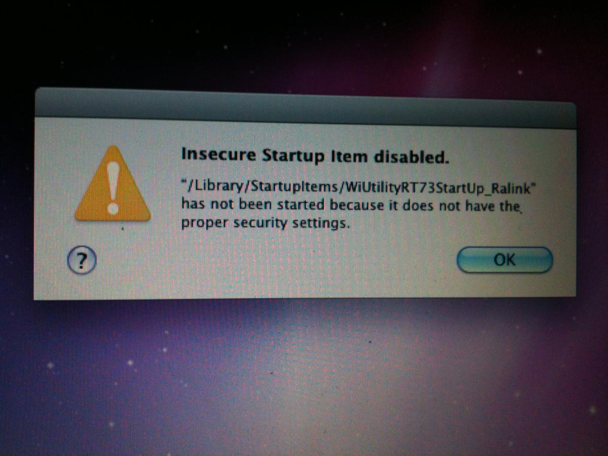

dbzu Posted April 6, 2012 Author Share Posted April 6, 2012 ive changed the ide setting (it was on AHCI) and it worked but i have a few problems,, ive installed the chamilion rc5 bootloader and it steel dont work, so i booted with the hazard disk and it show me these messages : also , the double tap on the touchpad dont work , i cant see the battery Percent and the wireless dont work,, is there any way to fix those things? ohh and when i close the screen it wont go on sleep mode Quote Link to comment https://www.insanelymac.com/forum/topic/277855-kernel-panic-on-my-ibm-t60/#findComment-1811541 Share on other sites More sharing options...
rlf Posted April 6, 2012 Share Posted April 6, 2012 Battery: Google: Voodoo Battery Sleep: maybe Sleep Enabler will help Touchpad: play around with some PS2 Controllers Wireless: the pictures you posted are what is causing wireless to not work. I've never seen a message like that one. Try this: 1. Open Terminal found in /Applications/Utilities 2. Type: sudo chown -R root:wheel /Library/StartupItems (give your password when asked, then press <Enter>) 3. Reboot Quote Link to comment https://www.insanelymac.com/forum/topic/277855-kernel-panic-on-my-ibm-t60/#findComment-1811553 Share on other sites More sharing options...

dbzu Posted April 6, 2012 Author Share Posted April 6, 2012 OK i did it, i think it worked but after i did it it just wrote the same line as he always write when you open the terminal , so i reboted and again same messages , what else i can do ? Quote Link to comment https://www.insanelymac.com/forum/topic/277855-kernel-panic-on-my-ibm-t60/#findComment-1811604 Share on other sites More sharing options...
rlf Posted April 6, 2012 Share Posted April 6, 2012 Again, I've never seen that "security" error before. Here is what Apple says about it: http://support.apple.com/kb/TS3493 Quote Link to comment https://www.insanelymac.com/forum/topic/277855-kernel-panic-on-my-ibm-t60/#findComment-1811608 Share on other sites More sharing options...
