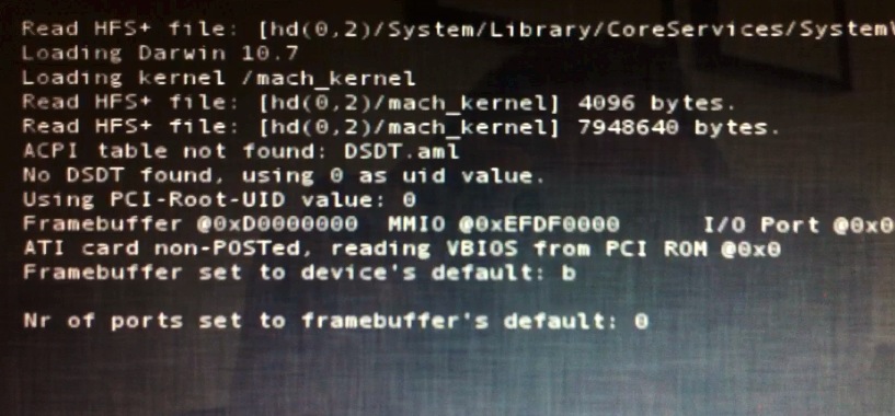

Franko73 Posted February 19, 2012 Share Posted February 19, 2012 Hi all, looking for a bit of help. Ive been using iAtkos S3 V2 (10.6.3) for a while and decided to update to iAtkos L2 (10.7.2) so I did a full clean install with the basic requirements for install, pretty much the same I used for 10.6.3 and after a successful installation I get the following problem on boot using -v -x -cpus=1, any help appreciated Read HFS+ file: [hd 0,.2)/System/Library/CoreServices/System... Loading Darwin 16.7 Loading kernel /mach_kernel Read HFS+ file: [hd(0,2)/mach_kernel] 4096 bytes. Read HFS+ file: [hd(0.2)mach_kernel] 7948646 bytes ACPI table not found: DSDT.aml No DSDT found, using 0 as uid value. Using PCI-Root-UID value: 0 Fraaebuffer @0x06666066 MMIO @0xEFDF0660 I/O Port 0x00 ATI card non-POSTed. reading VBIOS from PCI ROM 0x00 Framebuffer set to device's default: b Nr of ports set to framebuffer's default: 0 Dell inspiron 6400, intel duo core 2 T2700, 2gb ram, raedon x1400 Quote Link to comment https://www.insanelymac.com/forum/topic/276156-iatkos-l2-boot-problem-help/ Share on other sites More sharing options...

Foxic Posted February 21, 2012 Share Posted February 21, 2012 Something to do with your AMD/ATi graphics card and the installed frame buffer. Try using single user mode to remove/move all AMD/ATi related kexts. Something like: mkdir /Users/Me/Desktop/Kext\ Backup sudo mv -rf /System/Library/Extensions/ATI*.* /Users/Me/Desktop/Kext\ Backup/ then reboot with -f, rebuild caches etc. Quote Link to comment https://www.insanelymac.com/forum/topic/276156-iatkos-l2-boot-problem-help/#findComment-1799318 Share on other sites More sharing options...
Franko73 Posted February 22, 2012 Author Share Posted February 22, 2012 thanks James, I did some searching after your hint and found out what the problem is.... you are right, its the ATI card and legacy issues with SL 2.6.8 and Lion, I found some threads on here to get it sorted so hopefully Ill get it working.... thanks. Im running 2.6.7 hence I didnt encounter the problem before. Quote Link to comment https://www.insanelymac.com/forum/topic/276156-iatkos-l2-boot-problem-help/#findComment-1799504 Share on other sites More sharing options...
