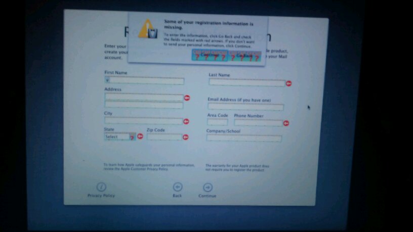

Nirmal kumar Posted January 23, 2012 Share Posted January 23, 2012 i installed l2 in vaio having graphics card intel x3100.install goes fine but in first startup got these errors......pls help.. still having the same issue............... and none of the applications are opening, system preferences also pls help..... Link to comment https://www.insanelymac.com/forum/topic/274974-graphic-error-after-installing-iatkos-l2-in-vaio/ Share on other sites More sharing options...
Foxic Posted January 23, 2012 Share Posted January 23, 2012 Incorrect framebuffer, find one that's patched for your device ID Link to comment https://www.insanelymac.com/forum/topic/274974-graphic-error-after-installing-iatkos-l2-in-vaio/#findComment-1788697 Share on other sites More sharing options...
Nirmal kumar Posted January 23, 2012 Author Share Posted January 23, 2012 i am a newbie for os x .can u JamesLitter assist me how to correct my deviceID......... Link to comment https://www.insanelymac.com/forum/topic/274974-graphic-error-after-installing-iatkos-l2-in-vaio/#findComment-1788698 Share on other sites More sharing options...
Foxic Posted January 23, 2012 Share Posted January 23, 2012 Find the device ID for your graphics card. Either boot into a linux distro and run lspci, or install OS X 86 Tools and use that to find your device ID. Then using a hex editor, open the AppleIntelIntelIntegratedFramebuffer from within AppleIntelIntelIntegratedFramebuffer.kext and replace the device ID of a similar card with your own device IDs Link to comment https://www.insanelymac.com/forum/topic/274974-graphic-error-after-installing-iatkos-l2-in-vaio/#findComment-1788737 Share on other sites More sharing options...
