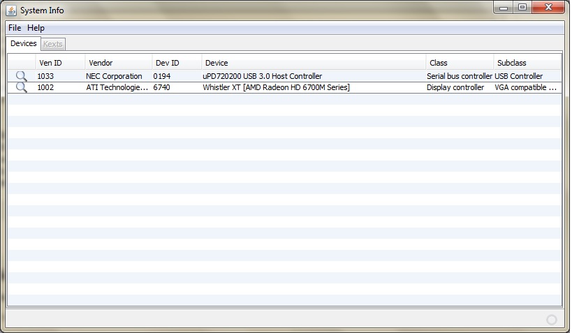

artur_pt Posted January 9, 2012 Share Posted January 9, 2012 olá boa noite em primeiro posta carateristicas do teu note cpu gráfica som atualiza teu profile, na assinatura, qualquer coisa parecido com o k tenho no final da resposta.. podes usar system info http://www.insanelymac.com/forum/index.php?showtopic=219582 bom hack Link to comment https://www.insanelymac.com/forum/topic/274443-help-instala%C3%A7%C3%A3o-do-lion-em-hp-pavilion-dv6-6047cl/#findComment-1784756 Share on other sites More sharing options...
aramakau Posted January 10, 2012 Author Share Posted January 10, 2012 Usei o Everest Placa mãe: Tipo de processador Mobile QuadCore Intel Core i7-2630QM, 2200 MHz (22 x 100) Nome da Placa Mãe Hewlett-Packard HP Pavilion dv6 Notebook PC Chipset da Placa Mãe Intel Cougar Point HM65, Intel Sandy Bridge Memória do Sistema [ TRIAL VERSION ] DIMM1: Hynix HMT351S6BFR8C-H9 4 GB DDR3-1333 DDR3 SDRAM (8-8-8-22 @ 609 MHz) (7-7-7-20 @ 533 MHz) (6-6-6-17 @ 457 MHz) (5-5-5-14 @ 380 MHz) DIMM3: Hynix HMT351S6BFR8C-H9 [ TRIAL VERSION ] Tipo de BIOS Insyde (07/20/2011) Monitor: Adaptador gráfico Mobile Intel® HD Graphics (3938232 KB) Adaptador gráfico Mobile Intel® HD Graphics (3938232 KB) Acelerador 3D Intel HD Graphics 2000 Monitor Samsung 156AT05-H07 [15.6" LCD] Multimídia: Adaptador de som IDT 92HD81B1X @ Intel Cougar Point PCH - High Definition Audio Controller [b-2] Adaptador de som Intel Cougar Point HDMI @ Intel Cougar Point PCH - High Definition Audio Controller [b-2] Armazenamento: Controladora IDE Intel® Mobile Express Chipset SATA AHCI Controller Controladora IDE Realtek PCIE CardReader Disco rígido TOSHIBA MK1059GSM (1000 GB, 5400 RPM, SATA-II) Drive óptico hp BD E DS6E2LH Status dos discos rígidos SMART OK Partições: C: (NTFS) [ TRIAL VERSION ] D: (NTFS) 17138 MB (2152 MB livre) F: (NTFS) 452.8 GB (433.0 GB livre) Tamanho total [ TRIAL VERSION ] Dispositivos de entrada: Teclado Standard PS/2 Keyboard Mouse Synaptics PS/2 Port TouchPad Rede: Endereço IP principal [ TRIAL VERSION ] Endereço MAC principal 40-2C-F4-33-6E-28 Adaptador de Rede Bluetooth Device (Personal Area Network) Adaptador de Rede Broadcom 4313 802.11b/g/n (192. [ TRIAL VERSION ]) Adaptador de Rede Realtek PCIe GBE Family Controller Usando o System info so apareceu 2 1 Link to comment https://www.insanelymac.com/forum/topic/274443-help-instala%C3%A7%C3%A3o-do-lion-em-hp-pavilion-dv6-6047cl/#findComment-1784890 Share on other sites More sharing options...

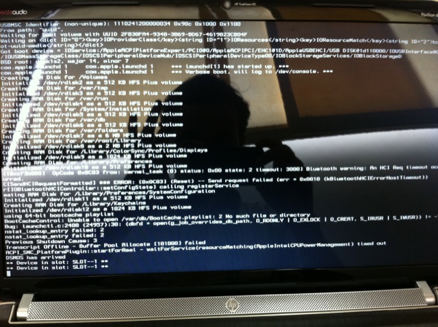

aramakau Posted January 11, 2012 Author Share Posted January 11, 2012 Bom dia, Fiz todos os procedimentos usando USB, e na hora de dar o boot para instalar aparece esse erro... substitui o kernel pelo indicado. abraço. Link to comment https://www.insanelymac.com/forum/topic/274443-help-instala%C3%A7%C3%A3o-do-lion-em-hp-pavilion-dv6-6047cl/#findComment-1785208 Share on other sites More sharing options...

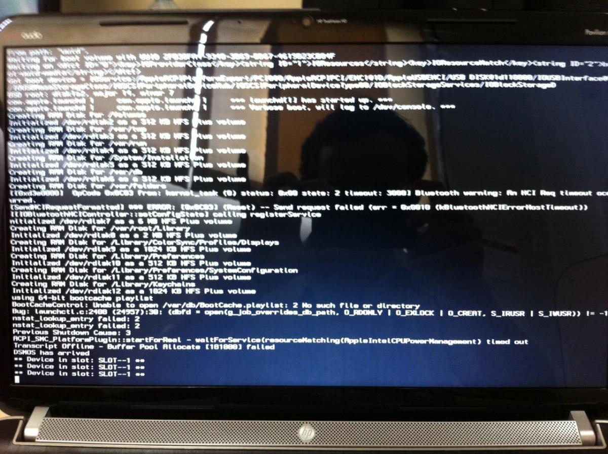

aramakau Posted January 11, 2012 Author Share Posted January 11, 2012 Apaguei os arquivos, mas ainda continua com erro, segue tela em anexo... Link to comment https://www.insanelymac.com/forum/topic/274443-help-instala%C3%A7%C3%A3o-do-lion-em-hp-pavilion-dv6-6047cl/#findComment-1785292 Share on other sites More sharing options...
artur_pt Posted January 11, 2012 Share Posted January 11, 2012 olá tenta o boot - npci=0x2000 Link to comment https://www.insanelymac.com/forum/topic/274443-help-instala%C3%A7%C3%A3o-do-lion-em-hp-pavilion-dv6-6047cl/#findComment-1785309 Share on other sites More sharing options...

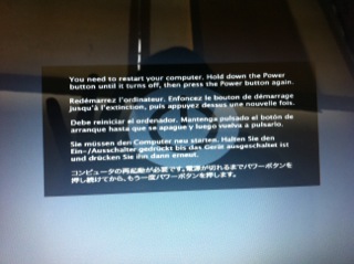

aramakau Posted January 11, 2012 Author Share Posted January 11, 2012 ainda não foi dessa vez...rsrs segue tela Link to comment https://www.insanelymac.com/forum/topic/274443-help-instala%C3%A7%C3%A3o-do-lion-em-hp-pavilion-dv6-6047cl/#findComment-1785332 Share on other sites More sharing options...
artur_pt Posted January 11, 2012 Share Posted January 11, 2012 olá boa noite tenta os varios comandos + este PCIRoot=1 ou 0 bom hack Link to comment https://www.insanelymac.com/forum/topic/274443-help-instala%C3%A7%C3%A3o-do-lion-em-hp-pavilion-dv6-6047cl/#findComment-1785422 Share on other sites More sharing options...

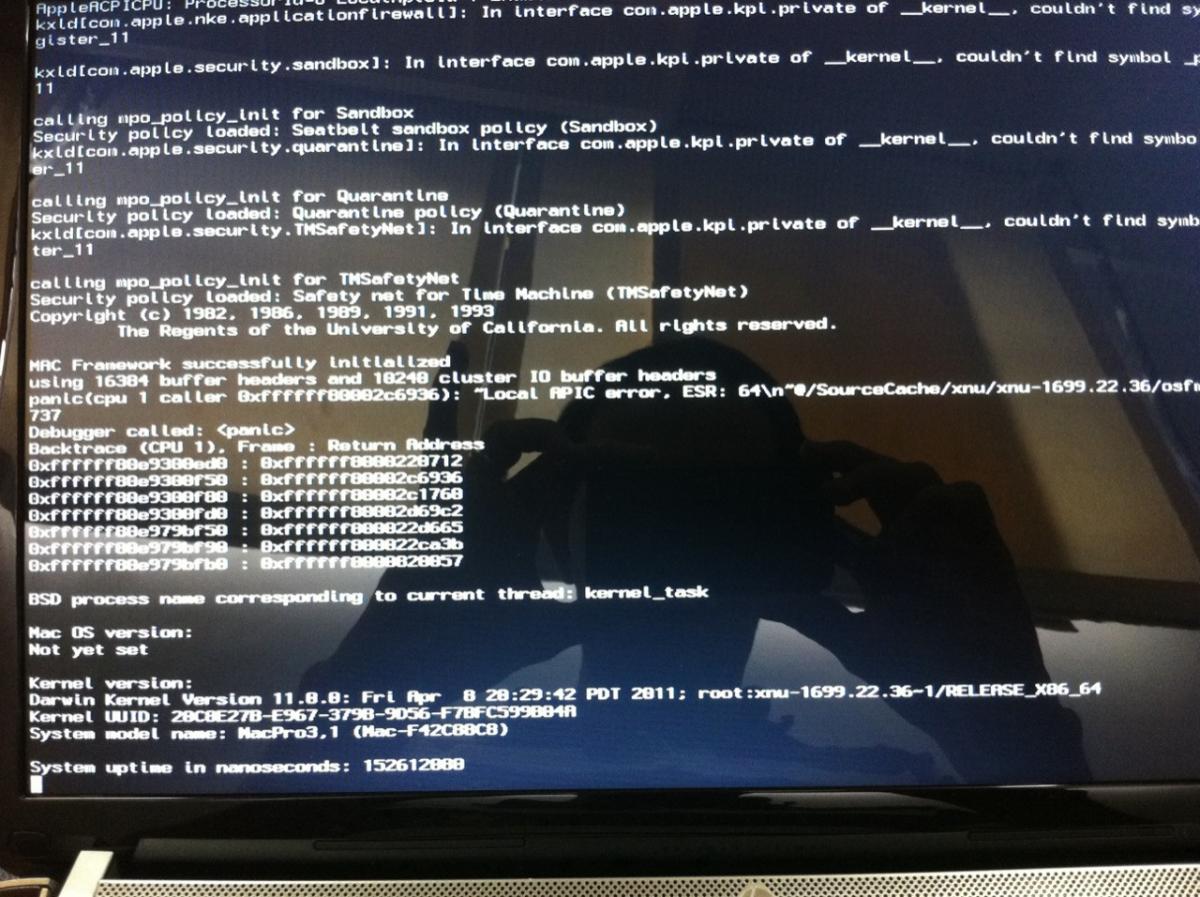

aramakau Posted January 12, 2012 Author Share Posted January 12, 2012 Boa Tarde, Fiz um boot usando o HackBoot, e apareceu um erro diferente. Fiz um boot agora usando o google Mac OS X 10.7 Lion bootable DVD for Intel PC Apareceu esse erro Link to comment https://www.insanelymac.com/forum/topic/274443-help-instala%C3%A7%C3%A3o-do-lion-em-hp-pavilion-dv6-6047cl/#findComment-1785686 Share on other sites More sharing options...

aramakau Posted January 13, 2012 Author Share Posted January 13, 2012 Boa Tarde, Estou com um erro diferente no momento que faço o boot, still waiting for root device Como faço pra resolver esse erro Abraço Link to comment https://www.insanelymac.com/forum/topic/274443-help-instala%C3%A7%C3%A3o-do-lion-em-hp-pavilion-dv6-6047cl/#findComment-1785955 Share on other sites More sharing options...
artur_pt Posted January 13, 2012 Share Posted January 13, 2012 olá tens na bios o hd em ahci ? Link to comment https://www.insanelymac.com/forum/topic/274443-help-instala%C3%A7%C3%A3o-do-lion-em-hp-pavilion-dv6-6047cl/#findComment-1785993 Share on other sites More sharing options...

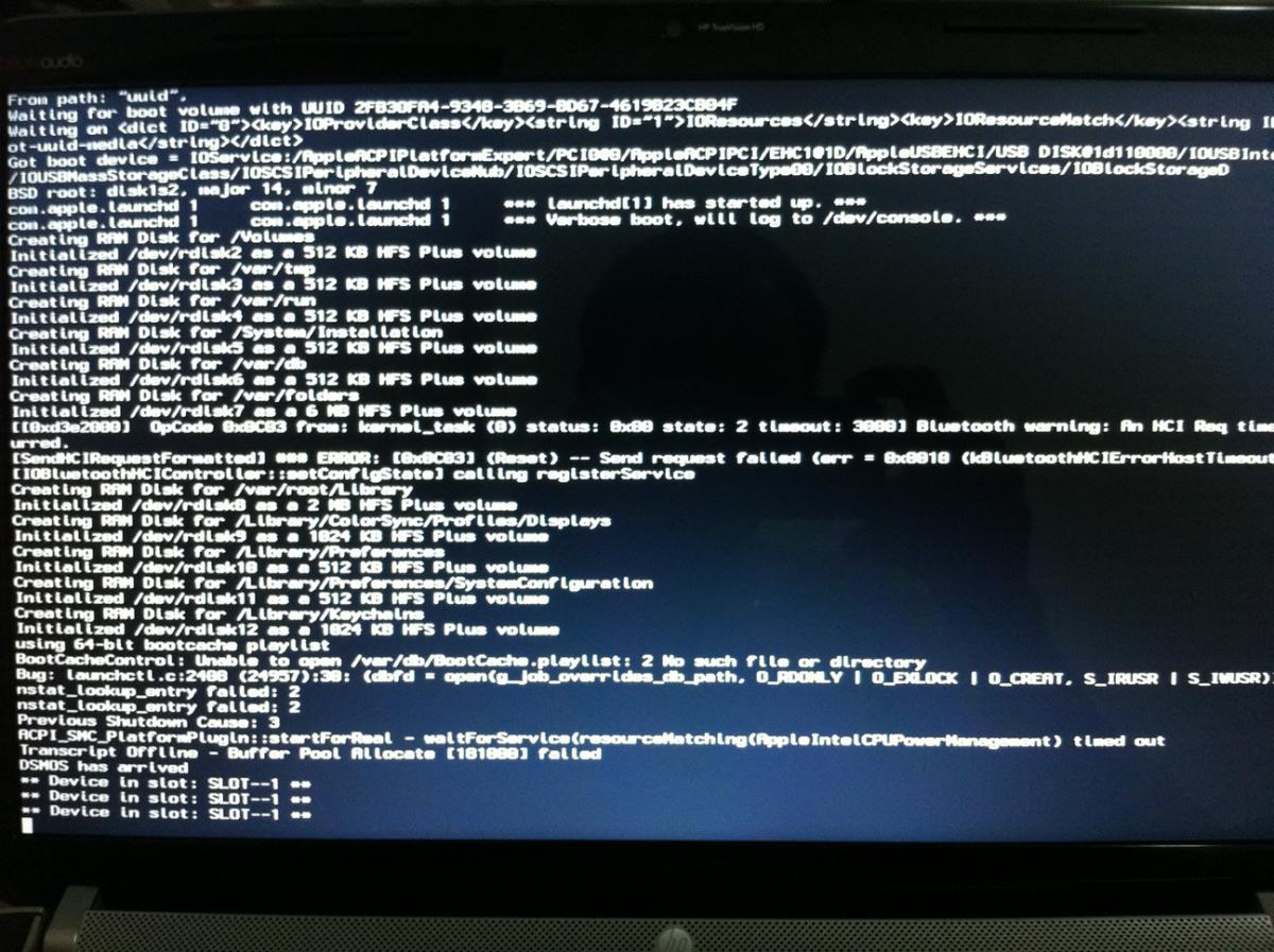

aramakau Posted January 13, 2012 Author Share Posted January 13, 2012 Boa Noite, Consegui instalar, mas na hora do boot aparece essa mensagem no final, System uptime in nanoseconds: 766158270 Abraço Link to comment https://www.insanelymac.com/forum/topic/274443-help-instala%C3%A7%C3%A3o-do-lion-em-hp-pavilion-dv6-6047cl/#findComment-1786005 Share on other sites More sharing options...
artur_pt Posted January 13, 2012 Share Posted January 13, 2012 olá boa noite faz um pequeno relato do k usaste para instalar e de como estás a fazer o boot e do k já instalaste ? se é k instalaste alguma coisa bom hack Link to comment https://www.insanelymac.com/forum/topic/274443-help-instala%C3%A7%C3%A3o-do-lion-em-hp-pavilion-dv6-6047cl/#findComment-1786010 Share on other sites More sharing options...
aramakau Posted January 13, 2012 Author Share Posted January 13, 2012 Olá boa noite Encontrei uma nova distribuição no fórum DV6-6090xx Mac OS X Lion Install Disc Fiz o boot normal e instalei, só que na hora de inicializar aparece a mensagem que Te mandei., não consegui instalar Nd. Abraço Link to comment https://www.insanelymac.com/forum/topic/274443-help-instala%C3%A7%C3%A3o-do-lion-em-hp-pavilion-dv6-6047cl/#findComment-1786017 Share on other sites More sharing options...
aramakau Posted January 14, 2012 Author Share Posted January 14, 2012 Consegui entrar no sistema digitando 'cpus=1' Link to comment https://www.insanelymac.com/forum/topic/274443-help-instala%C3%A7%C3%A3o-do-lion-em-hp-pavilion-dv6-6047cl/#findComment-1786041 Share on other sites More sharing options...
