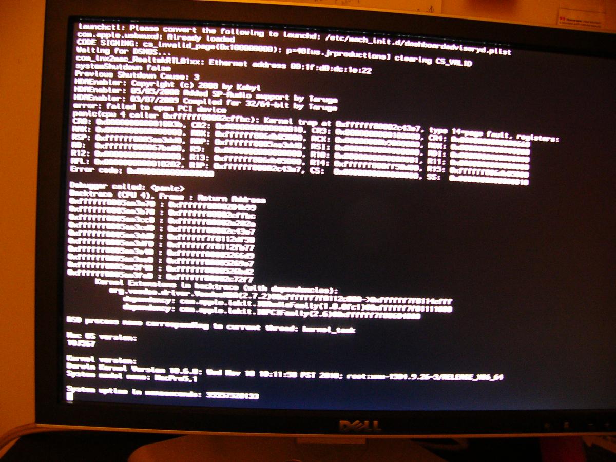

ZoroLives Posted January 27, 2012 Author Share Posted January 27, 2012 Thanks, I downloaded that and tried it, but no luck. I can get to 10.6.6, but without ethernet. THen when I try upgrading to 10.6.8, I get the (attached) screen. I am at wits end here, posting to an old thread to see if I Can get others comments as well. Ongoing thanks for all you are doing to help, appreciate it (really). I need to know what should and should not be in the extras folder for this board. I need to know what should be in the SIMBIOS list for this setup. I searched for ethernet strings and I downloaded a fix for that someone had made available, but that made no difference so far. It was working but now something is really off, and I am unable to work anymore. I MUST get this fixed. Right now I am thinking of reinstalling 10.6.0, erasing ALL itens in Extras and in Sys/Lib/Extensions, then reinstalling again and let the installer do it all the way it is supposed to me done. I would like some feedback however before taking that step. Link to comment Share on other sites More sharing options...
PookyMacMan Posted January 27, 2012 Share Posted January 27, 2012 At the boot prompt, type npci=0x2000 if that doesn't work, try npci=0x3000 if that doesn't work, Ii'll get you a 10.6.8 kernel. Link to comment Share on other sites More sharing options...

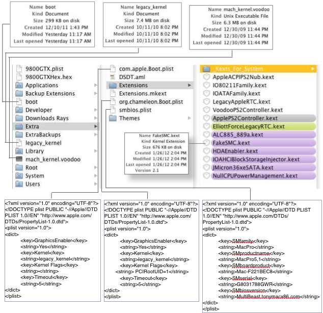

PookyMacMan Posted January 31, 2012 Share Posted January 31, 2012 Maybe this can help you out. 1) The Extra folder is used by the Chameleon bootloader for a. the Chameleon config file (com.apple.boot.plist or org.chameleon.boot.plist), b. a patched DSDT, c. video card replacement ROMs, and d. other extensions (the folder /Extra/Extensions). If you're wondering, "Why the /Extra/Extensions when there is /System/Library/Extensions?" the reason is if you use replacement kexts (like a different version of IO80211Family.kext for WiFi) the kext will not get removed by system updates (10.6.3 to 10.6.8, for eample). 2) The kernel depends on your CPU. If you have an Intel Core (Core 2 Duo, Core i5, etc.) or an Intel Xeon CPU, you will be using Apple's kernel (often called the vanilla kernel; it is mach_kernel). This kernel is already installed by default. If you have a different CPU (such as a Pentium D or an AMD), or your SL version is too old for your CPU (for example, i5's and i7's were not supported until 10.6.2), or you are just having issues, you will be using a different kernel. 3) To get the most help, you will have to be as specific as you possibly can and include screenshots of panics or other issues. It has not been difficult helping you. I can totally sympathize with not knowing what is going on. Trust me, I had so many similar issues! Since I started hackintoshing last June, I've had about 35 installations (at least that many). It can be quite difficult, but being perseverant will get you through (which is exactly what you're doing right now). Link to comment Share on other sites More sharing options...
ZoroLives Posted February 1, 2012 Author Share Posted February 1, 2012 OK, thanks for your patience. I had to take a music break, now I am back. Wouldn't it be nice if I could get this thing done and get back online tonight? Keeping it positive!!! Thanks for explaining what vanilla meant. I was online with someone with this board and he commented that vanilla was all he ever used with this board so I will stop worrying about voodoo kernels et al. Although I am still thinking my System/Library/Extensions Folder may have mixed up files in it. I have reinstalled and upgraded so many times now, 10.6.0 turns into 10.6.6 turns into 10.6.8 turns once again into 10.6.0, and repeat... I wonder how many extensions versions have been left behind and how many are really needed? One thing that worries me is that I have both an AppleHDA.kext and a voodooHDA.kext. Wouldn't that create conflict? remember I am booting in safe mode so that is still conflict going on. I also still cannot get ethernet/Internet working and that is so frustrating as I cant do any real work until I can get back online. If you need a fresh screen shot then I will reboot again and take a picture of what I get. I hate the thought of being locked out again but safe booting worked this time, it should work the next time as well. If your are there now, can you tell me about the HDA with Voodoo and apple? I also think I was getting an IOFamily dependency conflict? THanks. Screen Shots: OK, guess I am still going through it tonight, sigh. I did my best to clear dulicates, etc. Now here is the current screen shot where it KPs. Looks like the voodooHDA I was mentioning. I guess if it already has AppleHDA it doent like voodooHDA? I will see if I can reboot safe and change that. Screen Shots: OK, guess I am still going through it tonight, sigh. I did my best to clear dulicates, etc. Now here is the current screen shot where it KPs. Looks like the voodooHDA I was mentioning. I guess if it already has AppleHDA it doent like voodooHDA? I will see if I can reboot safe and change that. ADDED: Sorry the pics are so blurry. The two are the same but the second is worse focused, not better. The good news, I removed VoodooHDA and it booted. Unfortunately there is no internet STILL!!!!! And, sound is grayed out. Sound I can live with for now, internet, Bad news, must get fixed. I am running the 10.6.8 update right now. Since it is booting again, might as well update if I can. ADDED: I am beat, will revisit this in the morning. I can boot again reliably, so that is great. But there is still no internet and there is still no sound. I tried the old reatekR1000SL.kext and m=a more modern RTL81xx.kext but nothing seems to work. Any ideas? I know it works because at one point, It did work. Sound is a mystery too. Used to work great, now nothing, grayed out. Link to comment Share on other sites More sharing options...
ZoroLives Posted February 1, 2012 Author Share Posted February 1, 2012 I found a discussion here: Topic Bug? Some kexts only load properly from /System/Library/Extensions/ It seems I am not crazy after all (that's a relief) ;-) And here is all you ever wanted to know about KEXTS (but were afraid to ask) ;-) For instance: This has many implications for kexts, such as ... the ability to load during early boot. Kexts have strict security and location requirements that you need to follow for your kext to workAt this point I have done all I can do to look up missing extensions but just in case my stock system/lib/ext folder is messed up, I installed the 10.6.0 fresh to my RAID drive. I dont plan to boot on that drive as I dont remember how to do the setup for that, still have the extra folders and it used to be I would set a boot flag to the Raid drive from the Raid small Boot drive - better to walk before I can run in this case however ... Anyway, I did that so that now I will take this booted system also down to 10.6.0, hopefully again boot to it, then move my fresh Extensions folder from Raid to Gold Drive and continue updates back to 10.6.8. That could and should eliminate the problems I am having getting sound and ethernet working again on this board. Or at least, then I will know that what Apple things should be in the Sys/Lib/Ext folder will really be in there and when I have to replace a version after that then at least I know everything else is still where it should be (right now I dont). Link to comment Share on other sites More sharing options...
PookyMacMan Posted February 1, 2012 Share Posted February 1, 2012 I love that Apple article - so very helpful. For your Internet, there is hope. You are talking about Ethernet, right? If you give me your vendor and device IDs I can get you a new kext. Download this UNIX utility, drag it onto your Desktop, and type: sudo cp ~Desktop/lspci /usr/bin/lspci [now you will enter your password; you don't see the password, but just type it and continue] lspci -nn and copy and past the output into a document and upload it here. To fix the /Extra/Extensions issue, most likely all you need to do is rebuild the caches when you add a new kext. This can be done very easily by running Kext Utility after dragging the kext into /Extra/Extensions. Everything will be done automatically. Link to comment Share on other sites More sharing options...

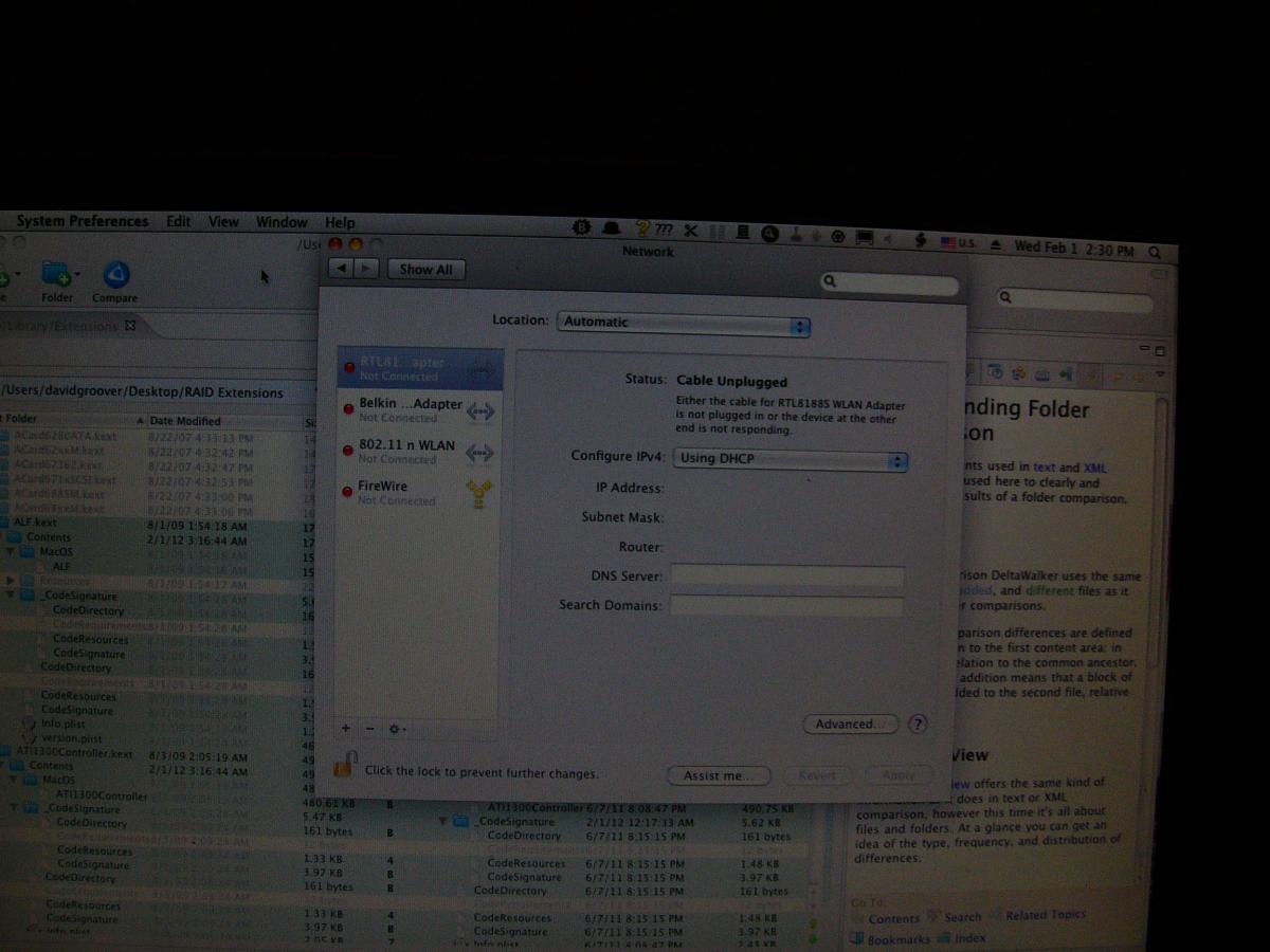

PookyMacMan Posted February 1, 2012 Share Posted February 1, 2012 Wait...you can see your Ethernet in System Profiler??? That means your Internet problem is not kext related; if it were kext related your Ethernet would not show up at all. Go to System Preferences and click the Network pane and see what shows up. Take a pic and upload it here. Link to comment Share on other sites More sharing options...
ZoroLives Posted February 1, 2012 Author Share Posted February 1, 2012 Yes, there is a blinking yellow light at the jack on this mobo, should be steady green. ADDED: I already renewed my lease, which is the only way I know to free this pref pane. Once in all this long overhaul I did stumble on getting it to 10.6.8 like it is now and the ethernet just worked. So I wasn't thinking anything about not having it set correctly. I am certainly going to try whatever you can suggest. THanks Link to comment Share on other sites More sharing options...
ZoroLives Posted February 1, 2012 Author Share Posted February 1, 2012 Im IN !!!!!! HALLELUJAH!! You were right, the ethernet was installed properly, but the Network settings needed a reset. Yes, it just worked before, and yes, it was set to automatic for network selection so I thought it was good to go. But nooooooo, I had to select a new location and THEN renew the DHCP lease and .. IT WORKS again. OK not 100% better but sure happy I am back online. My Insanely mac page is telling me I do not have javascript enables, never saw that before, wonder what made that go away? And, sound is still grayed out. I do use tutorials and getting sound working would be pretty important. Much much thanks and heres hoping the sound will go as easy as the ethernet. Link to comment Share on other sites More sharing options...
