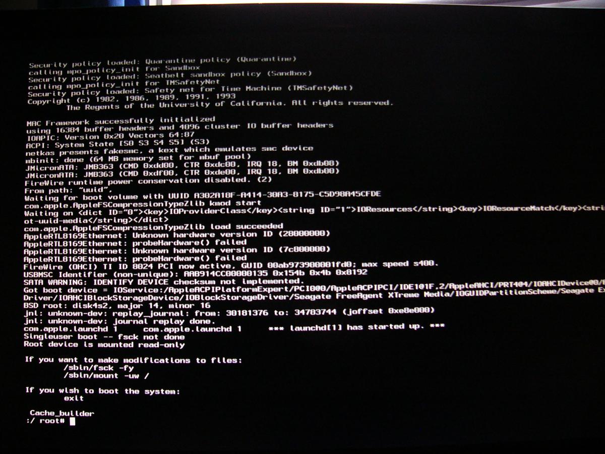

Gringo Vermelho Posted December 31, 2011 Share Posted December 31, 2011 "refused to load this or that" can happen if you're trying to boot a 10.6 DVD with a boot CD that was made for 10.5. If you can still get in via single user mode then it is definitely fixable. I can boot in single user mode. I have done that and run sbin.fsck -fy a few times and it always finds and corrects a directory count. THen I read the man pages for anything I think could help to change the boot volume or finish booting Type exit to continue booting. Link to comment Share on other sites More sharing options...

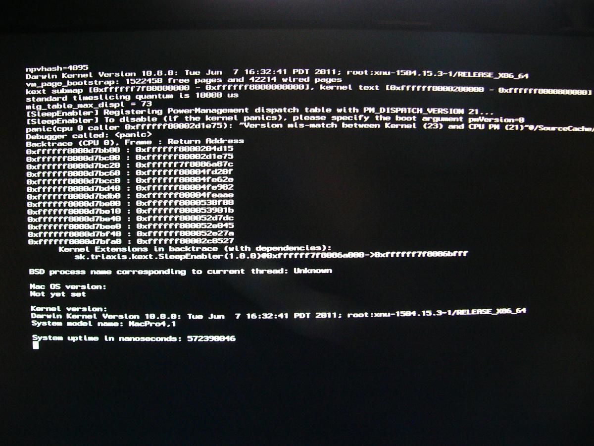

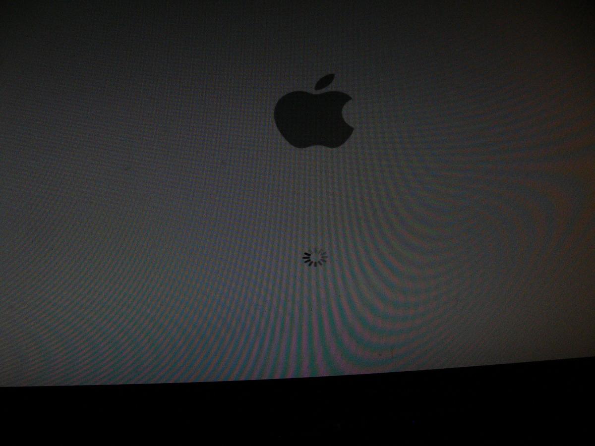

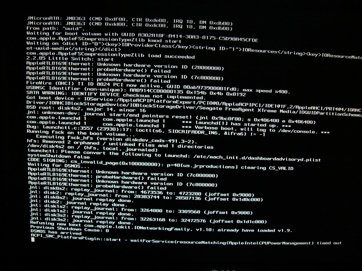

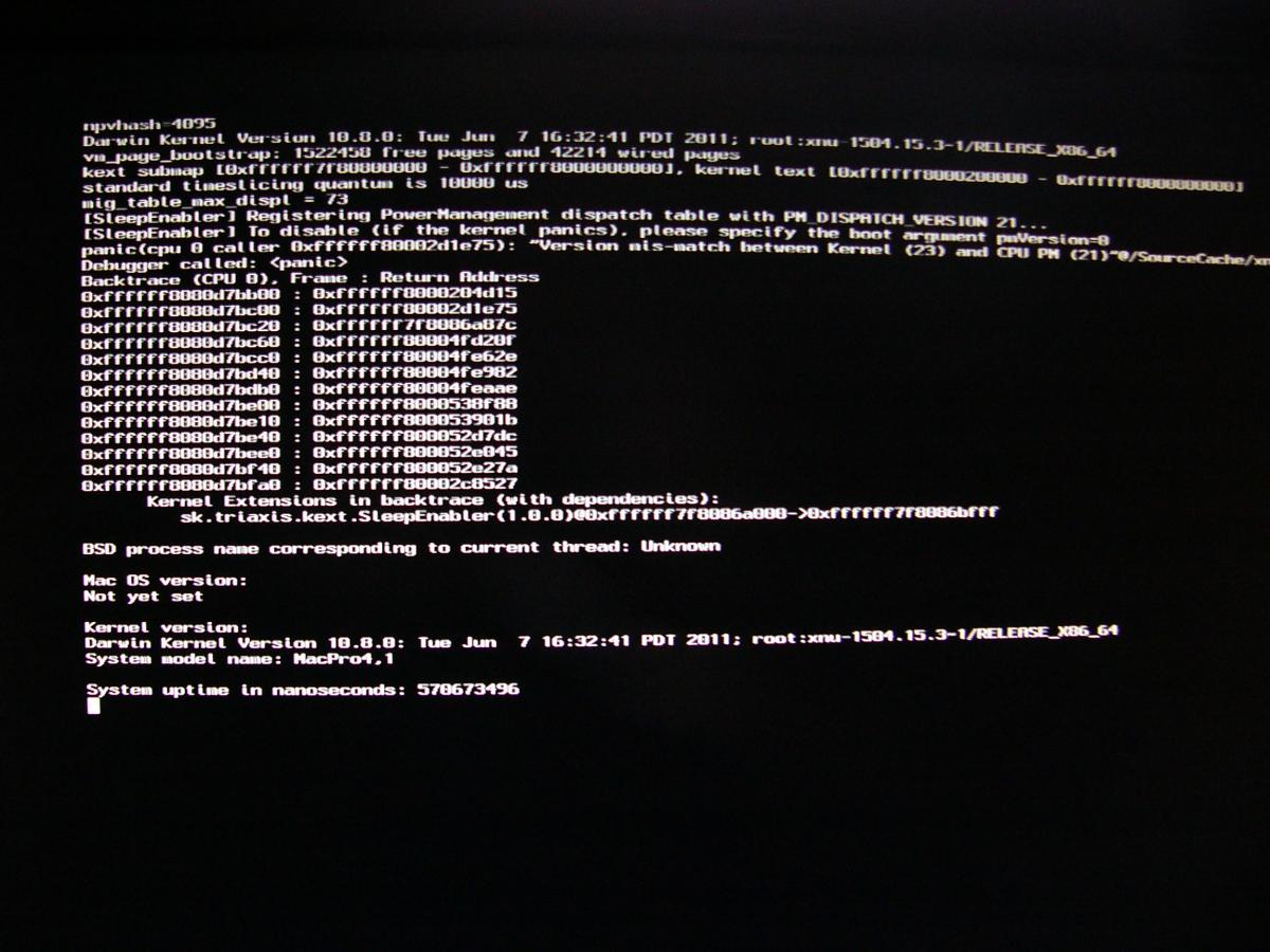

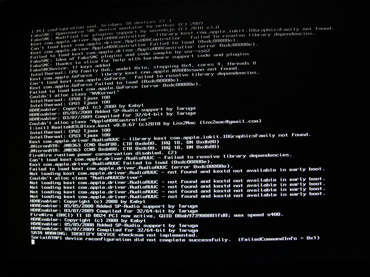

ZoroLives Posted January 2, 2012 Author Share Posted January 2, 2012 OK, here are some screen shots. The one with the white screen , apple logo and spinning cursor is normal in the boot sequence, except that this one will stay running all night (tried it). I guess after I get this all put together again, I had better make sure my emergency boot disks stay matched to my current system versions? I am encouraged that I can get into one of my drives (seagate) in Single User. Hopefully with that door open (and some clear instructions) I can get this back together again. Or, knowing I can look at my Seagate disk off my powerbook in 10.4 - well .. this little machine seems to me having some hard luck. The CD drive just conked out, now it seemed to take a long while to boot this morning, had to take out the battery a half dozen times before it would boot. First things first, lets get the main system back up and running. Thanks very much for all the help. ADDED: On the fourth shot (SeagateVerbose) the far right side is cut off on the last line. Last thing that line says is timed out. What I was doing before I could not boot: I have been having trouble with my dvd drive since going to 10.6.8 and I was trying some way of resetting the drive. I was trying the TonyMac [url="http://www.insanelymac.com/forum/topic/279450-why-insanelymac-does-not-support-tonymacx86/"]#####[/url] and I started putting in optional drivers. I did not realize that I might have put in too many drivers or the wrong kind - I assume this is what caused the problems. Why the other drive got sideways I am less sure? When I run DiskWarrior I have to reinstall the boot blocks and the DD script I have been using for a long while now only shows a couple of options where it used to show a half dozen chameleon options. I have been paring down my drives, eliminating a huge number of duplicate files, trying to get everything in order. I probably ran DW from a booted but already changed after reboot main drive and now, I am here .... (hope all that info helps) Link to comment Share on other sites More sharing options...
PookyMacMan Posted January 2, 2012 Share Posted January 2, 2012 For the KPs, the problem kext is the SleepEnabler. Do this: when you boot, type -s pmVersion=0 This will boot you into single user mode and disable the SleepEnabler. Now do this: /sbin/mount -uw / rm -R /Extra/Extensions/SleepEnabler.kext exit That should fix your booting problems. With pic 4, it looks like fakeSMC isn't loading properly. Link to comment Share on other sites More sharing options...

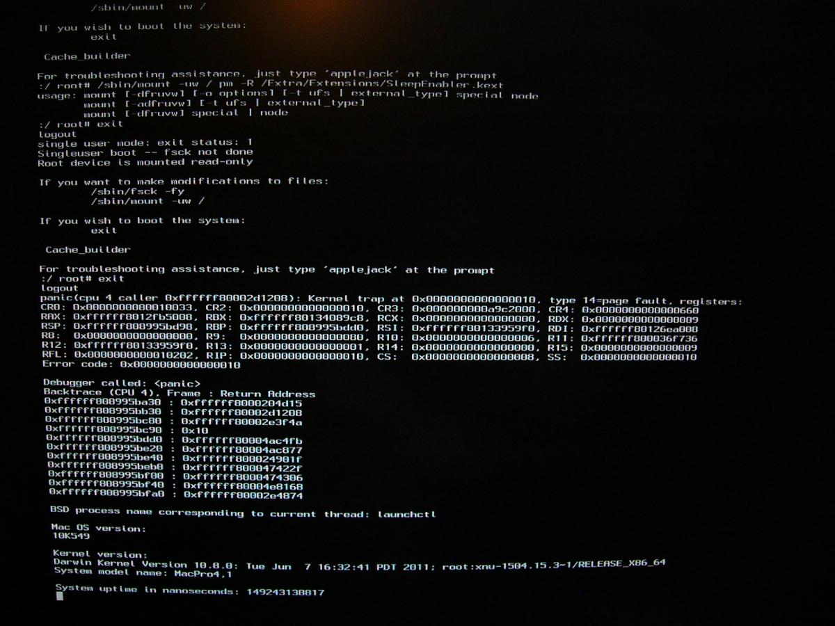

ZoroLives Posted January 4, 2012 Author Share Posted January 4, 2012 OK, I have had some successes, and some ,,, not so much. I can get into my main drive now, but it isn't exactly working as it should... THE screen shot shows what happens when I run the terminal commands as you suggested. It seems that it is not actually removing the files. More than that, after I booted I went through Finder to kill that darned sleep enabler file, but is seems it is still there??? How I can boot. I cannot not boot through my main drive startup using your -s method or any other way - "IF" I first boot into that main drive. I can boot directly to that other drive, the Seagate drive and when I have the option to boot verbose etc and I change over to the main drive, and use hte -s suggestion you gave me, then exit after arriving at single boot screen, I can get in that way. I am just glad I can get in some way. Unfortunately I still cannot boot into the Seagate drive or boot normally into my main drive. The DD script is not helping on the Seagate like it used to do and it has fewer options. The TonyMac hack only works on the drive it is booted to so I can't use that one either. I am open to further ideas. And ongoing thanks for the help. Link to comment Share on other sites More sharing options...
Gringo Vermelho Posted January 4, 2012 Share Posted January 4, 2012 It didn't work because you aren't paying attention to the directions you were given, or what's going on on the monitor in front of you. You typed both commands on one line, typed pm instead of rm, and because you can't do that you were then shown usage instructions for the mount command, which you ignored and typed exit. It's good practice to run fsck before mounting (exactly as instructed at the prompt). Link to comment Share on other sites More sharing options...
PookyMacMan Posted January 4, 2012 Share Posted January 4, 2012 Definitely removal of the SleepEnabler will eliminate the panic. If you want, you can do it in Finder, too, (using one of your CDs) if you're not comfortable with Terminal (or single-user). Actually, I have a 10.6.8 SleepEnabler; I can upload that if you like. Link to comment Share on other sites More sharing options...

PookyMacMan Posted January 11, 2012 Share Posted January 11, 2012 Boy, you really messed up your installation. Looks like something I'd do. There are some kexts that are not loading properly, including your HDD controller. The thing I'm confused by is your bootable drives. If you look at post number 6, you uploaded 3 verbose shots. The first two were kernel panics that, if you look at the "Kexts in backtrace" section, is SleepEnabler.kext. Shot 4 was of a different drive altogether; that one was not SleepEnabler related. Can you please specify 1) what drives you have, 2) which one you've been working with, and 3) which one is most important? Also, what are "hackinstaller scripts"? I don't understand what you mean by that. Personally, this last drive you've been working with looks like more trouble than it's worth. If I were you, I would pull any data off you needed, make the drive to your storage lot, and reinstall. It will save you a lot more time than trying to fix this particular installation. Link to comment Share on other sites More sharing options...
