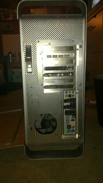

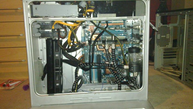

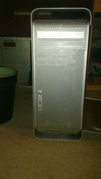

Foxic Posted November 17, 2011 Share Posted November 17, 2011 Welcome to the forum. First of all I would not recommend using a hackintosh for your server, hacks often experience down time (due to system updates). As a workstation, fine, but as a server I think you'd be better off using a mac mini, unless you never plan on updating your server once it's actually up and running. I did a g5 build at the beginning of the year...absolutely loved every second of it (car was finished so needed something to build). Its not all that hard really, the hardest bit I found was getting hold of a removable lian-li motherboard tray, once I had that it took me about 3 evenings and a saturday to get everything in. That's using a full ATX mobo, nvidia 480GTX, 280mm radiator (water cooled btw), 2 HDDs, so not a wimpy little micro ATX build, and it all fits with room to spare..ish. Best place to start is here: http://www.kustompcs.co.uk/acatalog/info_2012.html For the case, check ebay, be prepared to pay up to £70 + postage for a broken g5, you will be able to re-coup some if not all of the money by selling the components on ebay. Get a complete/'hdds removed' g5 as you can use all the interior metalwork and you will want things like the bolts in the bottom of the dvd drive so you can mount yours properly (and easily) and get the draw cover opening; the metal tray on which to mount said dvd drive etc For the front panel you will need to make up a small wiring loom to the power, led, USB, FireWire and audio headers on your motherboard. All of the connectors and crimps are available on ebay, I can send you my wiring diagrams but I'll have to scan them in, also be aware that front panel connections differ greatly between models. When choosing hardware (mobo/cpu etc) choose parts that are commonly used by the community here, that way you'll have other people to help you through the problems. I hope this helps Quote Link to comment https://www.insanelymac.com/forum/topic/272297-hello-fellow-geeks/#findComment-1771468 Share on other sites More sharing options...
