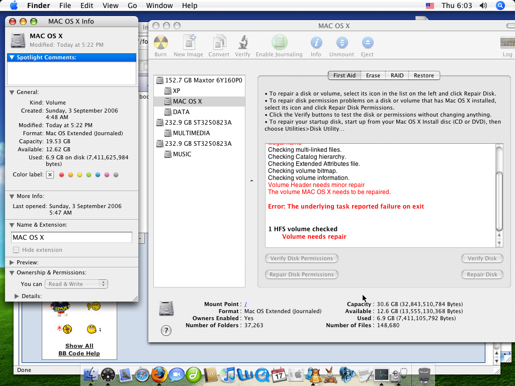

muitommy Posted September 14, 2006 Author Share Posted September 14, 2006 i can boot in it , but i found a problems = = can i fix this ?? Link to comment https://www.insanelymac.com/forum/topic/27225-how-can-i-resize-my-osx86-partition/#findComment-188492 Share on other sites More sharing options...
Rammjet Posted September 14, 2006 Share Posted September 14, 2006 can i fix this ?? Boot your install DVD, go to Utilities menu -> Disk Utility, select your OSX partition and select Repair. Link to comment https://www.insanelymac.com/forum/topic/27225-how-can-i-resize-my-osx86-partition/#findComment-188548 Share on other sites More sharing options...
