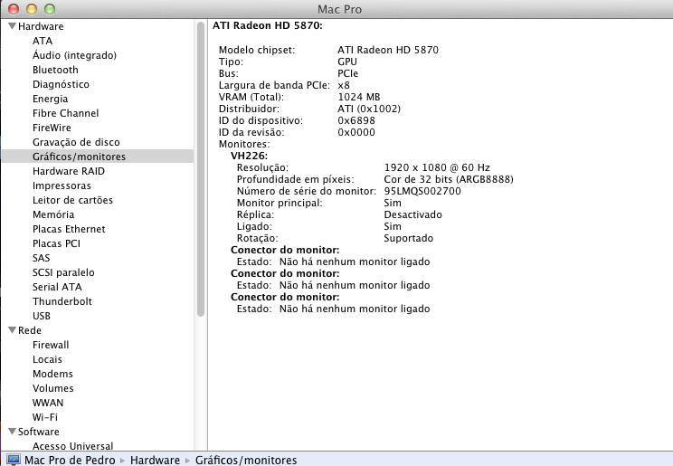

xympa Posted October 21, 2011 Share Posted October 21, 2011 My HD 5870 is only showing 8x PCiE, and it's connected to a 16x slot, It's also showing some lag while browsing inside steam. I haven't played any games yet, so i can't speak of the acceleration... Do I need a special Kext? I was under the impression that these Atis were natively supported since 10.6.5... Link to comment https://www.insanelymac.com/forum/topic/270759-isnt-the-5870-suposed-to-be-supported-out-of-the-box/ Share on other sites More sharing options...

Donw35 Posted October 22, 2011 Share Posted October 22, 2011 its either your bios settings or your DSDT, mine shows x16, what version of Chameleon are you using ? Link to comment https://www.insanelymac.com/forum/topic/270759-isnt-the-5870-suposed-to-be-supported-out-of-the-box/#findComment-1763353 Share on other sites More sharing options...
xympa Posted October 22, 2011 Author Share Posted October 22, 2011 its either your bios settings or your DSDT, mine shows x16, what version of Chameleon are you using ? I used this tutorial, I'm not sure what version of chameleon I'm using, but I'll let you know as soon as get a chance to reboot. UPDATE: I'm using Chameleon 2.1 r1627 UPDATE 2: Nevermind, i guess my mobo is going awire, I switched to the second pcie slot and it's working fine... Link to comment https://www.insanelymac.com/forum/topic/270759-isnt-the-5870-suposed-to-be-supported-out-of-the-box/#findComment-1763444 Share on other sites More sharing options...
