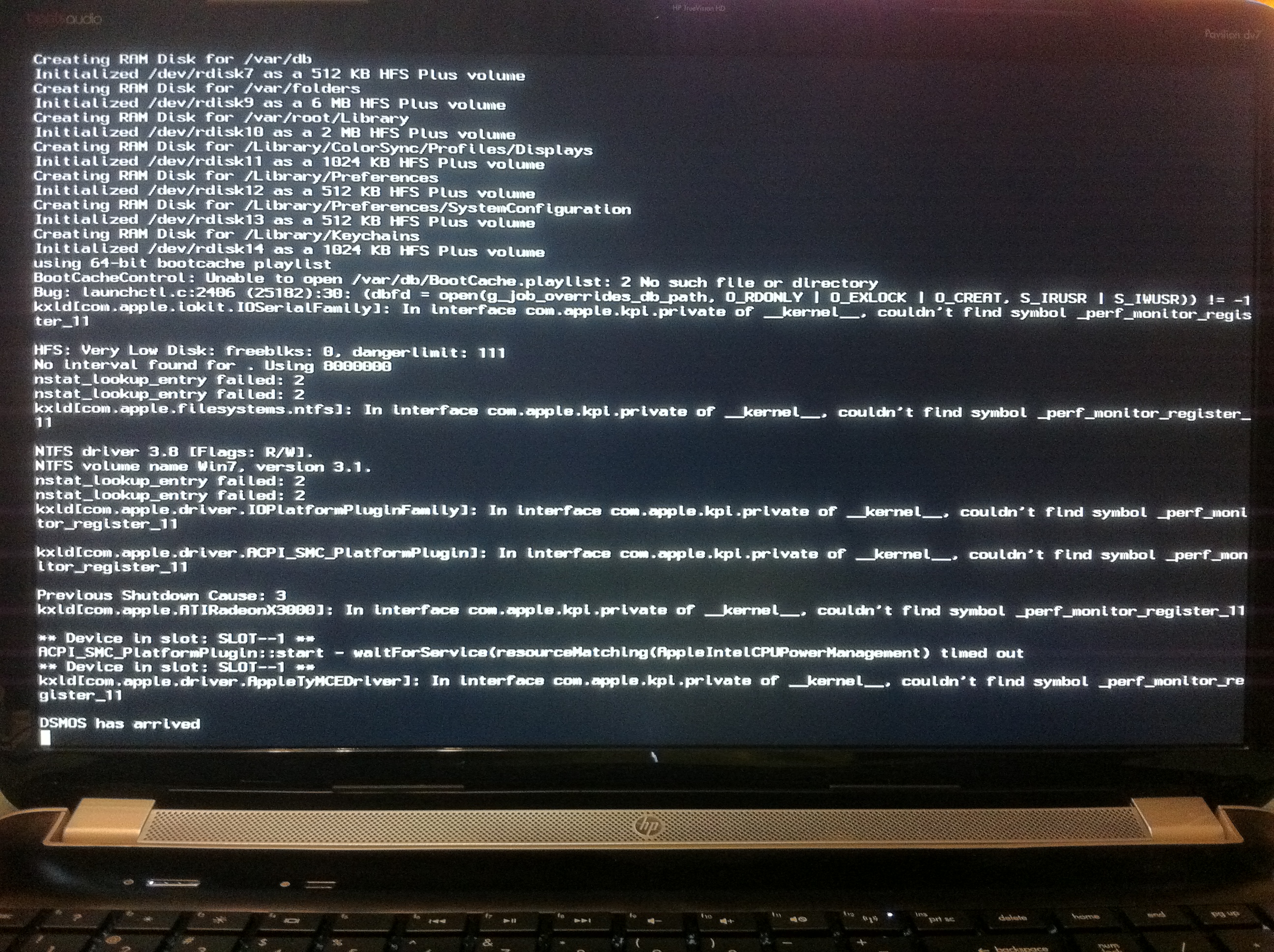

GDMorry Posted October 12, 2011 Author Share Posted October 12, 2011 I had no progress at all using mammoths "Cham" method as I could not find a suitable miif I subsequently used Maldons method and created a USB. Fixed com.apple.Boot.plist is depreciated error by simply renaming it to org.chameleon.boot.plist. Fixed mach_kernel error by copying mach_kernel to / of USB . Updated all in Extra Folder to MacBookPro8,1 / Sandy Bridge from maldons Extra_MacBookPro8_1.zip Booted from USB and attempted install with -v -x arch=x86_64 cpus=1 KP as attached. Oh and would a basic DSDT.aml with no patches and no errors (just a few warnings) be better to use than none at all? Link to comment https://www.insanelymac.com/forum/topic/269987-hp-dv7-6111tx-dsdt/#findComment-1758709 Share on other sites More sharing options...
GDMorry Posted October 12, 2011 Author Share Posted October 12, 2011 **Note** Extra SATA Drive & 4Gb ram stick removed =only one drive for mac os and one 4Gb stick ram. I removed the AppleIntelCPUPowerManagement.kext also AppleIntelCPUPowerManagementClient.kext and placed in IOAHCIBlockStorageInjector LegacyAHCI & NullCPUPowerManagement Also added <key>DSDT</key> <string>DSDT.aml</string> to org.chameleon.Boot.plist ... I got a LOT further but last thing I saw was something about waiting for DSMOS then the screen went blank .. yet machine is still powered not a reboot .. usb showed a little activity but all quite now no progress Link to comment https://www.insanelymac.com/forum/topic/269987-hp-dv7-6111tx-dsdt/#findComment-1758720 Share on other sites More sharing options...

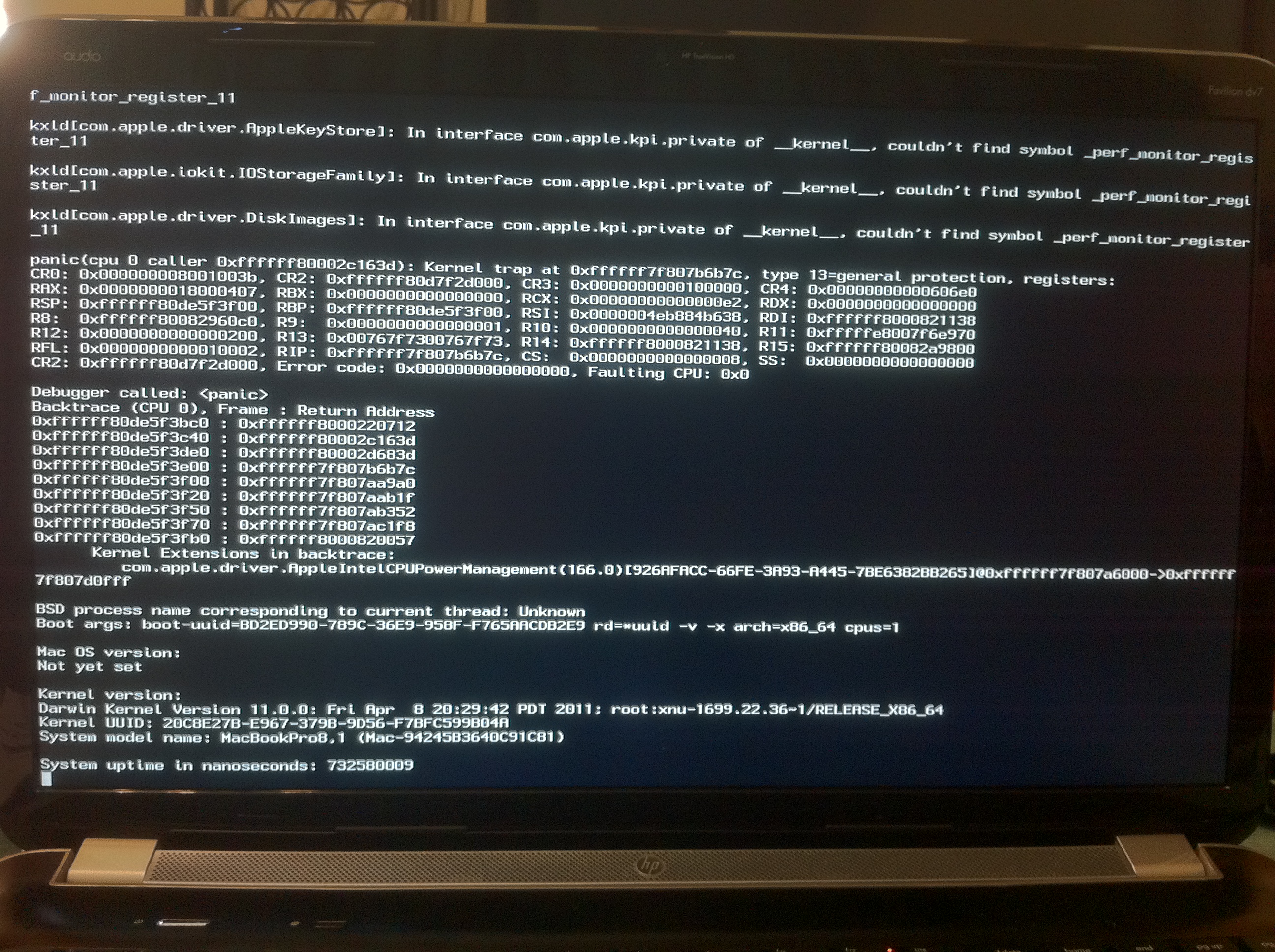

GDMorry Posted October 26, 2011 Author Share Posted October 26, 2011 Tried with Lion 10.7.2 & this is where I stalled = well at least I still have display Can anyone help with what this mean? Link to comment https://www.insanelymac.com/forum/topic/269987-hp-dv7-6111tx-dsdt/#findComment-1764809 Share on other sites More sharing options...
