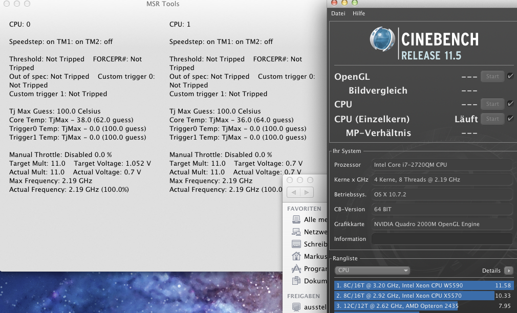

My CPU- Performance (i7-2720) is the main problem. Under Windows i get around 5,2 in Cinebench and in OS X only 4,2. Maybe a problem with Speedstep or Turboboost? I tried diffrent Benchmarks but nothing changed. In my BIOS-Settings everything is enabled for my CPU.

in the org.chameleon.boot.plist but i still get very low CPU-Benchmarks ...
