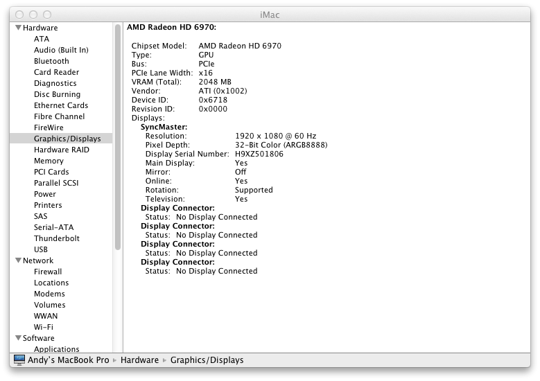

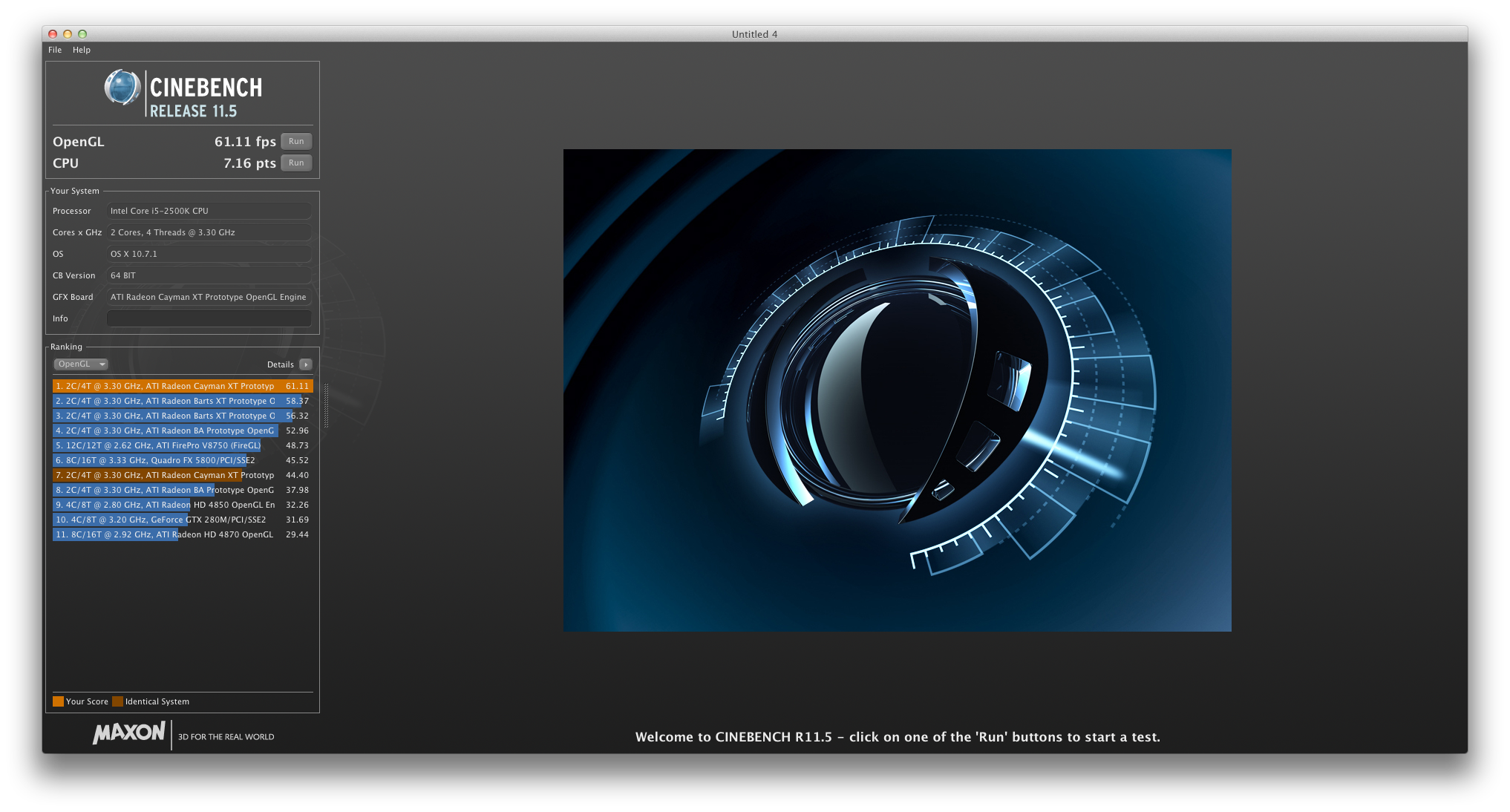

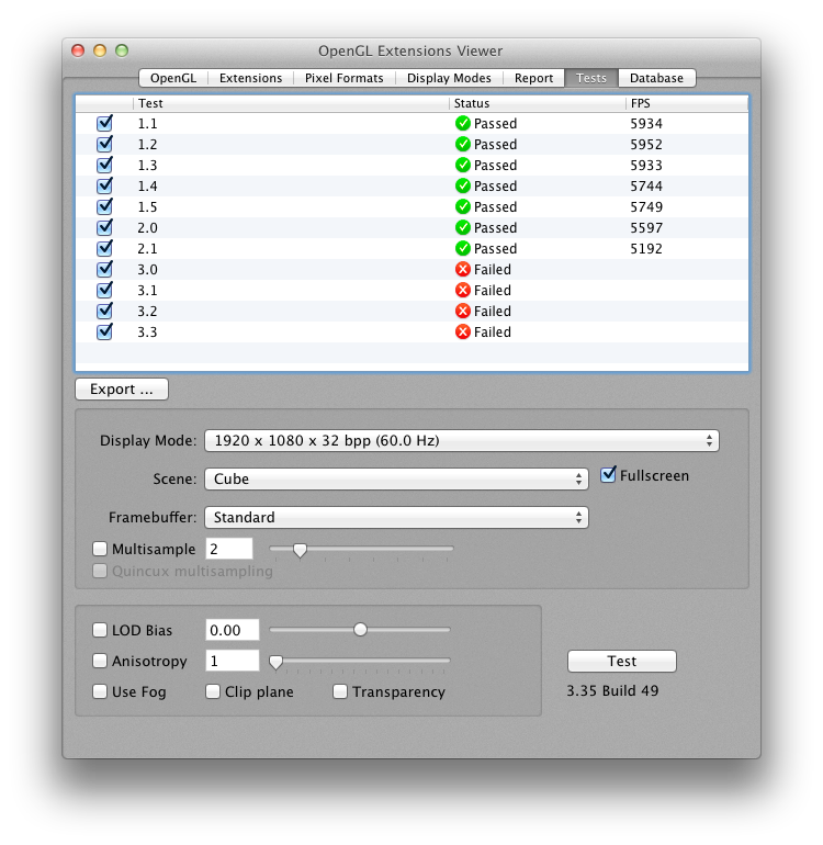

Regi Yassin Posted September 4, 2011 Share Posted September 4, 2011 can u post screenshots, benchmarks score, system profiler, Andy? thanks Link to comment https://www.insanelymac.com/forum/topic/267078-amd-hd6970-working-under-lion-courtesy-of-netkas/#findComment-1744024 Share on other sites More sharing options...
^Andy^ Posted September 4, 2011 Author Share Posted September 4, 2011 can u post screenshots, benchmarks score, system profiler, Andy?thanks Link to comment https://www.insanelymac.com/forum/topic/267078-amd-hd6970-working-under-lion-courtesy-of-netkas/#findComment-1744254 Share on other sites More sharing options...

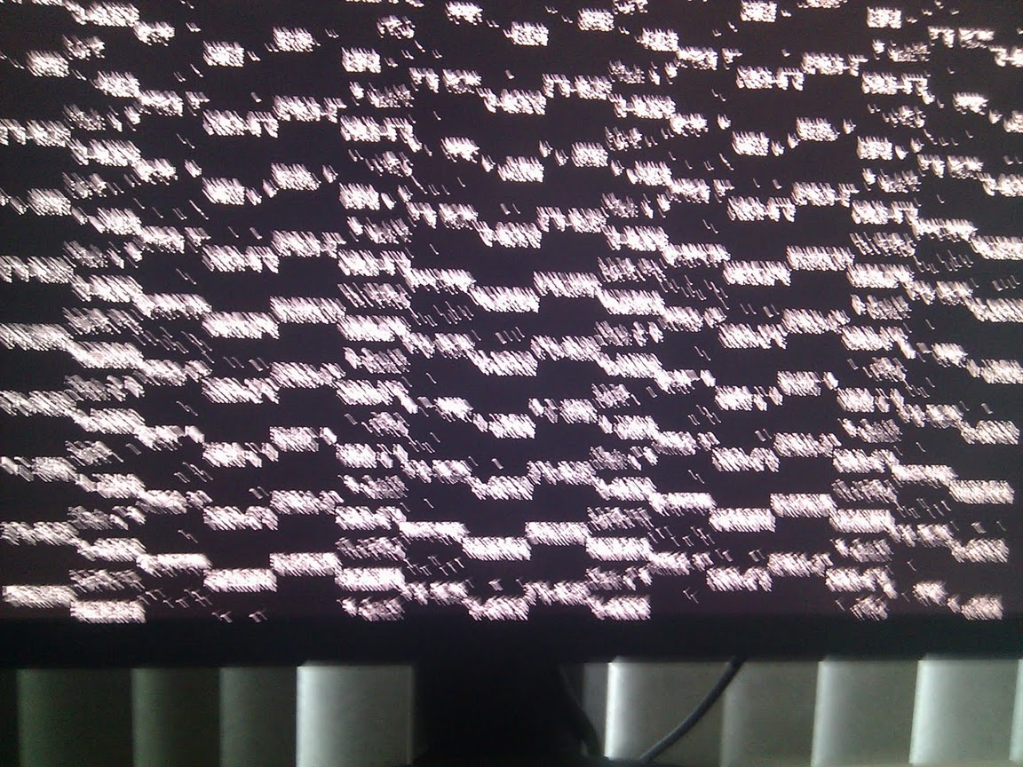

rabhw Posted September 8, 2011 Share Posted September 8, 2011 Really glad to see its working for most people, but I'm having an issue myself... I'm on a P8P67 Pro. I installed Lion using Andy's Guide + Packages. I have Chameleon 2.0 RC5 r1062 Andy Boot 5.0 installed to the system drive. After that, I installed the latest "Standard" package from this thread, and rebooted. Unfortunately I can't boot now. If I don't set -v, it gets stuck on a blank grey screen after the Apple logo + spinner disappear. If I set -v, then after going through the entire boot process, when the OSstarts the screen is corrupt (attached image). From this point on nothing happens. I've tried setting GraphicsEnabler to Yes and No from the boot flags in chameleon. I can boot with -x, and I can also boot if I delete the X3000 kext, obviously without acceleration though. This is on a system with two 6950's in Crossfire, but I've tried removing the second card and having only a single card in, the same corruption is present with -v on. I've also tried the top and bottom DVI ports on the single 6950, both have the same issue. Link to comment https://www.insanelymac.com/forum/topic/267078-amd-hd6970-working-under-lion-courtesy-of-netkas/#findComment-1746168 Share on other sites More sharing options...
netkas Posted September 9, 2011 Share Posted September 9, 2011 rabhw - http://forum.netkas.org/index.php/topic,11...04.html#msg6904 Link to comment https://www.insanelymac.com/forum/topic/267078-amd-hd6970-working-under-lion-courtesy-of-netkas/#findComment-1746325 Share on other sites More sharing options...
