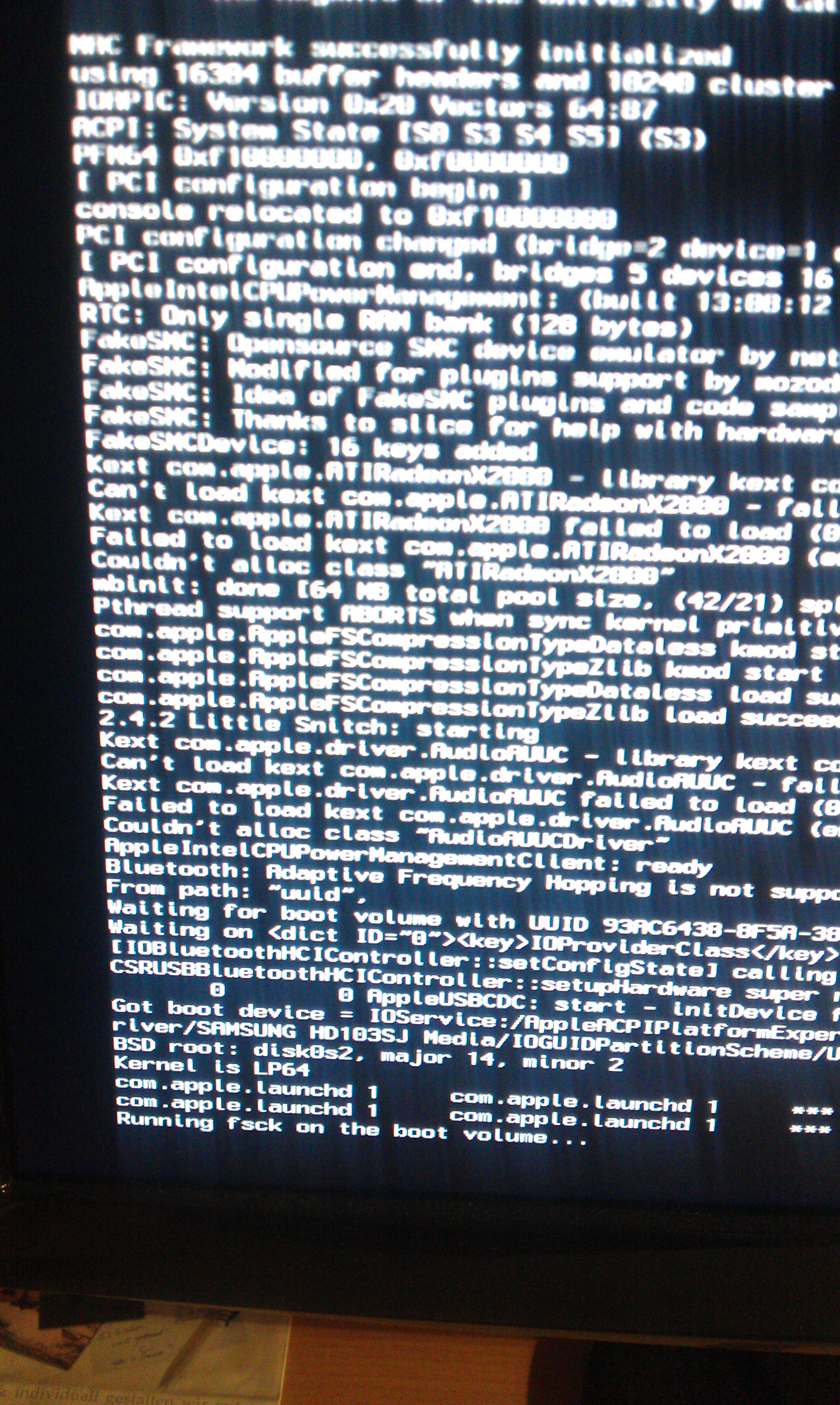

T-Bone90 Posted August 12, 2011 Share Posted August 12, 2011 Hello, my Problem: Yesterday LION works great of my System. Then I test Sleep but there comes an restart. The result: My BIOS-Setting are default and Lion (and Snow leopard on the other Partition) freeze. There is an Image in Attachment. What can I do? Main Storage information Configure SATA as: AHCI HD write protect: Disabled IDE detect time out: 0 AHCI configuration CD/DVD time out: 0 Advanced Onboard devices conf HD Audio: Enabled Front panel type: HD Audio Marvel IDE: Disabled Marvel LAN1: Enabled (associated LAN BOOT ROM: Disabled) Marvel LAN2: Enabled (associated LAN BOOT ROM: Disabled) LSI Firewire: Disabled Serial port: Disabled USB Configuration USB: Enabled 2.0 Controller: Enabled 2.0 Controller mode: HiSpeed EHCI Hand off: Enabled Legacy support: Auto Plug & Play: Yes Power Suspend mode: auto Report Video: no ACPI 2.0 support: Enabled APIC support: Enabled APM Configuration Power off, everything disabled Link to comment Share on other sites More sharing options...
allenwkk Posted August 12, 2011 Share Posted August 12, 2011 see the other topic on CMOS reset after sleep/restart http://www.insanelymac.com/forum/index.php?showtopic=253992 Link to comment Share on other sites More sharing options...
smartie77 Posted August 13, 2011 Share Posted August 13, 2011 Hello, my Problem: Yesterday LION works great of my System. Then I test Sleep but there comes an restart. The result: My BIOS-Setting are default and Lion (and Snow leopard on the other Partition) freeze. There is an Image in Attachment. What can I do? Main Storage information Configure SATA as: AHCI HD write protect: Disabled IDE detect time out: 0 AHCI configuration CD/DVD time out: 0 Advanced Onboard devices conf HD Audio: Enabled Front panel type: HD Audio Marvel IDE: Disabled Marvel LAN1: Enabled (associated LAN BOOT ROM: Disabled) Marvel LAN2: Enabled (associated LAN BOOT ROM: Disabled) LSI Firewire: Disabled Serial port: Disabled USB Configuration USB: Enabled 2.0 Controller: Enabled 2.0 Controller mode: HiSpeed EHCI Hand off: Enabled Legacy support: Auto Plug & Play: Yes Power Suspend mode: auto Report Video: no ACPI 2.0 support: Enabled APIC support: Enabled APM Configuration Power off, everything disabled you need to patch your AppleRTC.kext and/OR use "ElliotforcelegacyRTC.kext". There are also hacks to the DSDT that wil fix those issues. Link to comment Share on other sites More sharing options...
