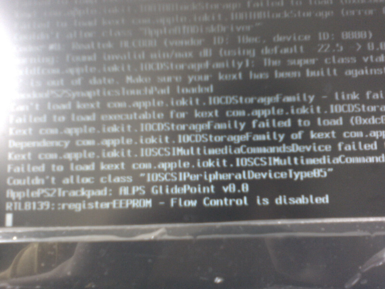

Alvin Leung Posted August 3, 2011 Share Posted August 3, 2011 Yesterday, I downloaded iATKOS S3 v2 (Mac OS X 10.6.3) and installed it. After installed it, everything went well. But I didn't know how to update it. In my experience, updating iATKOS v7 (Mac OS X 10.5.6) to Mac OS X 10.5.8 just needed to do the following setup: 1) Install Mac OS X 10.5.8 Combo Update 2) Do not restart 3) Install [url="http://www.insanelymac.com/forum/topic/279450-why-insanelymac-does-not-support-tonymacx86/"]#####[/url] 4) Choose Chameleon 2.0 RC5 5) Restart Following the above setup, it worked without any problem. I did the same setup in Mac OS X 10.6.8 update, I restarted with command '-v'. But it started and stopped at this script [PCI Configuration Begin]. I had no idea with this problem. Is that bootloader problem or some kexts needed to be patched? Can anyone help me??? Hardware Information: HP Pavilion a808hk ASUS PTGD1-LA (915G + ICH6) Intel Pentium 4 520 (2.80GHz, 1MB L2 Cache, MMX SSE (1, 2, 3), No EM64T) WDC WD6401AALS-00L3B2 (640GB, For Windows) WDC WD2000JB-00KFA0 (200GB, For Mac OS) ASUS EAH6570/DI/1GD3(LP) (AMD Radeon HD 6570, 1GB DDR3) HL-DT-ST DVDRAM GSA-4163B Link to comment https://www.insanelymac.com/forum/topic/264512-update-from-iatkos-s3-v2-mac-os-x-1063-to-mac-os-x-1068-problem/ Share on other sites More sharing options...

Alvin Leung Posted September 1, 2011 Author Share Posted September 1, 2011 But now it stopped at another script: RTL8139::registerEEPROM - Flow Control is disabled And I wait and wait and it said: Still waiting for root device How do I solve it??? Link to comment https://www.insanelymac.com/forum/topic/264512-update-from-iatkos-s3-v2-mac-os-x-1063-to-mac-os-x-1068-problem/#findComment-1742759 Share on other sites More sharing options...
smartie77 Posted September 1, 2011 Share Posted September 1, 2011 But now it stopped at another script:RTL8139::registerEEPROM - Flow Control is disabled And I wait and wait and it said: Still waiting for root device How do I solve it??? Don't focus on the EEPROM message, this can be harmless ( its from your ethernet device ) . The real Error is : somethings wrong with your SCSI ( AHCI ? ) Mass-Storage kexts, especially with your CD/DVDROM kexts.. "still waiting for root device" might be related to that. ( As long as OSX can not talk to all mass-storage devices, it blocks the hard disk from completing the boot ) . some kext ( can't identify from the shot ) says it is "outdated". Are you sure you have only Snow Kexts ? Typically such a error means you have mixed Leo and Snow Leo drivers.. The installation is definitely damaged and needs manual repair. Link to comment https://www.insanelymac.com/forum/topic/264512-update-from-iatkos-s3-v2-mac-os-x-1063-to-mac-os-x-1068-problem/#findComment-1743147 Share on other sites More sharing options...
Alvin Leung Posted September 2, 2011 Author Share Posted September 2, 2011 Don't focus on the EEPROM message, this can be harmless ( its from your ethernet device ) . The real Error is : somethings wrong with your SCSI ( AHCI ? ) Mass-Storage kexts, especially with your CD/DVDROM kexts.. "still waiting for root device" might be related to that. ( As long as OSX can not talk to all mass-storage devices, it blocks the hard disk from completing the boot ) . some kext ( can't identify from the shot ) says it is "outdated". Are you sure you have only Snow Kexts ? Typically such a error means you have mixed Leo and Snow Leo drivers.. The installation is definitely damaged and needs manual repair. Yesterday, I installed Mac OS X 10.6.3. When I boot it, it stopped at 'RTL8139::registerEEPROM - Flow Control is disabled'. I knew that the problem is Mac OS X 10.6 doesn't support Intel ICH6. Therefore, I installed ATAPortInjector.pkg from Hazard 10.6.6i DVD and it worked. But now I install it and it didn't work. Link to comment https://www.insanelymac.com/forum/topic/264512-update-from-iatkos-s3-v2-mac-os-x-1063-to-mac-os-x-1068-problem/#findComment-1743209 Share on other sites More sharing options...
