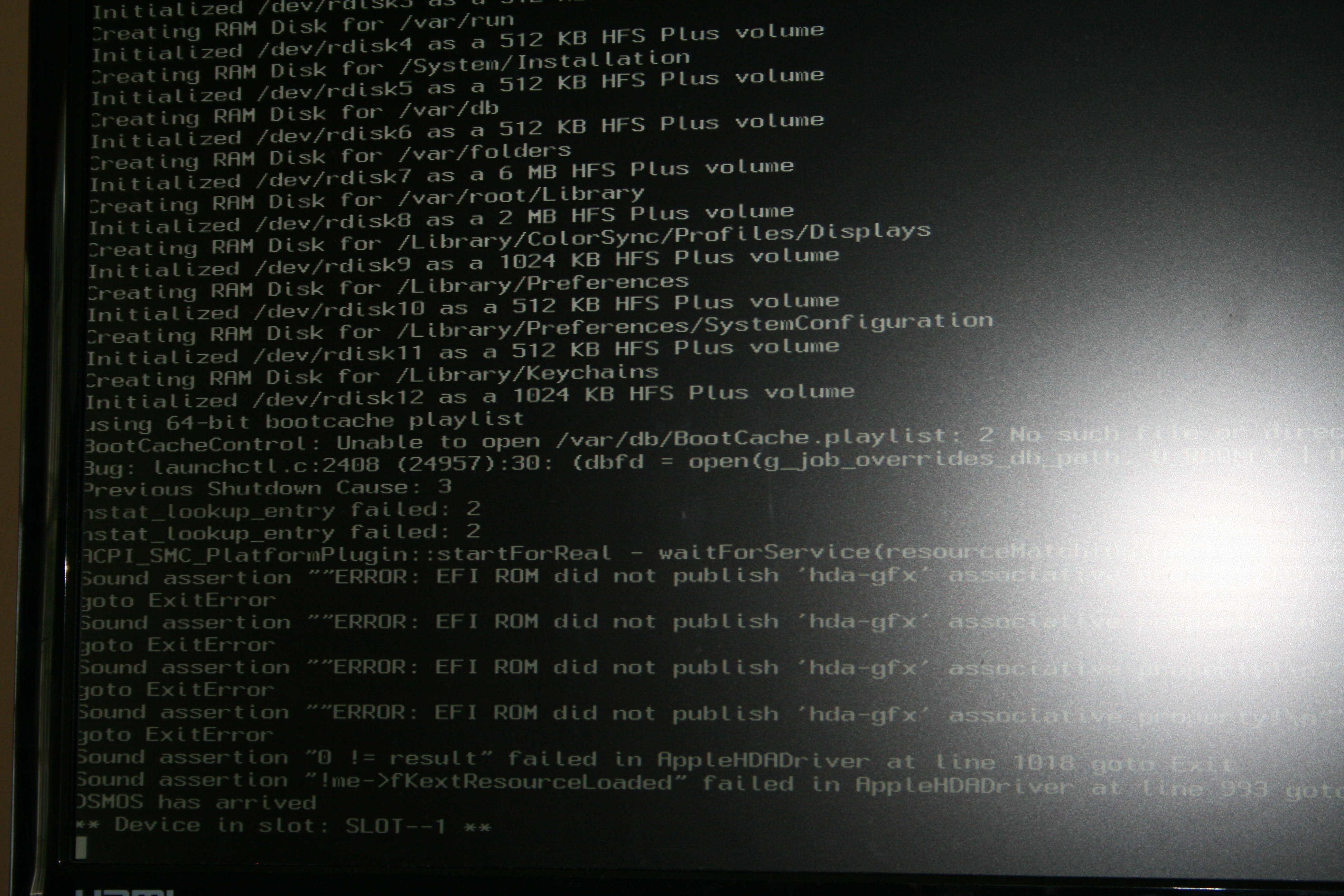

grady.lynch Posted August 1, 2011 Share Posted August 1, 2011 I just built my machine this afternoon and am eagerly attempting to install osx lion with Kakewalk 4.0.1. I prepared my 8gb usb thum drive and selected my motherboard with no problem. I set the bios to AHCI mode and HPET to 64 bit mode. I set my usb drive as the first boot device. When it boots I get a bunch of white writing on a grey background, then it goes to a black background. I snapped a picture of the screen right before the screen goes black, while the computer stays on. Again my motherboard is a GA-Z68X-UD3H-B3 Link to comment https://www.insanelymac.com/forum/topic/264366-gigabyte-z68x-ud3h-b3-kakewalk-401-install-help/ Share on other sites More sharing options...

el_gringo Posted August 22, 2011 Share Posted August 22, 2011 Same exact problem here as OP had. Same motherboard, and my video card is a Gigabyte AMD Radeon HD 6870. Does anybody have any other suggestions about how to fix this? Unplugging and replugging the video cable didn't help... EDIT: wow, I feel like an idiot. I changed the graphicsenabler setting in the boot preferences (on the kakewalk USB stick in /Extra/com.apple.boot.plist) from yes to no and it booted up just fine. 1 Link to comment https://www.insanelymac.com/forum/topic/264366-gigabyte-z68x-ud3h-b3-kakewalk-401-install-help/#findComment-1738246 Share on other sites More sharing options...

GffMaC Posted September 2, 2011 Share Posted September 2, 2011 Make sure to set your bios to AHCI and set HPET to Enabled 64-bit. Also try booting with 'npci=0x2000' at chameleon command prompt on boot drive (press tab a few times at chameleon/kakewalk boot screen). I now have Lion running smooth with a GTX570 and this board, audio and network working fine, only strange thing is my 1tb windows drive is not listed in disk utility which boots fine from the boot menu - weird. Link to comment https://www.insanelymac.com/forum/topic/264366-gigabyte-z68x-ud3h-b3-kakewalk-401-install-help/#findComment-1743308 Share on other sites More sharing options...
aj05hi Posted September 2, 2011 Share Posted September 2, 2011 If your video card is 9800 GTX + then it is not supported in kakewalk 4 (yet) and you need to set GraphicsEnabler=No as the default is set to 'Yes' and it will work then (well that worked for me atleast). The only problem is that I am still awaiting for my graphic card to be fully recognised by Lion. Link to comment https://www.insanelymac.com/forum/topic/264366-gigabyte-z68x-ud3h-b3-kakewalk-401-install-help/#findComment-1743430 Share on other sites More sharing options...
