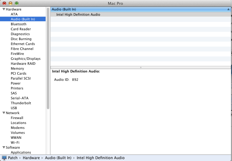

Ace Raider Posted August 2, 2011 Share Posted August 2, 2011 This did not work for me in 10.7. I am using Asus P8H67-I deluxe MB. I get the correct port assignments showing up in System Information, but no devices show up in the preference pane. Are you using the DSDT code posted above also? Or Just the Kext? Should the next be version 2.1.2 or 2.1.1? What ws modified in the kext? Thanks, Link to comment https://www.insanelymac.com/forum/topic/263930-alc892-applehda-v205-snow-1068/#findComment-1728468 Share on other sites More sharing options...

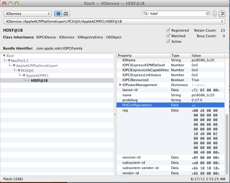

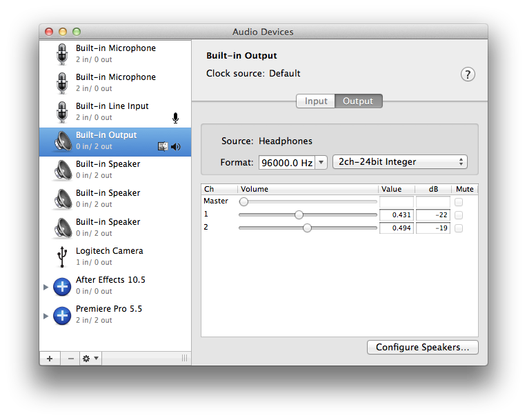

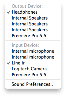

thewierdone2000 Posted August 17, 2011 Share Posted August 17, 2011 So with this do we need MacMan's ALC8xxHDA.kext? Right now this isn't working for me in Lion. Downloaded and installed the kext provided in post 3 as well as used the DSDT section in post one, but my audio device still isn't showing up. Hopefully the screenshots below will give the pros an idea on where I went wrong. Thanks! EDIT: Fixed by installing MacMan's Injector. Now works exactly as described and fixed my slow iTunes start up! You rock!! Link to comment https://www.insanelymac.com/forum/topic/263930-alc892-applehda-v205-snow-1068/#findComment-1735952 Share on other sites More sharing options...
sevenalive Posted August 17, 2011 Share Posted August 17, 2011 No you shouldn't need anything besides the kext, remove voodoo and any other audio kexts. I used the dsdt for my motherboard on the tonymac site, as they are very good and tested. Try his dsdt for your board. Also make sure you repair disk permissions in disk utility after replacing/adding any kexts and clearing the kext caches. That might be your issue. I'm also using Chimera. He made this kext for ALC892 and specifically the Sabertooth x58, not sure if it is supposed to work with your board. Link to comment https://www.insanelymac.com/forum/topic/263930-alc892-applehda-v205-snow-1068/#findComment-1735957 Share on other sites More sharing options...
thewierdone2000 Posted August 17, 2011 Share Posted August 17, 2011 No you shouldn't need anything besides the kext, remove voodoo and any other audio kexts. I used the dsdt for my motherboard on the tonymac site, as they are very good and tested. Try his dsdt for your board. Also make sure you repair disk permissions in disk utility after replacing/adding any kexts and clearing the kext caches. That might be your issue. I'm also using Chimera. He made this kext for ALC892 and specifically the Sabertooth x58, not sure if it is supposed to work with your board. For some reason installing and then uninstalling MacMan's kext made it work. Perhaps a cache was in need of clearing, but I had rebuilt them when I originally installed the new AppleHDA.kext file. In any event, this is working wondrously with my board, fixing something that's been driving me crazy for over a month now! Thank you so much for your hard work, as well as to those who help answer questions! Link to comment https://www.insanelymac.com/forum/topic/263930-alc892-applehda-v205-snow-1068/#findComment-1735967 Share on other sites More sharing options...
