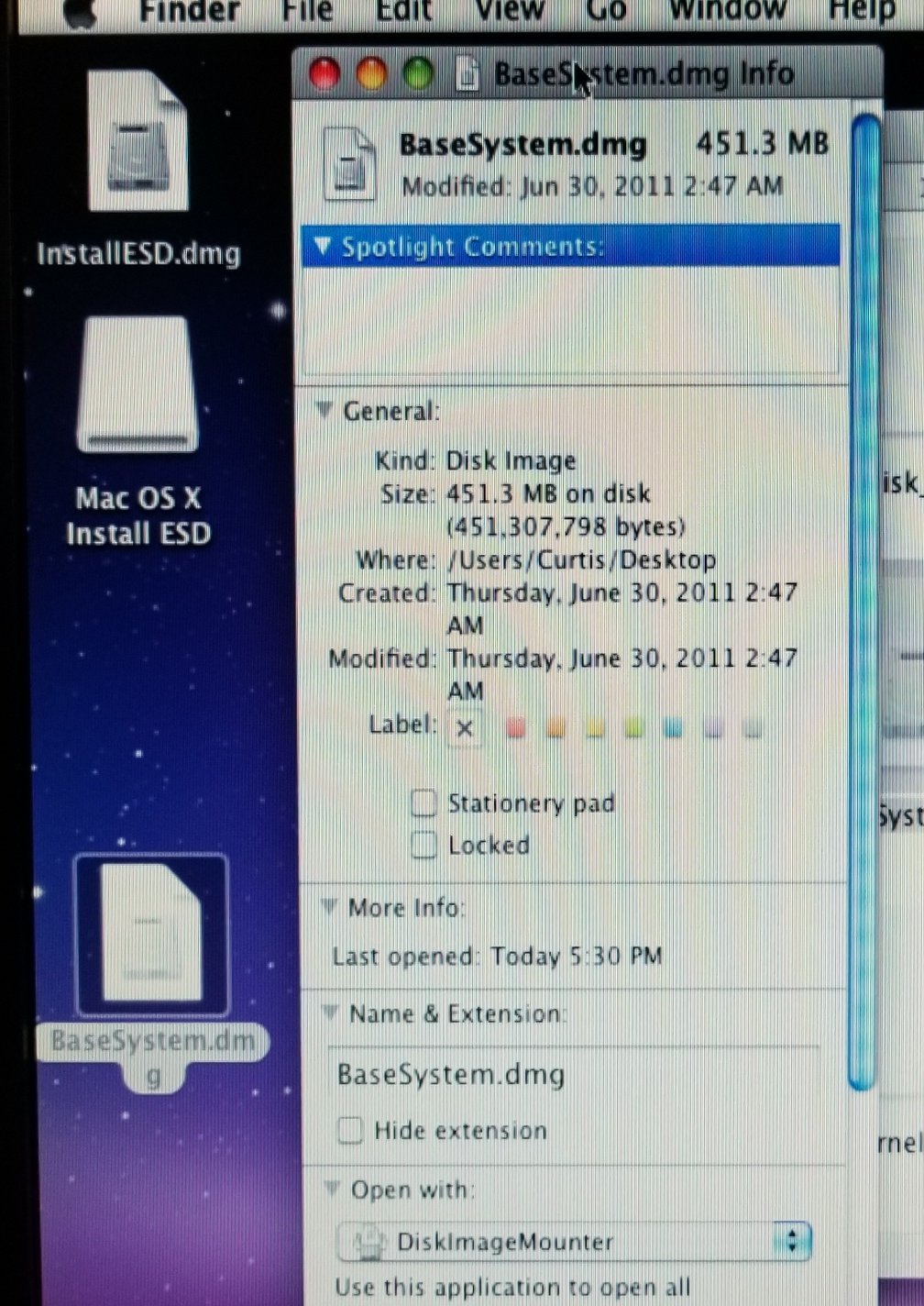

bearhntr28 Posted December 6, 2018 Share Posted December 6, 2018 On 12/3/2018 at 9:34 PM, chris1111 said: ok but depends what is the installer the user have for create usb drive ? a .dmg or .app Chris, It was at one time the .APP from APPLE STORE. I had used that couple to three years back when I was building some VMs for ESXi to get the .DMG file so that I could burn to DVD and make an .ISO from that. I know.. HOOPS, HURDLES and TIGHT ROPE walking. But I got it done. I believe the original .APP file I had downloaded is long since gone. So I used the .DMG file I still had on my NAS. That is the file that I have been using all along. On Sunday night when I was playing with this again -- I was getting prompted for my password every time I would write a file to the LION.DMG (using Pippo's steps) file. I had already created the new image file as per his steps at 4.6GB CD/DVD GUID. Still not sure I am choosing the RIGHT SETTINGS for creating the BLANK DISK IMAGE (LION.DMG) that is used for the initial restore of BaseImage step. (see image) I had pulled the BaseImage out of the .DMG I have for LION and RESTORED this to the LION.DMG file. This all went through with no problems. I was able to DELETE the PACKAGES link and copy of the folder from the ORIGINAL .DMG file as per his instructions. It was when I started adding the files to the LION.DMG where I was getting prompted for a PW each time. I finally made it to the part where Extra_Lion.pkg and the Chameleon.pkg were installed TO THE LION.DMG file ( in prep for making the USB). I formatted the 16GB USB as instructed, dragged to the RESTORE window in DISK UTIL, and LION.DMG file I had worked on. NEVER does the REPAIR PERMISSIONS link ever become accessing on any of these files that I have been creating. So I use the REPAIR DISK option on the right-hand side. This new message I am getting I am attaching to this message. I went to IMAGES MENU and did the CHECK FOR RESTORE OPTION and it fails out. This is why I wanted to buy LION again so that I have a brand new file. So that I can rule out the file as the issue, and not my stupidity. I did successfully build one of the HACKINTOSH machines on an old IBM T61 many years ago. It worked fully (except the LID CLOSE SLEEP) - and even Updated from SL to LION using the Apple Updater. Many Thanks, CNorris Link to comment https://www.insanelymac.com/forum/topic/263863-osx-lion-on-dell-optiplex-760/page/2/#findComment-2652360 Share on other sites More sharing options...

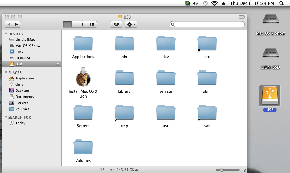

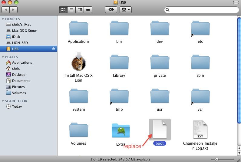

chris1111 Posted December 6, 2018 Share Posted December 6, 2018 (edited) Prépare your Install Mac OS X Lion.app tonight when I get back home I will send you a complete programme to Create a usb inside Snow leopard. Clover Will be included Edited December 6, 2018 by chris1111 1 Link to comment https://www.insanelymac.com/forum/topic/263863-osx-lion-on-dell-optiplex-760/page/2/#findComment-2652394 Share on other sites More sharing options...

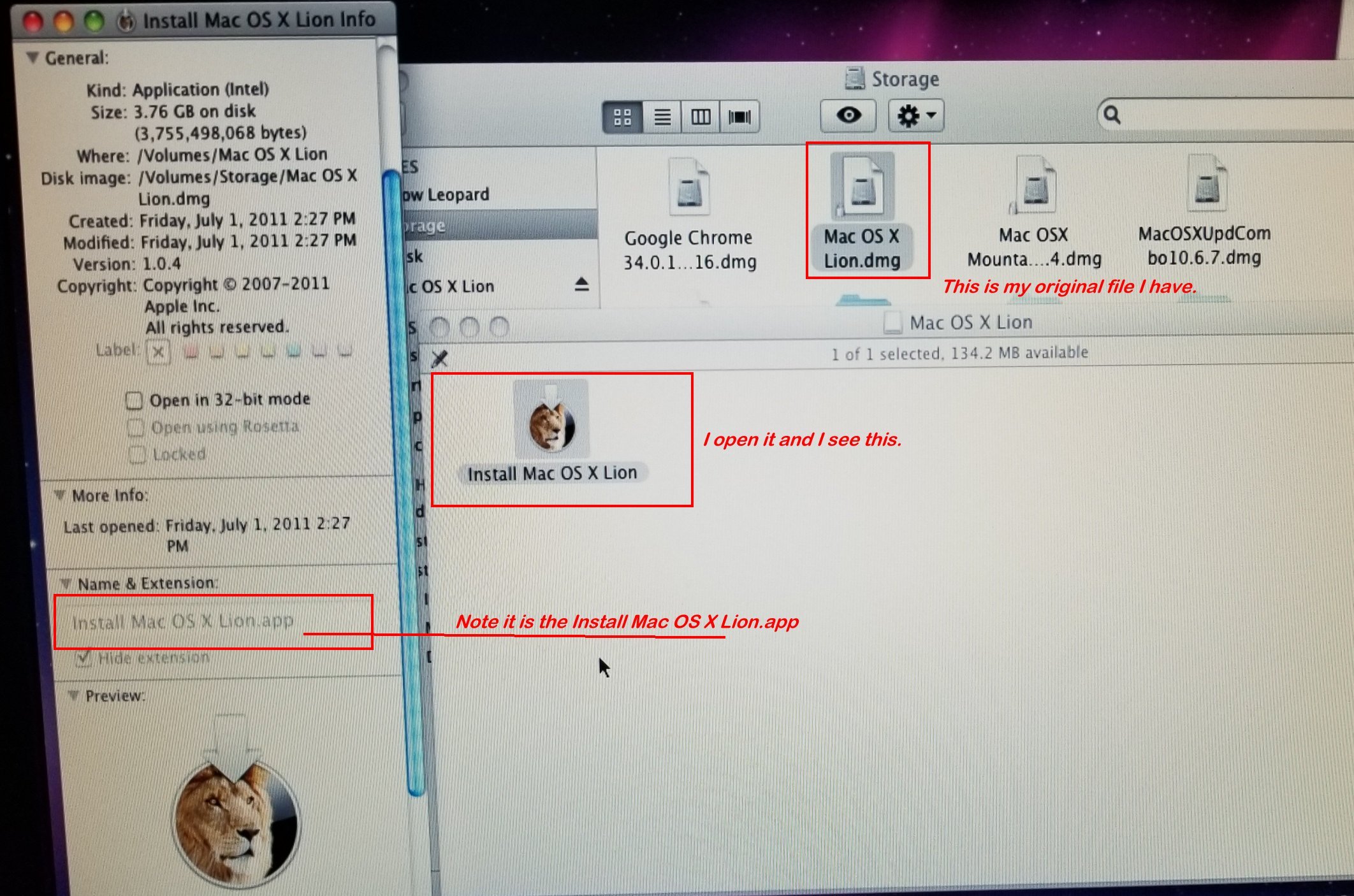

bearhntr28 Posted December 6, 2018 Share Posted December 6, 2018 45 minutes ago, chris1111 said: Prépare your Install Mac OS X Lion.app tonight when I get back home I will send you a complete programme to Create a usb inside Snow leopard. Clover Will be included Chris, Not sure I am doing this correctly....will the .DMG that I have work? It is 10.7.5 (as I had it named). When I mount it, I do see a LION INSTALLATION APP. I right click on it and choose VIEW CONTENTS. That is when I am able to pull the other files out. The first Installxxxxx.dmg and then MOUNT that one, and I can pull the BaseSystem.dmg out of there - after enabling the VIEW HIDDEN FILES with Terminal. That is the file I have been using through all of this. I appreciate anything you (or Pippo) can do to help me get this working. Do you know - will I then (if I buy ML or even M, EC or S) - be able to upgrade it? CNorris Link to comment https://www.insanelymac.com/forum/topic/263863-osx-lion-on-dell-optiplex-760/page/2/#findComment-2652400 Share on other sites More sharing options...

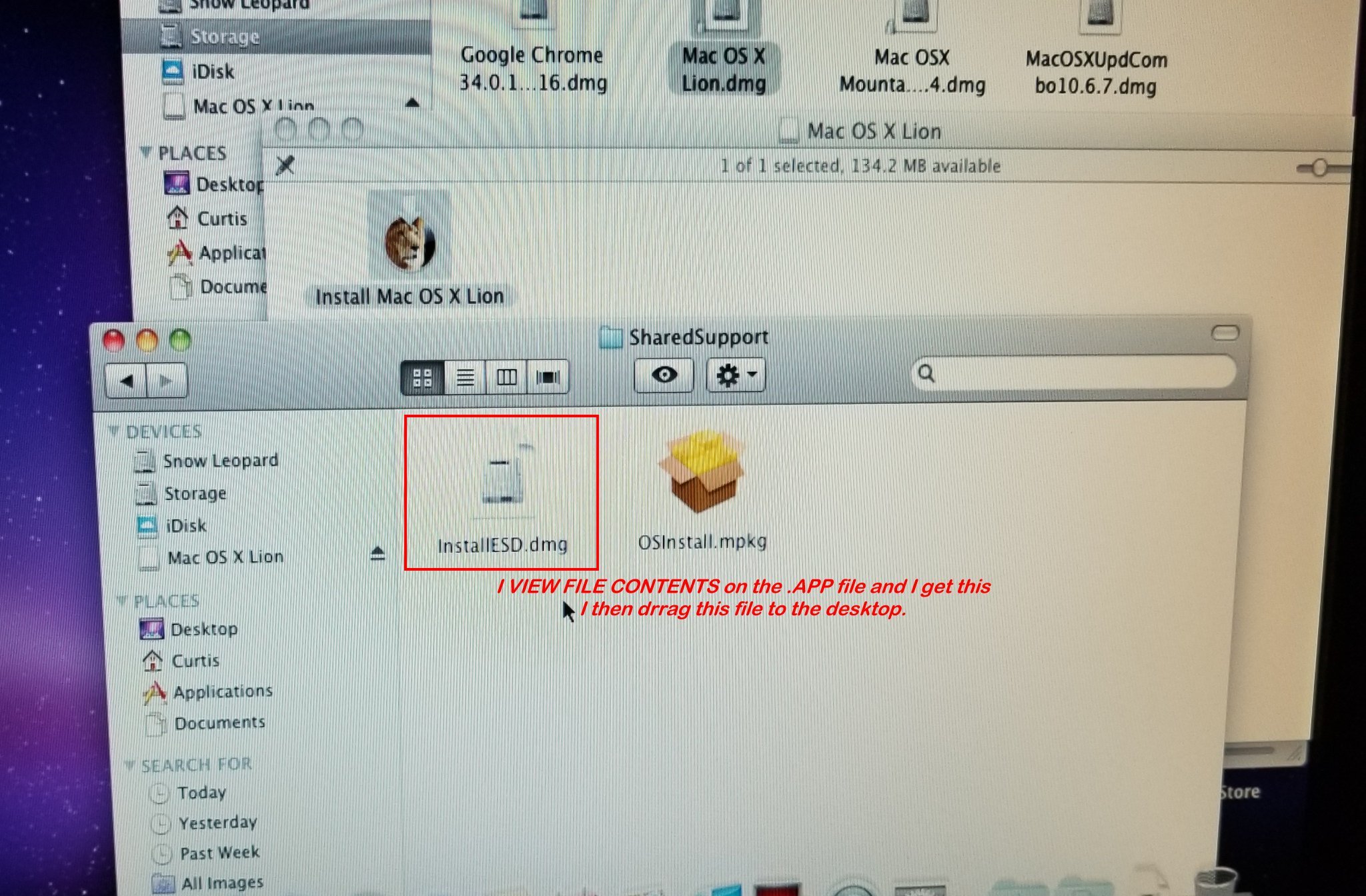

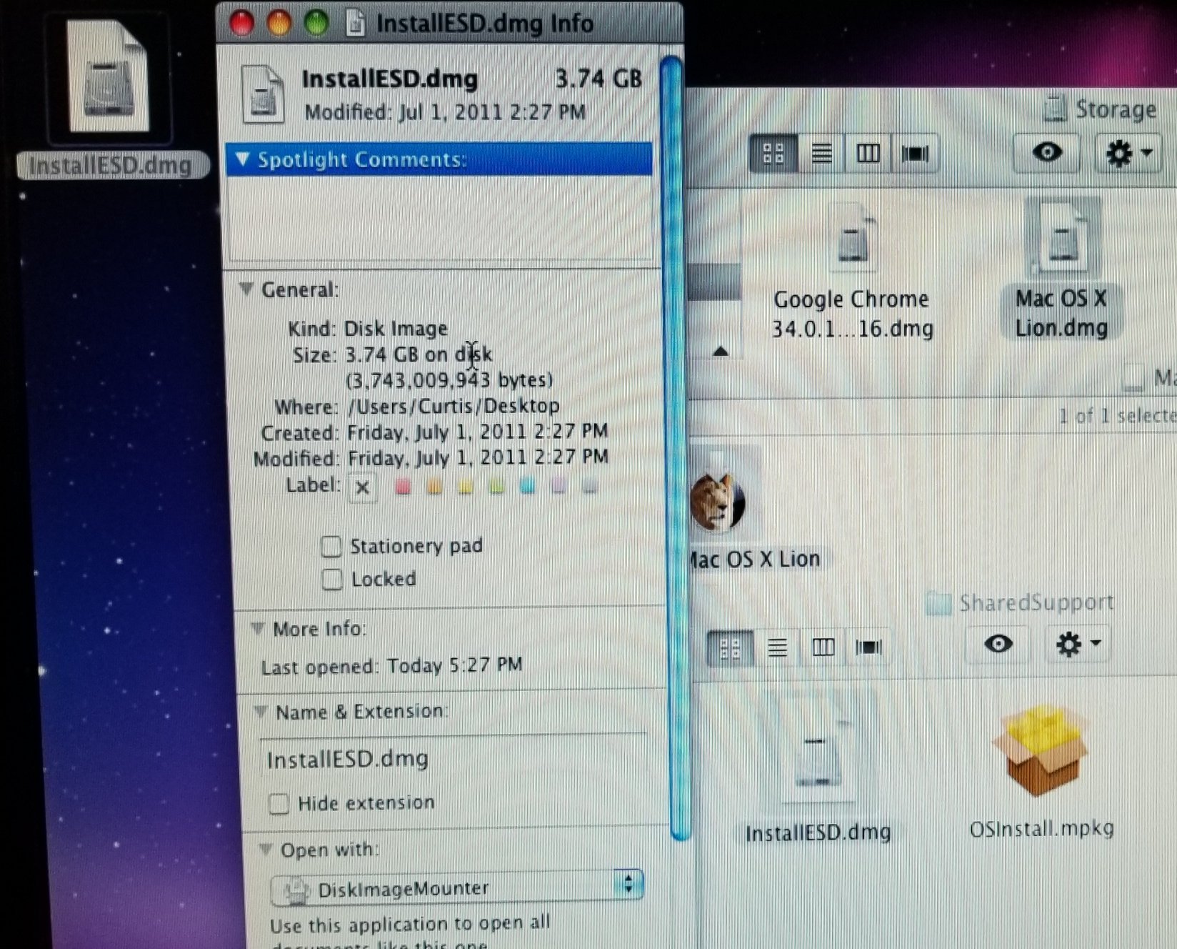

chris1111 Posted December 6, 2018 Share Posted December 6, 2018 Copy lion instalation.app on Desktop show packages content /SharedSupport Do you have InstallESD.dmg ? Link to comment https://www.insanelymac.com/forum/topic/263863-osx-lion-on-dell-optiplex-760/page/2/#findComment-2652405 Share on other sites More sharing options...

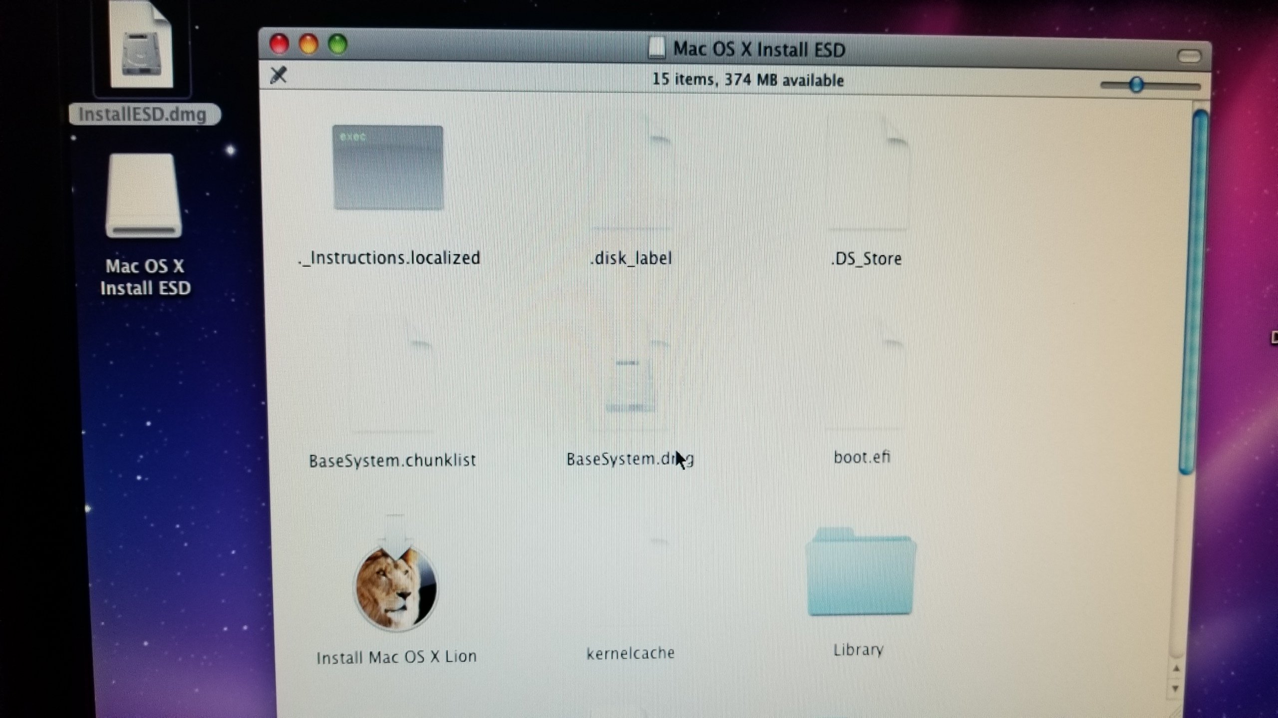

bearhntr28 Posted December 6, 2018 Share Posted December 6, 2018 20 minutes ago, chris1111 said: Copy lion instalation.app on Desktop show packages content /SharedSupport Do you have InstallESD.dmg ? Chris... YES. I begin with the .DMG that I pulled out when I bought it 2+ years ago. I copy to the desktop from my EXT HDD. I then MOUNT IT. I have an InstallESD.dmg. I mount that (UNHIDE FILES) to find the BaseSystem.dmg. I pull that to the desktop, and MOUNT IT. Then I RESTORE that file to the LION.DMG (as named by Pippo's instructions) that I created the BLANK R/W file at 4.6 GB CD/DVD and GUID HFS+. That is the file where I do all my work. Delete the PACKAGES link and copy that folder from the First InstallESD.dmg file. Then I put all the KEXTs as per Pippo's instructions (except the MBR ones - was told I did not need those with a GUID formatted HDD). Then I install the Extra_Lion.pkg to the LION.DMG file (I see the new EXTRAS folder). Then I run the CHAMELEON file and I see a boot file show up (greyed - so I know it is hidden). Then I follow the rest of the steps...but I never get the REPAIR PERMISSIONS options. They are always greyed out. CNorris Link to comment https://www.insanelymac.com/forum/topic/263863-osx-lion-on-dell-optiplex-760/page/2/#findComment-2652408 Share on other sites More sharing options...
chris1111 Posted December 6, 2018 Share Posted December 6, 2018 Ok prepare a USB drive 8 gig and follow my instructions tonyght I Will post here you need installer lion.app and 8 gig USB Link to comment https://www.insanelymac.com/forum/topic/263863-osx-lion-on-dell-optiplex-760/page/2/#findComment-2652415 Share on other sites More sharing options...

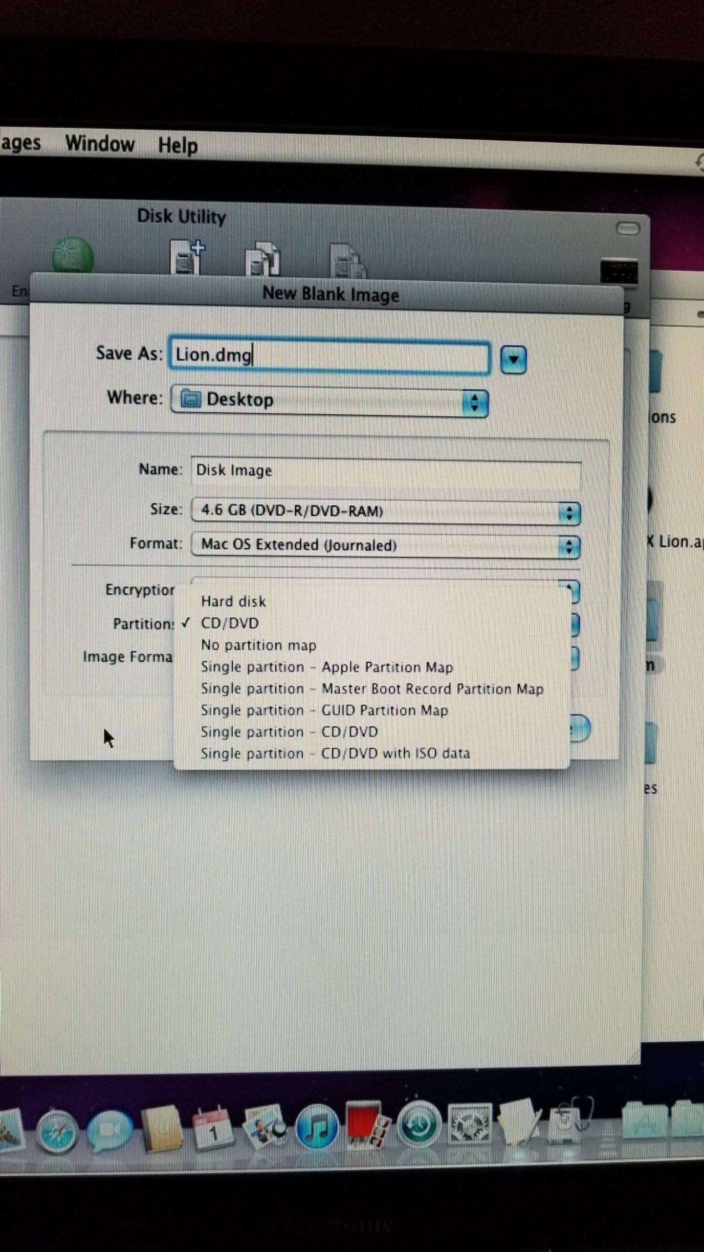

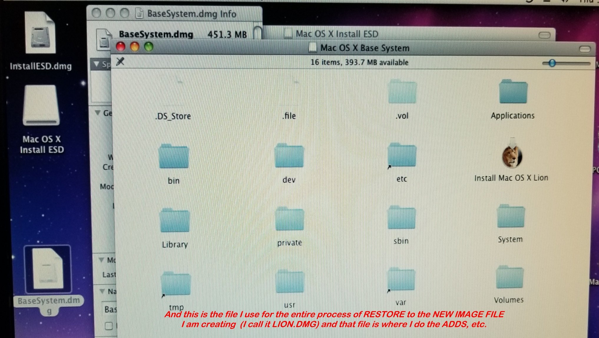

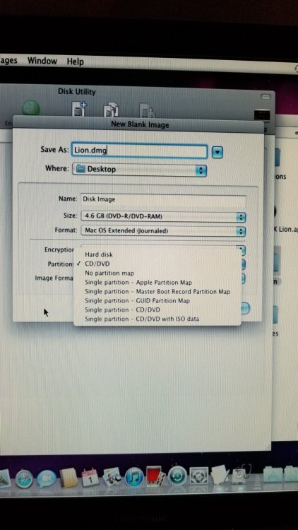

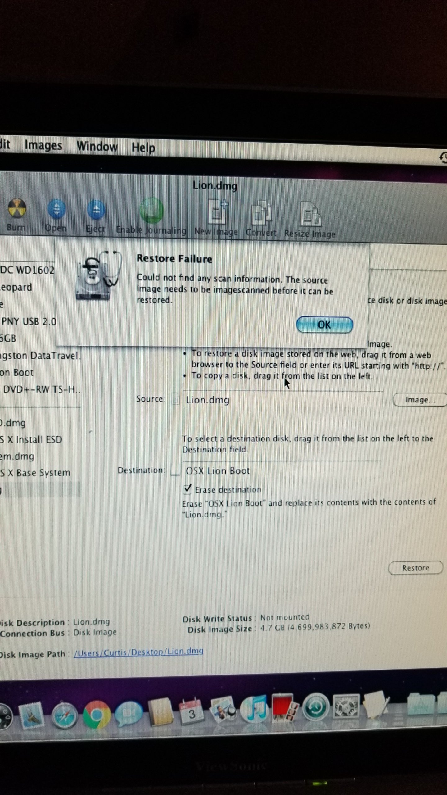

bearhntr28 Posted December 6, 2018 Share Posted December 6, 2018 8 minutes ago, chris1111 said: Ok prepare a USB drive 8 gig and follow my instructions tonyght I Will post here you need installer lion.app and 8 gig USB Posting some pics I just took in the order of how I am getting my files. Let's hope they all fit. Link to comment https://www.insanelymac.com/forum/topic/263863-osx-lion-on-dell-optiplex-760/page/2/#findComment-2652418 Share on other sites More sharing options...

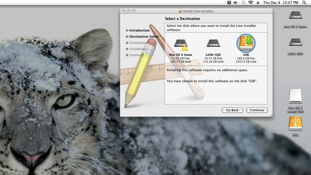

chris1111 Posted December 7, 2018 Share Posted December 7, 2018 (edited) 15 hours ago, bearhntr28 said: Chris, I really appreciate your help. Does it have to be 8GB? All I have a 16, 32 and 64GB Jump Drives. CNorris You need minimum 8 gig usb 16 is correct so Formate USB as macOS Extend journaled / GUID partition Table Mount InstallESD.dmg and run Lion Installer.pkg then select USB drive This is the complet content of USB when is finish Run → Enoch Bootloader as Standard installation Option is not important because you have to replace Extra Folder by the one attaching here Select F12 / Boot to USB that's it Hope that help PS: Enoch Chameleon is better for your hardware Extra.zip Lion Installer.zip EDIT **** If Enoch failed cause of compatibility with Snow Leopard use Chameleon-2.2svn-r2404.pkg attaching here Like this, change location, select USB and Put Extra Folder attaching Now you have to replace boot file by the one attaching I just test on my Optiplex 790 and its boot perfectly Good luck If everythings is ok for post install do it same thing on HD for make it boot without USB boot.zip Chameleon-2.2svn-r2404.pkg.zip Edited December 7, 2018 by chris1111 2 Link to comment https://www.insanelymac.com/forum/topic/263863-osx-lion-on-dell-optiplex-760/page/2/#findComment-2652438 Share on other sites More sharing options...
bearhntr28 Posted December 7, 2018 Share Posted December 7, 2018 10 hours ago, chris1111 said: PUTTING MY COMMENTS/QUESTIONS IN BLUE (removing the pictures) You need minimum 8 gig usb 16 is correct so Formate USB as macOS Extend journaled / GUID partition Table Mount InstallESD.dmg and run Lion Installer.pkg then select USB drive This is the complet content of USB when is finish OK...I think I did this step right. I ran the LION INSTALLER and pointed it to the newly formatted 16GB USB (I named it LION_BOOT_USB) - took about 20 mins, but I got a SUCCESSFUL message at the end. Run → Enoch Bootloader as Standard installation When I run this - am I pointing it back to the LION_BOOT_USB ?? Option is not important because you have to replace Extra Folder by the one attaching here Once I run the ENOCH BOOTLOADER - I extract the EXTRA.ZIP file and place that folder in the ROOT of the LION_BOOT_USB? Select F12 / Boot to USB that's it Hope that help PS: Enoch Chameleon is better for your hardware EDIT **** If Enoch failed cause of compatibility with Snow Leopard use Chameleon-2.2svn-r2404.pkg attaching here Like this, change location, select USB and Put Extra Folder attaching Now you have to replace boot file by the one attaching I just test on my Optiplex 790 and its boot perfectly Good luck If everythings is ok for post install do it same thing on HD for make it boot without USB boot.zip Chameleon-2.2svn-r2404.pkg.zip See my QUESTIONS / COMMENTS above in BLUE - I have all the files now -- I will report back as to how I fare. At what point in this (even with your edits below) am I going to be installing to the HDD? So far this looks as to be building a bootable LION USB. Many Thanks, CNorris Link to comment https://www.insanelymac.com/forum/topic/263863-osx-lion-on-dell-optiplex-760/page/2/#findComment-2652549 Share on other sites More sharing options...
chris1111 Posted December 7, 2018 Share Posted December 7, 2018 (edited) 20 minutes on a STANDARD usb 2.0 port this is normal Edited December 7, 2018 by chris1111 Link to comment https://www.insanelymac.com/forum/topic/263863-osx-lion-on-dell-optiplex-760/page/2/#findComment-2652550 Share on other sites More sharing options...
bearhntr28 Posted December 7, 2018 Share Posted December 7, 2018 (edited) Chris1111, UPDATE: OK. Followed your instructions - here is what I did. 1) Mounted the InstallESD.dmg file as instructed (the one I extracted from my file where I was pulling the BaseSystem.dmg file from). 2) Ran your Lion Installer file, and chose the newly formatted USB drive as the destination. Took about 20 mins to run the installation, but it ended with SUCCESSFULLY INSTALLED message. 3) I then ran the ENOCH installer - it failed with some weird message - like you thought. 4) Ran the Chameleon installer - it was successful ( will attach the log file below it created ) - it looks to have adjusted the boot partition for my SL installation on the HDD as well - as now that is not booting without the iBo*** DVD in the drive. I did not get this menu: 5) PROCEEDED with your other steps. Copied the EXTRA FOLDER over to the USB. 6) Copied the boot file over to the USB. 7) SHUT DOWN. 8) Powered on - pressed <F12> to boot options and booted from USB. * Also getting BIOS reset warnings every time I boot. This I think can be easily fixed. 9) It appears to be booting from USB - light is flashing on it. I then get a slight flash of text (2 lines) at the top of the page, then about 4 pages of scrolling text (light on USB still flashing). 10) After about a 2 min pause - I get a WHITE SCREEN with Spinning rainbow beach ball. This stays on the screen (mouse does move it around) for about 4 mins - then disappears. I am left with a solid white screen. No mouse pointer - nothing but white. Has been sitting like that about 20 mins now. I am sure I did something wrong. Do you think it could be the GeForce GT430 video card? Would this ever work with the Built-In Video - or should I look for another card? Suggestions? *** We are making progress CNorris Chameleon_Installer_Log.txt Edited December 7, 2018 by bearhntr28 attaching file Link to comment https://www.insanelymac.com/forum/topic/263863-osx-lion-on-dell-optiplex-760/page/2/#findComment-2652567 Share on other sites More sharing options...

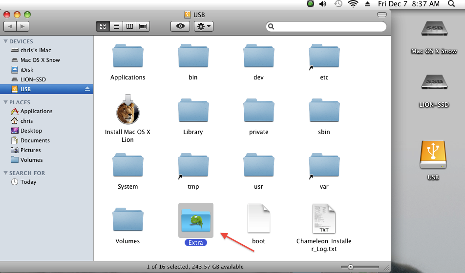

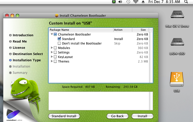

bearhntr28 Posted December 8, 2018 Share Posted December 8, 2018 Chris, OK - I rebuilt the USB drive again late last night. I am attaching the EXTRA folder from this rebuild. It should be the same as the one you gave me, as I run the CHAMELEON pkg file (figured out how to get the screen to match yours - using the CUSTOMIZE button). After I have run that and installed to the USB - I copied over the EXTRA folder (unzipped of course) to the USB. Then I copied over the BOOT file. I get a warning that one already exists - so I tell it to replace the file. I boot from the USB using the <F12> option, and still when the machine boots I get an error about BIOS Settings - and when I look in the BIOS logs there is a BIOS CHECKSUM error. I am able to get past this. and booting continues from the USB. I get a greyish screen with a solid dark grey apple, then the apple changes to one which is more white (3-D style) - about 30 seconds later the screen goes WHITE with rotating rainbow ball cursor (which moves with the mouse). This stays for about 2 minutes, then goes away leaving only a white screen. No mouse, nothing at all. From the attached Chameleon installer log file -- these lines stand out to me: Clearing options... ====================================================== Running Standard postinstall script Target volume = /Volumes/LION_BOOT_USB on /dev/disk1s2 Target disk already has existing Chameleon stage 0 loader - boot0 ======================================================Stage 0 loader not written to /dev/disk1. Written boot1h to /dev/rdisk1s2. Written boot to /Volumes/LION_BOOT_USB on /dev/disk1s2.====================================================== Preparing to check target disk for previous installations. Going to check the EFI system partition also. Mounting /dev/disk1s1 as /Volumes/EFI. Checking disk1. Nothing found that could cause any problems. Says that something was not written to disk. If there is anything else that you need, let me know. It seems that every time I build this USB drive...it breaks the SL installed on the HDD and does something to the CMOS on the system where I have to RESET the TIME (changes it by 7 hours into the future) and also makes other changes (like turning on LPT port and SERIAL port -- which I keep disabled), also enables the MBeK settings again and writes a warning to the LOGS about a CMOS CHECKSUM error. Also changes the BOOT ORDER to CD >> HDD >> USB from where I had to set to USB >> HDD >> CD. CNorris Chameleon_Installer_Log.txt Extra_Curtis.zip Link to comment https://www.insanelymac.com/forum/topic/263863-osx-lion-on-dell-optiplex-760/page/2/#findComment-2652797 Share on other sites More sharing options...
