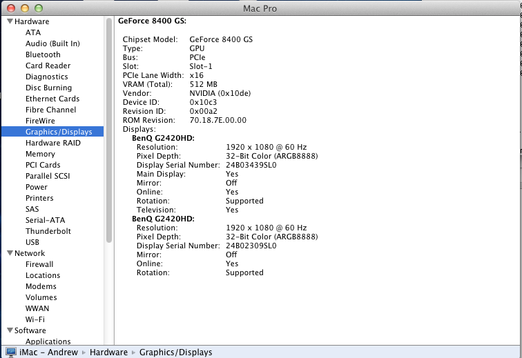

Unequipp Posted July 24, 2011 Share Posted July 24, 2011 This is a complete solution working for me for configuration: OS X Lion 10.7 M/B ASUS P8P67-M Rev3.0 (RTL) LGA1155 <P67> 2xPCI-E+GbLAN+1394 SATA RAID MicroATX (Realtek RTL8111E LAN controller & Realtek ALC 887-VD2 audio codec). CPU Intel Core i3-2120 512Mb <PCI-E> DDR-2 Gigabyte GV-N84S-512I (RTL) +DVI+HDMI <GeForce 8400GS> After successful installation of the system and the boot loader: 0) Download ASUS_P8P67_M.zip 1) Copy dsdt.aml file to your desktop. I took MaLd0n's DSDT from theme. Later, it was edited with the help of rafirafi's notes from here! 2) Run [url="http://www.insanelymac.com/forum/topic/279450-why-insanelymac-does-not-support-tonymacx86/"]#####[/url] and select "UserDSDT Install", AppleHDA Rollback (under Drivers&Bootloader -> Kexts&Enablers -> Audio -> Realtek) and Lnx2Mac's RealtekRTL81xx Ethernet! And we have to rebuild cache and repair permissions. Someone noted that System Utilities from [url="http://www.insanelymac.com/forum/topic/279450-why-insanelymac-does-not-support-tonymacx86/"]#####[/url] broke kextcache, so I decided to use Kext Utility or Kext Wizard! 3) Reboot! After this you will notice new Ethernet controller appears in preferences. My GeForce 8400GS is also recognised by system, but I can't still change resolution. 4) If you still cannot change resolution, it is necessary to edit NVDANV50Hal.kext (located under /S/L/E/). Move it from /S/L/E/ to e.g. Desktop. Open Info.plist file inside it and scroll to <key>IOPCIPrimaryMatch</key> section. Look, my vendor ID is 0x10de and Device ID is 0x10c3. So, we gotta combine this into 0x10c310de! Right after the last string: 0x0ca010de&0xffe0ffff in IOPCIPrimaryMatch we have to add: 0x10c310de&0xffe0ffff Save file. There is no need to edit NVDAResman.kext in Lion! This method was noted by a1k0n and oldnapalm! 5) Using KextHelper, add NVDANV50Hal.kext and dmazar's kext ALC887vdHDA_6Ch_RMic_SPDIF.kext Run Kext Utiluity or Kext Wizard! Reboot! 6) After the reboot you can change resolution, HDMI (or DVI) and D-Sub works. Sound is perfectly working! I tested SPDIF and Internal Speakers! It works flawlessly, without any cracks, glitches and kernel panics! I have to thank MaLd0n, rafirafi, dmazar, a1k0n, oldnapalm, [url="http://www.insanelymac.com/forum/topic/279450-why-insanelymac-does-not-support-tonymacx86/"]#####[/url]! Thanks to all of you! Wouldn't be able to do this without your help! I didn't try to run USB 3.0 controller and FireWire controller. Still I got one problem left: I've got 2 FullHD monitors, but HDMI and DVI do not work together. And I have to connect the second monitor to D-Sub port, though it doesn't not provide enough quality. Link to comment https://www.insanelymac.com/forum/topic/263414-asus-p8p67-m-rev30-geforce-8400gs-installation/ Share on other sites More sharing options...
