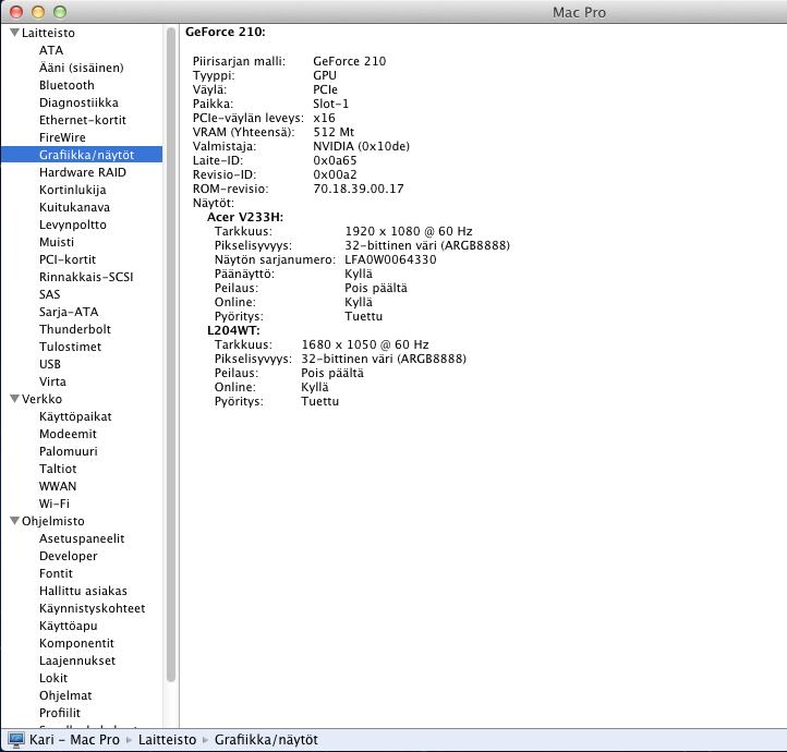

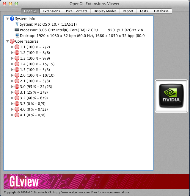

Kari_Juhani Posted July 22, 2011 Share Posted July 22, 2011 This was a reply to another nVidia card. Tested it and there it is... damn ripples... QE/CI working. ---------------------------------------------- Hi all, i have tried to find answer for this card... does it support or not ! There are some conflicting answers around different sites. And by judging the dates of these posts, they are talking about Snow, even it is not written anywhere. I use, at the moment, only "GraphicsEnabler=Yes and PciRoot=1". No QE/CI as i see it... OpenGL works, up to 2.2 and somewhat also in 3.0 (about 350 to 400FPS) I tested with latest NVEnabler = NO LUCK and with inserting strings to boot.plist .... if i set GraphicsEnabler=No, it won't boot and gets stuck on "[PCI Configuration begin]" I have also a Quadro FX3700 and it (and also this 210) is working perfectly on 10.6.8 !!! Any help would be nice... does anyone have this card working on Lion ? kari Link to comment Share on other sites More sharing options...
figgy Posted July 22, 2011 Share Posted July 22, 2011 I have a pny geforce 210 512 and could only manage to get it working in lion using efi studio and generating an efi string for an 8600gt 512......graphics enabler wouldnt work for me but saying that/wasnt using the pci root command in boot plist,so that may have been the reason why it wasnt detected.....I had previously used an efi string that i managed to get from a 210 rom and it worked fine in snow leopard,when i used it to try to install lion it just sat on a grey screen with the spinning beachball....i then tried 32bit and it got me past this and let me install,but i had loads of problems with it forgeting resolution after sleep or reboot 8600gt efi string lets me run 32bit and 64bit ...its very snappy at animation movies etc and doesnt forget the resolution after sleep or reboot it profiles as an 8600gt and not the 210 but its just cosmetic,its still detected by glview as a 210 Nvidia GeForce 8600 GT: Chipset Model: Nvidia GeForce 8600 GT Type: GPU Bus: PCIe PCIe Lane Width: x16 VRAM (Total): 512 MB Vendor: NVIDIA (0x10de) Device ID: 0x0a65 Revision ID: 0x00a2 ROM Revision: Nvidia GeForce 8600 GT OpenGL Engine [EFI] Displays: Display Connector: Status: No Display Connected Display: Resolution: 1280 x 1024 @ 60 Hz Pixel Depth: 32-Bit Color (ARGB8888) Display Serial Number: F9VI690234232 Main Display: Yes Mirror: Off Online: Yes Rotation: Supported Link to comment Share on other sites More sharing options...
Kari_Juhani Posted July 22, 2011 Author Share Posted July 22, 2011 I have a pny geforce 210 512 and could only manage to get it working in lion using efi studio and generating an efi string for an 8600gt 512......graphics enabler wouldnt work for me but saying that/wasnt using the pci root command in boot plist,so that may have been the reason why it wasnt detected.....I had previously used an efi string that i managed to get from a 210 rom and it worked fine in snow leopard,when i used it to try to install lion it just sat on a grey screen with the spinning beachball....i then tried 32bit and it got me past this and let me install,but i had loads of problems with it forgeting resolution after sleep or reboot 8600gt efi string lets me run 32bit and 64bit ...its very snappy at animation movies etc and doesnt forget the resolution after sleep or reboot it profiles as an 8600gt and not the 210 but its just cosmetic,its still detected by glview as a 210 Nvidia GeForce 8600 GT: Chipset Model: Nvidia GeForce 8600 GT Type: GPU Bus: PCIe PCIe Lane Width: x16 VRAM (Total): 512 MB Vendor: NVIDIA (0x10de) Device ID: 0x0a65 Revision ID: 0x00a2 ROM Revision: Nvidia GeForce 8600 GT OpenGL Engine [EFI] Displays: Display Connector: Status: No Display Connected Display: Resolution: 1280 x 1024 @ 60 Hz Pixel Depth: 32-Bit Color (ARGB8888) Display Serial Number: F9VI690234232 Main Display: Yes Mirror: Off Online: Yes Rotation: Supported Thanks for help... unfortunately i did not help ! I did get OSX to recognize my card as GT8600 , but no QE/CI. Kari Link to comment Share on other sites More sharing options...
Hackintosh2000 Posted August 1, 2011 Share Posted August 1, 2011 Thanks for help... unfortunately i did not help ! I did get OSX to recognize my card as GT8600 , but no QE/CI. Kari Did you already try THIS? It worked for me in OS X up to 10.6.7. Link to comment Share on other sites More sharing options...
