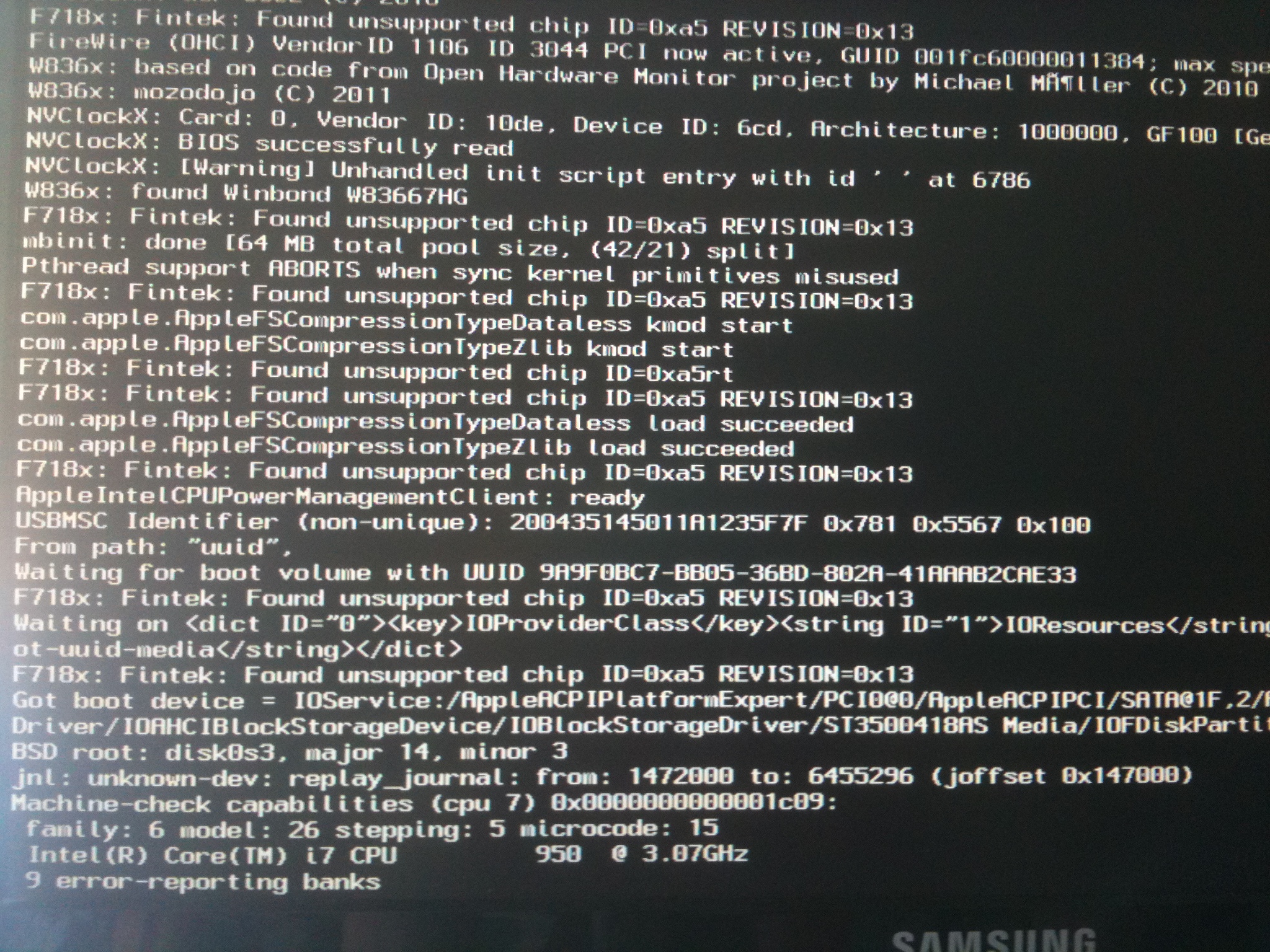

Rackers Posted July 10, 2011 Share Posted July 10, 2011 Hi all, I have an Asus P6X58D-E with the correct DSDT, I thought sleep was working however when I put the computer to sleep for longer than a few minutes it always 'breaks' my install and I can no longer boot into Lion. I get this everytime I try to boot from now on, any ideas on what I have done or how to even fix it? Thanks! Link to comment https://www.insanelymac.com/forum/topic/262045-sleep-broke-my-lion-install-screenshot/ Share on other sites More sharing options...

nexus77777 Posted July 10, 2011 Share Posted July 10, 2011 If you have a working (perhaps Snow ) install, try to re-install Chameleon version 752 and UP.... if not try booting with -f try booting with -x try -v (hum) Re-intall LION.... Sorry... A driver seems needed for your F718x; do not know what it is... Link to comment https://www.insanelymac.com/forum/topic/262045-sleep-broke-my-lion-install-screenshot/#findComment-1712359 Share on other sites More sharing options...
Rackers Posted July 10, 2011 Author Share Posted July 10, 2011 What does those boot flags do? I didn't get that error before my computer failed to sleep, is it possible that the computer failing to sleep has somehow made it come up? Thanks Link to comment https://www.insanelymac.com/forum/topic/262045-sleep-broke-my-lion-install-screenshot/#findComment-1712395 Share on other sites More sharing options...
Noam AA Posted July 11, 2011 Share Posted July 11, 2011 If you have a working (perhaps Snow ) install,try to re-install Chameleon version 752 and UP.... if not try booting with -f try booting with -x try -v (hum) Re-intall LION.... Sorry... A driver seems needed for your F718x; do not know what it is... The F718x is FakeSMC Plugin for monitoring Fintek Sensor. maybe it's not compatible with your board? cause i see a lot of those messages. does istat works for you? if not try removing SuperIOFamily From E/E or S/L/E (where you installed it) try see if there are any differences, i once had to remove NVclockX because i replaced graphic card and i had troubles with waking, but nothing that serious. another question, does your PC wake up from sleep? Link to comment https://www.insanelymac.com/forum/topic/262045-sleep-broke-my-lion-install-screenshot/#findComment-1712631 Share on other sites More sharing options...
Rackers Posted July 11, 2011 Author Share Posted July 11, 2011 iStat seemed to be working when I had it installed. I will try removing that Kext and see how I go. If I set the PC to manual sleep it wakes if I press a button on the keyboard after a minute or so but if I leave it longer than 10 minutes it wakes but no screen .. Link to comment https://www.insanelymac.com/forum/topic/262045-sleep-broke-my-lion-install-screenshot/#findComment-1712805 Share on other sites More sharing options...
nexus77777 Posted July 11, 2011 Share Posted July 11, 2011 iStat seemed to be working when I had it installed. I will try removing that Kext and see how I go. If I set the PC to manual sleep it wakes if I press a button on the keyboard after a minute or so but if I leave it longer than 10 minutes it wakes but no screen .. -v = verbose mode. Basically tells you wants happening during boot up. -x = Safe mode. Basically boots your system with the bare minimum kexts. -s = Single user mode. Command line only mode. Allows you to run commands as root to fix system. -f = Tells the machine to reload all kext and dump the boot configuration cache, (kext cache found in: /System/Library/Extensions.mkext, you can delete it manually and the system will recreate it). .... -v verbose (seems already selected) .... Link to comment https://www.insanelymac.com/forum/topic/262045-sleep-broke-my-lion-install-screenshot/#findComment-1712815 Share on other sites More sharing options...
Rackers Posted July 11, 2011 Author Share Posted July 11, 2011 I removed the f178x kext from SuperIOFamily plugin and all is well once more, I'm guessing that my board doesn't actually require a driver seeing as everything is working as it should! Link to comment https://www.insanelymac.com/forum/topic/262045-sleep-broke-my-lion-install-screenshot/#findComment-1712983 Share on other sites More sharing options...
Noam AA Posted July 11, 2011 Share Posted July 11, 2011 I removed the f178x kext from SuperIOFamily plugin and all is well once more, I'm guessing that my board doesn't actually require a driver seeing as everything is working as it should! glad it worked for you just saw you have winbond not fintek, seems like it really was the problem you can delete everything but W836x to avoid extra issues Link to comment https://www.insanelymac.com/forum/topic/262045-sleep-broke-my-lion-install-screenshot/#findComment-1713096 Share on other sites More sharing options...
