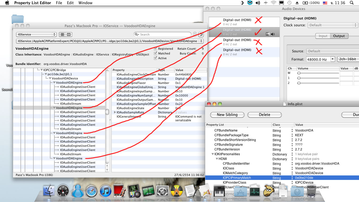

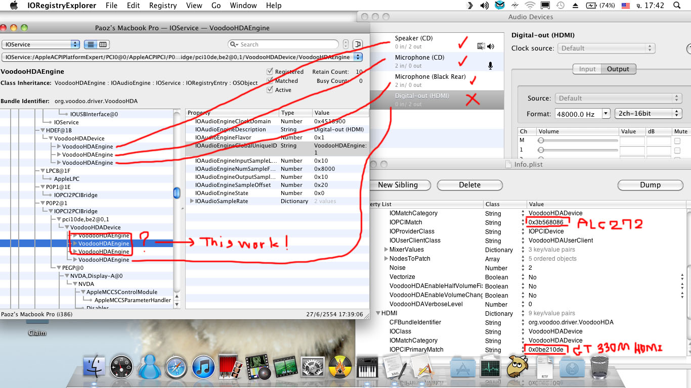

Paoz Posted June 27, 2011 Share Posted June 27, 2011 I have Soundcard : Realtek ALC272X (10EC:0272) that play through Intel Ibex Peak (8086:3b56) and HDMI (10DE:0be2) from nvidia Geforce GT330M (Apple use this card in macbooks too) I found a working kext with merging Info.plist (Thank you to Mr.rals2007 -/\-), It come out good for both device (mics work too) But It doesn't work in the same time = =' It come out like this 1. When I Type only 10DE:0be2 in info.plist to make only HDMI work : [Attached Picture] The HDMI work Great! (only #2 that work) I see that It was recognized as "voodooHDAEngine:1" 2. When I use the merged info.plist to make both of them work in the same time : [Attached Picture] It come out like this; Speaker and two mic input work fine but HDMI out was showed only #4 HDMI which wasn't the worked one So I opened IOregistryExplorer too see if the kext loaded correctly From this, I suggest that it was loaded correctly but the channel "voodooHDAEngine:1" of #2HDMI was replaced by ALC272's Microphone T^T Oh! I think, if I can 1.) change registry of #2HDMI to "voodooHDAEngine:4" (I have already try to change it with IOregistryExplorer but...) or 2.) swap #2HDMI with the #4HDMI channel Please, If you have some idea Please help me -/\- I attach the kexts right here : vvvvvvvvvvvvvvv My_Voodoo.zip Link to comment https://www.insanelymac.com/forum/topic/260896-hdmi-with-soundcard-out-how-to-modify-reg-for-voodoohda/ Share on other sites More sharing options...
