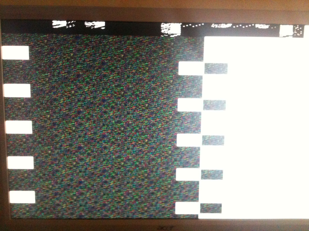

Loloke Posted June 25, 2011 Share Posted June 25, 2011 I use retail installed SL 10.6.7, and all components worked correctly. I recently updated to 10.6.8, and my NVidia 9600GT card is now broken. Anyone have ideas? My config: Gigabyte GA945GCM-S2L, Intel Celeron E1400, Leadtek NV9600GT, 3GB DDR2, 32GB SSD Disk. Some other infos: It worked by custom EFI string, now i tried NVenabler, and DSDT too, but isn't working. I attached a "screenshot", how it looks like now: (sry for my bad english) Link to comment https://www.insanelymac.com/forum/topic/260749-1068-update-broke-my-nvidia-9600-gt/ Share on other sites More sharing options...

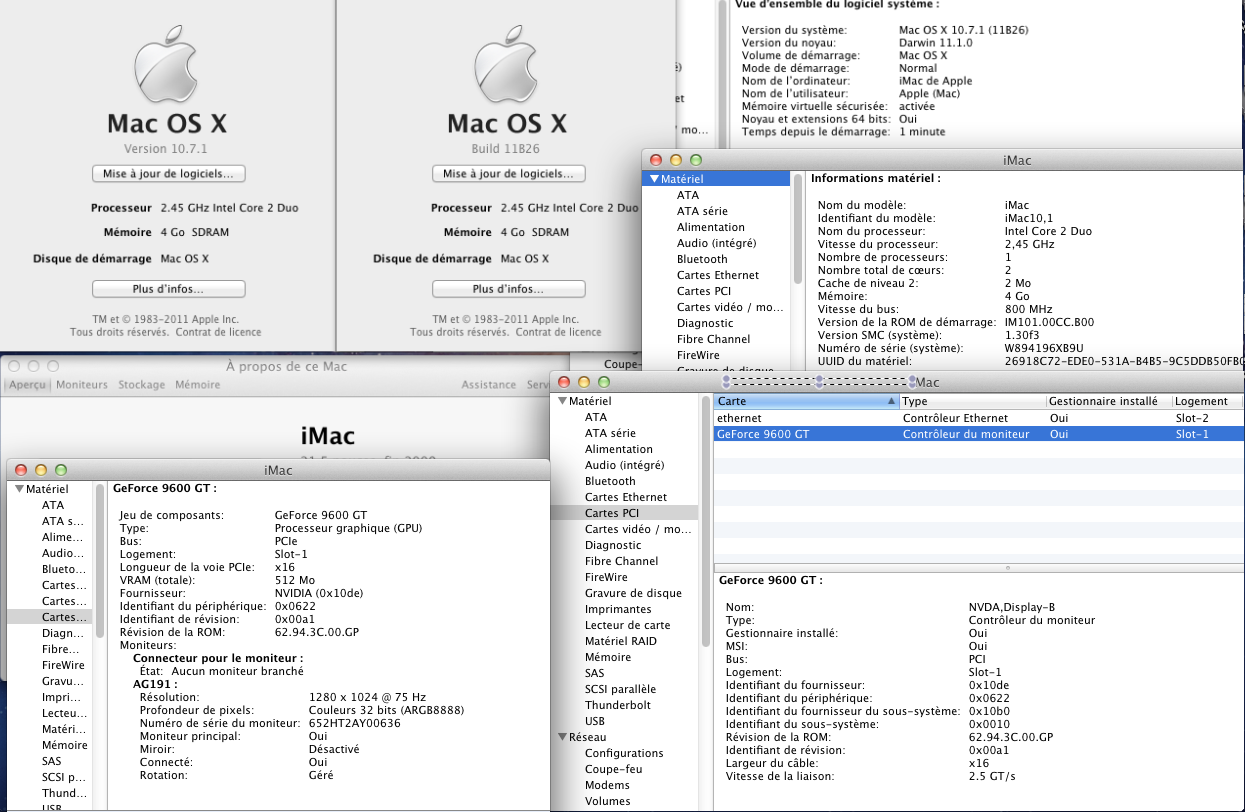

Fabio1971 Posted September 9, 2011 Share Posted September 9, 2011 Same problem again, but on 10.7.0... Any ideas? The 9600GT video card is recognized natively only with this: <key>GraphicsEnabler</key> <string>Yes</string> I apologize for my English Link to comment https://www.insanelymac.com/forum/topic/260749-1068-update-broke-my-nvidia-9600-gt/#findComment-1746493 Share on other sites More sharing options...
fantomas Posted September 10, 2011 Share Posted September 10, 2011 hi if you do this, you'll gone have the same problem like Loloke ! The solution is the same like for 10.6.8 ( normal, the same drivers ), using the kexts from 10.6.7 like it say "sergiy.gagarin" ! After copy kexts from 10.6.7 ( in S/E/E ), then use <key>GraphicsEnabler</key> <string>Yes</string> and then you'll gonna have QE/CI ! Link to comment https://www.insanelymac.com/forum/topic/260749-1068-update-broke-my-nvidia-9600-gt/#findComment-1746761 Share on other sites More sharing options...
Fabio1971 Posted September 11, 2011 Share Posted September 11, 2011 Hello I did not understand what you mean but I did not use any kext Again, I just added this: <key>GraphicsEnabler</key> <string>Yes</string> Link to comment https://www.insanelymac.com/forum/topic/260749-1068-update-broke-my-nvidia-9600-gt/#findComment-1747012 Share on other sites More sharing options...
fantomas Posted September 11, 2011 Share Posted September 11, 2011 good for you ! Link to comment https://www.insanelymac.com/forum/topic/260749-1068-update-broke-my-nvidia-9600-gt/#findComment-1747043 Share on other sites More sharing options...
