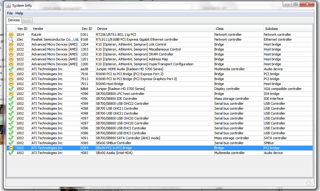

mauro123_as Posted June 21, 2011 Author Share Posted June 21, 2011 So, now it works, its rare, I click "chek compatibilty..." and in some it marks me a "tick" in other a , so now what I can try? Look the image, that is what I get on the app... Quote Link to comment Share on other sites More sharing options...
Dellmantt Posted June 21, 2011 Share Posted June 21, 2011 Search for a boot CD with SATA controller kexts for your MB http://www.google.com.au/search?hl=en&...0l241l241l2-1l1 Quote Link to comment Share on other sites More sharing options...
