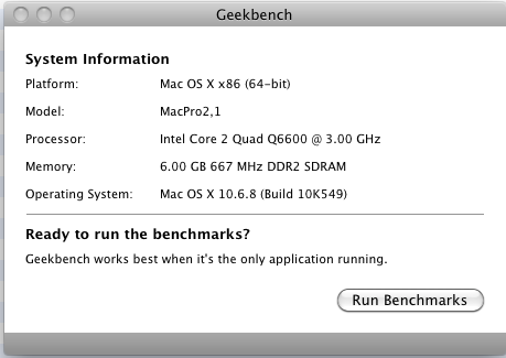

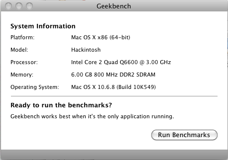

verdant Posted July 27, 2011 Share Posted July 27, 2011 If geekbench reports your System Model as Hackintosh then there is a high probability that you will not be able to download lion via the app store Unfortunately it does: Link to comment https://www.insanelymac.com/forum/topic/258859-nforce-sata-p5n-d-and-lion/#findComment-1724098 Share on other sites More sharing options...
Kilopopo Posted July 27, 2011 Share Posted July 27, 2011 Unfortunately it does: I was reading a link that you posted on your nforce sl installation tutorial. It has the geekbench tip that i told you about. Link to comment https://www.insanelymac.com/forum/topic/258859-nforce-sata-p5n-d-and-lion/#findComment-1724128 Share on other sites More sharing options...
OMEGA_RAZER Posted July 27, 2011 Share Posted July 27, 2011 Okay, here is how I got from SL to Lion, it's not really anything special though. If you want to read the entire nothing to SL to Lion install it's at http://osx.omegarazer.ca Let me know if this works for you cause I'm surprised myself that it worked for me and if you guys see any issues with the kexts I have or think there might be a new version of one i have feel free to let me know You'll need a 8GB USB key and the lion install files. *** Preping to upgrade to Lion from Snow Leopard *** 1) Restore the BaseSystem.dmg to a USB key 2) Copy the Packages folder from InstallESD.dmg to System/Installation/ on your USB key 3) Install Chameleon RC5 752 from here on your USB key 4) Copy your /Extra folder to your USB key (You don't need the Themes folder) 5) Copy these files from InstallESD.dmg to the root of your USB key 5A) .disk_label, boot.efi, kernelcache, mach_kernel, MacOSX_Media_Background.png 6) Put the modified OSInstall.pkg from here into System/Installation/Packages on your USB key *** Upgrading from Snow Leopard to Lion *** 1) Restart and boot to the USB key (found I ran into problems letting chameleon on my SL install boot it) 2) Upgrade over your Snow Leopard install *** Issues I ran into *** 1) after my first boot into Lion after the upgrade I got stuck after the DSMOS arrived 1A) For this I rebooted my Lion key and repaired permissions on my install 2) Booting got a bit further but stalled again (can't remember the line, sorry) 2A) To fix this oddly I redid the upgrade and all was well *** Current issues *** 1) Random freezes, completely and totally random, no idea why 2) Shutdown and reboot don't work for me (Most likely I don't have the right kexts) I think that's it really. Here is a list of the kexts I'm using (I may miss a few by accident) /Extra/Extensions/ AppleNForceATA.kext Disabler.kext ElliotForceLegacyRTC.kext EvOreboot.kext FakeSMC.kext /System/Library/Extensions/ VoodooHDA.kext Link to comment https://www.insanelymac.com/forum/topic/258859-nforce-sata-p5n-d-and-lion/#findComment-1724146 Share on other sites More sharing options...
verdant Posted July 28, 2011 Share Posted July 28, 2011 I was reading a link that you posted on your nforce sl installation tutorial. It has the geekbench tip that i told you about. Even when Geekbench shows my system as a MacPro2,1 it makes no difference...... I need to try out on my system a complete MacPro3,1 or MacPro4,1 SMBIOS.plist that has worked with Geekbench and App Store for anyone...... Link to comment https://www.insanelymac.com/forum/topic/258859-nforce-sata-p5n-d-and-lion/#findComment-1724597 Share on other sites More sharing options...
