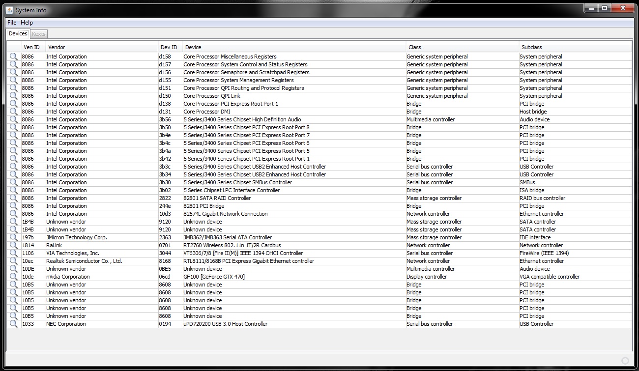

gotmilk70 Posted June 2, 2011 Share Posted June 2, 2011 After a LOT of trial and error, I got my rig to boot SL. It works for the most part, there are a few things that I have issues with. If anyone would be so kind as to help me resolve them, that would be really nice. First, I bought a Rocketfish RF-MBTAD USB bluetooth adapter, and I read that It was supported by mac. I got bluetooth OOB, But I can not set it to wake up from sleep. The check box is greyed out. I'm typing this from the apple wireless keyboard and the magic trackpad . I also have a problem with the Graphics. I get full resolution on my monitors, but when i watch a video, it stutters like crazy. Any video. I saw in the system profiler that there is an unidentifiable nvidia card installed with 0MB ram. The Audio is also weird, I Played back several mp3's from itunes and they all have popping and crackling noises during playback. I have (supposedly) VoodooHDA's latest installed. but it says i have no audio devices installed. Here are my system specs : Intel Core i5-750 clocked at 3.81Ghz (Stock is 2.66Ghz) ASUS P7P55D-E Pro LGA 1156 Intel P55 MotherBoard (Which also happens to have SATA 3 and USB 3.0) 4GB Kingston DDR3 PC1333 RAM (@ 9-9-9-24) PNY Nvidia Geforce GTX 470 1280MB GDDR5 GPU (PCI-E 2.0 x16) (Clocked at 700Mhz/1400Mhz vs stock 600Mhz/1300Mhz) HP 24X DVD+-RW SATA ODD 2x250GB Western Digital RE3 in RAID-0 Configuration (Using the MoBo's Built in Intel RAID Controller) Antec True Power Quattro 850 PSU My Ethernet adapter built in my board died :/ so I added an Intel EXPI9301CTBLK that I ordered from Newegg. If that is not compatible, I have a Netgear WG311 V3 that I bought for my laptop specifically for OSX86. VIA VT1828S 8-Channel Audio Chipset It also has a SATA 3 Controller From Marvell, not sure of the model off hand. Any input would be greatly helpful. Thank everyone in advance. Link to comment Share on other sites More sharing options...

Hackintosh2000 Posted June 2, 2011 Share Posted June 2, 2011 I also have a problem with the Graphics. I get full resolution on my monitors, but when i watch a video, it stutters like crazy. Any video. I saw in the system profiler that there is an unidentifiable nvidia card installed with 0MB ram. Do you have the tonymac nvidia update installed? Might want to try that. Try Chimera as well. Just download the latest Chimera only installer. You don't need [url="http://www.insanelymac.com/forum/topic/279450-why-insanelymac-does-not-support-tonymacx86/"]#####[/url]. I didn't read your whole post. Are you using GraphicsEnabler=Yes? If so stick with that and install Chimera and then the tonymac nvidia update. If that still doesn't work for you then remove GraphicsEnabler=Yes and do a manual EFI injection. You will need OSx86 tools. Read my thread detailing how to make a custom EFI for the nVidia 210 1 GB. Just adapt my instructions for your card. Don't copy my EFI string. It will not work. Let me know whether this helps. Link to comment Share on other sites More sharing options...

gotmilk70 Posted June 3, 2011 Author Share Posted June 3, 2011 Thank you everyone for your input! I purchased a USB "C-Media based" sound card from new egg for $10 that supposedly works out of the box. I really am not worried of sound right now. I also don't have a SATA 3 hard drive, so SATA 3 is also not important. (maybe later I will get one? but I am also assuming there hopefully would be a solution?) I already (I think) got USB 3.0 to work. Ethernet also works out of the box. My main issues are the bluetooth wake from sleep issue and the nvidia graphics card issue. If I can find a solution to the bluetooth wake from sleep issue, that would be great, but the more important issue is video. It stutters like mad in hulu or any video. I have Chimera 1.4.1 installed I believe. GraphicsEnabler=Yes is already enabled also. From a fresh install, I updated to 10.6.7, then ran [url="http://www.insanelymac.com/forum/topic/279450-why-insanelymac-does-not-support-tonymacx86/"]#####[/url], then ran the tonymac nvidia update 2.0 and restarted, I was not even getting full res. I re ran [url="http://www.insanelymac.com/forum/topic/279450-why-insanelymac-does-not-support-tonymacx86/"]#####[/url] and this time installed the NVEnabler, now i get full res, but it still does not identify itself properly. I will have a perfect setup if I can solve these minor issues, and I will be forever in your thanks if you can help point me in the way. )) hackintosh and rlf, i will try your methods and see if it will work. Thanks in advance for everything! Link to comment Share on other sites More sharing options...
Hackintosh2000 Posted June 3, 2011 Share Posted June 3, 2011 I have Chimera 1.4.1 installed I believe. GraphicsEnabler=Yes is already enabled also. From a fresh install, I updated to 10.6.7, then ran [url="http://www.insanelymac.com/forum/topic/279450-why-insanelymac-does-not-support-tonymacx86/"]#####[/url], then ran the tonymac nvidia update 2.0 and restarted, I was not even getting full res. I re ran [url="http://www.insanelymac.com/forum/topic/279450-why-insanelymac-does-not-support-tonymacx86/"]#####[/url] and this time installed the NVEnabler, now i get full res, but it still does not identify itself properly. I will have a perfect setup if I can solve these minor issues, and I will be forever in your thanks if you can help point me in the way. )) hackintosh and rlf, i will try your methods and see if it will work. Thanks in advance for everything! Please remove the NVEnabler kext, remove GraphicsEnabler=yes, and try my EFI string injection method. It worked for me when nothing else worked. The problem for me was I was using a 1 GB card. It simply would not be recognized until I did the manual EFI injection. Once I did that it worked beautifully. Actually it wasn't my computer. I gave it to a non-tech friend and they are loving their hack. Please try my method and let me know if it works. Link to comment Share on other sites More sharing options...
gotmilk70 Posted June 3, 2011 Author Share Posted June 3, 2011 I got the video working properly! Thank you very much! You are the man. It now sees the card as a Geforce GTX 470. It also has 1GB VRAM. The card itself has 1280MB ram I think, but I will not really care much about the 280MB missing lmao. What really matters is, no stutter issues. I also tried to patch my ethernet card, which allows me to still go online, but does not give further detail like the guy that patched it in the other post above had. I love my new Mac, and I also love this community! It really would not be possible without you all. I need to figure out a way to effectively patch my ethernet card and my bluetooth adapter. The ethernet card to show the extra detail in system profiler, and the bluetooth to allow wake from sleep from my wireless keyboard and mouse. Any help will be greatly thanked and very much welcome! Thank you again for guiding me in getting my Graphics card working properly! Link to comment Share on other sites More sharing options...
Hackintosh2000 Posted June 4, 2011 Share Posted June 4, 2011 I got the video working properly! Thank you very much! You are the man. It now sees the card as a Geforce GTX 470. It also has 1GB VRAM. The card itself has 1280MB ram I think, but I will not really care much about the 280MB missing lmao. What really matters is, no stutter issues. I also tried to patch my ethernet card, which allows me to still go online, but does not give further detail like the guy that patched it in the other post above had. I love my new Mac, and I also love this community! It really would not be possible without you all. I need to figure out a way to effectively patch my ethernet card and my bluetooth adapter. The ethernet card to show the extra detail in system profiler, and the bluetooth to allow wake from sleep from my wireless keyboard and mouse. Any help will be greatly thanked and very much welcome! Thank you again for guiding me in getting my Graphics card working properly! Congratulations! Sooo... what got it working? Did you do the custom EFI method? If you did the custom EFI method how much ram did you enter in the VRAM dialog box? I entered 1024 Mb (1 Gb), because that's what I had. There is a custom button if you need to enter some other amount. I've never used it before. I would be curios to see if it works. Link to comment Share on other sites More sharing options...
gotmilk70 Posted June 4, 2011 Author Share Posted June 4, 2011 The custom EFI did. As for the ram, I put in 1GB. I really have 1280MB but I didn't know how to enter it in to the custom field. If I can find out what numbers to put it in, I would also want to try it out. Link to comment Share on other sites More sharing options...
