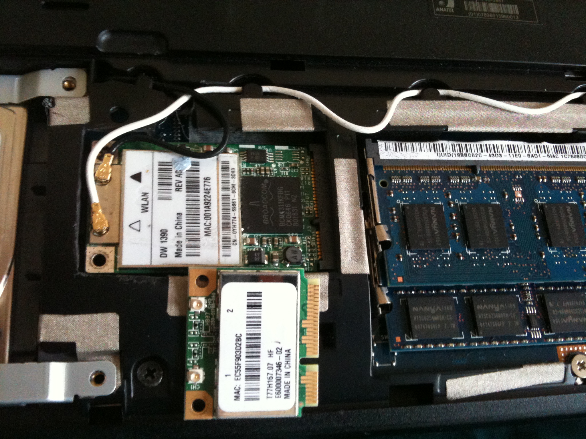

Acro_Design Posted May 29, 2011 Share Posted May 29, 2011 Hey all i have moded my acer 5750 and cut out the bay so i can retrofit larger cards like my spare dell mini 1390. the cut out worked well and looks factory, anyway having installed the card it worked straight away. like it should, no kext required, i then proceeded to update to 10.6.7 combo and then it didnt work. i retained the 10.6.7 iopcifamily.kext from 10.6.3 and ionetworkfamily.kext hoping this may restore functionality. nothing happened. so next i found the kext for the dell mini/ Broadcom 4311. looking in the plist 4311 is already there. i added the kext to extensions as normal. repaired permissions as normal. yet the card still doesnt work. however the orange light flashes on my wifi LED that sugests there may be life. next i tried the various sudo blah blah blah stuff assosiated with io8011familykext... so then i spent half the night researching this issue until my eyes went all blurry. i found installed a modded pci kext and that caused a kernal panic.. i have nothing to backup so i have to start again... i now need an asprin and some help with this card / pci e slot / acer issue Link to comment https://www.insanelymac.com/forum/topic/258050-acer-5750-moded-bay-to-fit-dell-mini-1390broadcom-4311/ Share on other sites More sharing options...

Acro_Design Posted May 29, 2011 Author Share Posted May 29, 2011 oh by the way if anyones interested, i am a big fan of retofitting laptops with compatible parts, so that usually means cutting them up. heres the pic card fitted is the dell card. card bellow is OEM athros card. acer made the day so it would only fit these small cards (forgive me but i havent seen many like that) my new acer, was cut up within the hour of purchase... ha ha. anyway until i can work out what card might be suitable. i will stay in 10.6.3 would a mac airport card work, im getting mixed responces in search and am very tempted by this http://www.amazon.co.uk/802-11n--Replaceme...4186&sr=8-9 Link to comment https://www.insanelymac.com/forum/topic/258050-acer-5750-moded-bay-to-fit-dell-mini-1390broadcom-4311/#findComment-1690141 Share on other sites More sharing options...
Acro_Design Posted May 29, 2011 Author Share Posted May 29, 2011 10.6.6 works so thats good enough for now it would have been nice to know what cards work with 10.6.7 looking at the suported card list it say very little about each card owners version of os x thus making it even harder to work with. Oh yes i forgot.. Disclaimer if your not crazzy like me please dont cut up a brand new laptop for ease of access! i do not recomend what i have done as i have much experiance with cutting tools and such where as you the other crazzy person may not. if your not sure how good you are with a dremal dont do this! my headache has gone so this was a successful day Link to comment https://www.insanelymac.com/forum/topic/258050-acer-5750-moded-bay-to-fit-dell-mini-1390broadcom-4311/#findComment-1690236 Share on other sites More sharing options...
