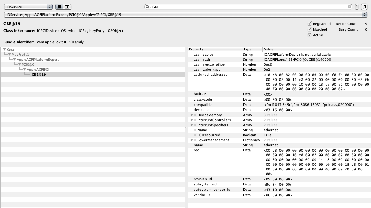

LatinMcG Posted June 3, 2011 Share Posted June 3, 2011 put back to original with no mod in lan then use ioregexplorer to see what it shows. screenshot ? post your dsdt also. and model of mobo.( rev) i think 0x0B is wrong one to use. Link to comment https://www.insanelymac.com/forum/topic/257496-patch-dsdt-for-jmb362-in-ahci-mode/#findComment-1692359 Share on other sites More sharing options...
stradivari1723 Posted June 3, 2011 Author Share Posted June 3, 2011 Screenshot of Intel Gigabit NIC entry in ioreg with no mod in DSDT:DSDT I am currently using, with Device(JMB0) and Device(JMB1) entries modified to get AHCI working, PINI method to restore registers for JMB, and PINI() call in _WAK to restore AHCI mode upon wake, and finally (of course) the DTGP method for hacks. LAN is untouched:dsdt.aml.zipMotherboard is Asus P8P67 Pro Rev. 3.0 B3Let me know if I've missed anything... Link to comment https://www.insanelymac.com/forum/topic/257496-patch-dsdt-for-jmb362-in-ahci-mode/#findComment-1692492 Share on other sites More sharing options...

LatinMcG Posted June 5, 2011 Share Posted June 5, 2011 this is your GBE Device (GBE) { Name (_ADR, 0x00190000) Method (_PRW, 0, NotSerialized) { Return (GPRW (0x0D, 0x04)) } } change 0x04 to 0x05 ? is it intel or realtek ??? lookin in your dsdt i was wondering of your OSFL aka osvr in this asus. Name (OSVR, Ones) Method (OSFL, 0, NotSerialized) { If (LNotEqual (OSVR, Ones)) { Return (OSVR) } If (LEqual (PICM, Zero)) { Store (0xAC, DBG8) } Store (One, OSVR) If (CondRefOf (_OSI, Local0)) { If (_OSI ("Linux")) { Store (0x03, OSVR) } If (_OSI ("Windows 2001")) { Store (0x04, OSVR) } If (_OSI ("Windows 2001.1")) { Store (0x05, OSVR) } If (_OSI ("Darwin")) { Store (0x06, OSVR) } If (_OSI ("HP-UX")) { Store (0x07, OSVR) } If (_OSI ("OpenVMS")) { Store (0x08, OSVR) } If (_OSI ("Windows 2001 SP1")) { Store (0x09, OSVR) } If (_OSI ("Windows 2001 SP2")) { Store (0x0A, OSVR) } If (_OSI ("Windows 2001 SP3")) { Store (0x0B, OSVR) } If (_OSI ("Windows 2006")) { Store (0x0C, OSVR) } If (_OSI ("Windows 2006 SP1")) { Store (0x0D, OSVR) } If (_OSI ("Windows 2009")) { Store (0x0E, OSVR) } } Else { If (MCTH (_OS, "Microsoft Windows NT")) { Store (Zero, OSVR) } If (MCTH (_OS, "Microsoft Windows")) { Store (One, OSVR) } If (MCTH (_OS, "Microsoft WindowsME: Millennium Edition")) { Store (0x02, OSVR) } If (MCTH (_OS, "Linux")) { Store (0x03, OSVR) } If (MCTH (_OS, "Dariwn")) { Store (0x06, OSVR) } If (MCTH (_OS, "HP-UX")) { Store (0x07, OSVR) } If (MCTH (_OS, "OpenVMS")) { Store (0x08, OSVR) } } Return (OSVR) } its missing Darwin .. try replacing "FreeBSD"or or "Windows 2006" with "Darwin" Link to comment https://www.insanelymac.com/forum/topic/257496-patch-dsdt-for-jmb362-in-ahci-mode/#findComment-1693145 Share on other sites More sharing options...
stradivari1723 Posted June 6, 2011 Author Share Posted June 6, 2011 Tried that. No good. is it intel or realtek ??? Intel. lookin in your dsdt i was wondering of your OSFL aka osvr in this asus.Name (OSVR, Ones) Method (OSFL, 0, NotSerialized) { If (LNotEqual (OSVR, Ones)) { Return (OSVR) } If (LEqual (PICM, Zero)) { Store (0xAC, DBG8) } Store (One, OSVR) If (CondRefOf (_OSI, Local0)) { If (_OSI ("Linux")) { Store (0x03, OSVR) } If (_OSI ("Windows 2001")) { Store (0x04, OSVR) } If (_OSI ("Windows 2001.1")) { Store (0x05, OSVR) } If (_OSI ("FreeBSD")) { Store (0x06, OSVR) } If (_OSI ("HP-UX")) { Store (0x07, OSVR) } If (_OSI ("OpenVMS")) { Store (0x08, OSVR) } If (_OSI ("Windows 2001 SP1")) { Store (0x09, OSVR) } If (_OSI ("Windows 2001 SP2")) { Store (0x0A, OSVR) } If (_OSI ("Windows 2001 SP3")) { Store (0x0B, OSVR) } If (_OSI ("Windows 2006")) { Store (0x0C, OSVR) } If (_OSI ("Windows 2006 SP1")) { Store (0x0D, OSVR) } If (_OSI ("Windows 2009")) { Store (0x0E, OSVR) } } Else { If (MCTH (_OS, "Microsoft Windows NT")) { Store (Zero, OSVR) } If (MCTH (_OS, "Microsoft Windows")) { Store (One, OSVR) } If (MCTH (_OS, "Microsoft WindowsME: Millennium Edition")) { Store (0x02, OSVR) } If (MCTH (_OS, "Linux")) { Store (0x03, OSVR) } If (MCTH (_OS, "FreeBSD")) { Store (0x06, OSVR) } If (MCTH (_OS, "HP-UX")) { Store (0x07, OSVR) } If (MCTH (_OS, "OpenVMS")) { Store (0x08, OSVR) } } Return (OSVR) } its missing Darwin .. try replacing "FreeBSD"or or "Windows 2006" with "Darwin" Does that actually affect anything, though? I can change it and try...Edit: replaced 0x04 with 0x05, and replaced FreeBSD with Darwin. Doesn't seem to change anything. :-\ BTW, wake itself works great. Just WOL I'm trying to get working, now. And it's not my network... my hackintosh can WOL my MacBook Pro.I'm wondering if it's a software/driver issue... I'm bothered by the fact that my MacBook Pro has "Wake on network access" option in Energy Saver, but my Hackintosh does not... Link to comment https://www.insanelymac.com/forum/topic/257496-patch-dsdt-for-jmb362-in-ahci-mode/#findComment-1693429 Share on other sites More sharing options...
