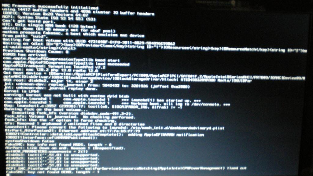

b1gdadd1 Posted May 1, 2011 Share Posted May 1, 2011 ok now i made some sense out of the info i got...i says unable to find driver for this platform \ACPI\ etc etc....., try booting with: -v cpus=1 busratio=16 Link to comment https://www.insanelymac.com/forum/topic/256075-installation-problem-on-acer-5740/#findComment-1677356 Share on other sites More sharing options...
akshaiv Posted May 2, 2011 Author Share Posted May 2, 2011 now i am getting disk0s2 : ioctl (' ',51,0) is unsupported. disk0s3 : ioctl (' ',51,0) is unsupported. disk0s1 : ioctl (' ',51,0) is unsupported. disk0s2 : ioctl (' ',51,0) is unsupported. disk0s3 : ioctl (' ',51,0) is unsupported. and then disk activity stops. using the chameleon bootloader this time. Link to comment https://www.insanelymac.com/forum/topic/256075-installation-problem-on-acer-5740/#findComment-1677629 Share on other sites More sharing options...
b1gdadd1 Posted May 2, 2011 Share Posted May 2, 2011 1 - now i am gettingdisk0s2 : ioctl (' ',51,0) is unsupported. disk0s3 : ioctl (' ',51,0) is unsupported. disk0s1 : ioctl (' ',51,0) is unsupported. disk0s2 : ioctl (' ',51,0) is unsupported. disk0s3 : ioctl (' ',51,0) is unsupported. and then disk activity stops. 2 - using the chameleon bootloader this time. 1 - i'm guessing those are msdos partitions. how many partitions did you make? which file system did you select when you repartitioned your HDD? MBR or GPT? 2 - did you reinstall again? does that happen after you've completed your installation? i think what you need to do here is to try and recreate the condition that you had when you first posted here. install it again (and you probably will reinstall over and over.... until you get it right) boot your hazard dvd with these - "-v cpus=1 busratio=16" (cpus=1 might not be necessary but to be safe) using diskutility, partition your HDD using GPT. make two partitions - one hfs journaled and the other msdos-fat (for windows 7 later i suppose) select custom install and write down your selected options: kernels - legacy kernel or none selected (vanila kernel 10.6.6??? not sure about this) boot loaders - chameleon rc5 (your choice here but select only one) boot options - none (you can add boot flags when you boot later) graphics drivers - none audio drivers - ???? (if you remember your very first selection when you had music playing in the background) network drivers - atheros_fix???? (not sure if your wifi is supported) laptop support - voodoops2 trackpad and battery??? cmos reset fix - applertc??? (if your cmos keeps getting erased or corrupted) sata_ata fix - ahci sata fix??? (try this one first) patches: evoreboot or openhaltrestart fakesmc v.1.0 or unselected (defaults to later version???) about this mac??? remember, this is not guaranteed to work. it's a pain installing OSX on a branded dekstop pc and even more on a laptop. but if you keep track of you did, it makes it a bit easier (yes, only just a bit!) Link to comment https://www.insanelymac.com/forum/topic/256075-installation-problem-on-acer-5740/#findComment-1677661 Share on other sites More sharing options...
akshaiv Posted May 2, 2011 Author Share Posted May 2, 2011 1 - i'm guessing those are msdos partitions. how many partitions did you make? which file system did you select when you repartitioned your HDD? MBR or GPT? 2 - did you reinstall again? does that happen after you've completed your installation? i think what you need to do here is to try and recreate the condition that you had when you first posted here. install it again (and you probably will reinstall over and over.... until you get it right) boot your hazard dvd with these - "-v cpus=1 busratio=16" (cpus=1 might not be necessary but to be safe) using diskutility, partition your HDD using GPT. make two partitions - one hfs journaled and the other msdos-fat (for windows 7 later i suppose) select custom install and write down your selected options: kernels - legacy kernel or none selected (vanila kernel 10.6.6??? not sure about this) boot loaders - chameleon rc5 (your choice here but select only one) boot options - none (you can add boot flags when you boot later) graphics drivers - none remember, this is not guaranteed to work. it's a pain installing OSX on a branded dekstop pc and even more on a laptop. but if you keep track of you did, it makes it a bit easier (yes, only just a bit!) 1)I already had a windows 7 installation. So the partition is MBR. There are three partitions.2 of NTFS and one of MAC Journaled FS. Do i need to format the hdd and install mac first and the windows 7 later? if so i guess i have to partition with GPT. 2)I have tried to install atleast 10 times now, trying all the permutations and combinations, but i guess the disk error apperas all the time. I unselected all the drivers, but i made sure i used the legacy kernel. i have tried these boot flags when i get into the hazard DVD -v cpus=2 busratio=16 arch=i386 as i said it installs successfully everytime but after it reboots, it either gets stuck at the apple logo if i do not use verbose mode or at the errors i mentioned above. audio drivers - ???? (if you remember your very first selection when you had music playing in the background) laptop support - voodoops2 trackpad and battery??? cmos reset fix - applertc??? (if your cmos keeps getting erased or corrupted) sata_ata fix - ahci sata fix??? (try this one first) patches: evoreboot or openhaltrestart fakesmc v.1.0 or unselected (defaults to later version???) about this mac??? I used the kext provided by voodoo for the sound. I guess Realtek is not supported. I am a little bit concerned about the CMOS getting corrupted, it has not happened until now, so do you think i should use that fix? could you please tell me what is applertc, evoreboot, openhaltrestart and fakesmc? thankyou for your time... Link to comment https://www.insanelymac.com/forum/topic/256075-installation-problem-on-acer-5740/#findComment-1677673 Share on other sites More sharing options...
b1gdadd1 Posted May 2, 2011 Share Posted May 2, 2011 A - I already had a windows 7 installation. So the partition is MBR. There are three partitions.2 of NTFS and one of MAC Journaled FS. Do i need to format the hdd and install mac first and the windows 7 later? if so i guess i have to partition with GPT.B - I have tried to install atleast 10 times now, trying all the permutations and combinations, but i guess the disk error apperas all the time. I unselected all the drivers, but i made sure i used the legacy kernel. C - as i said it installs successfully everytime but after it reboots, it either gets stuck at the apple logo if i do not use verbose mode or at the errors i mentioned above. D - I used the kext provided by voodoo for the sound. I guess Realtek is not supported. E - I am a little bit concerned about the CMOS getting corrupted, it has not happened until now, so do you think i should use that fix? could you please tell me what is applertc, F - evoreboot, openhaltrestart and G - fakesmc? A - Yes, format your HDD with GPT file system - one HFS journaled and the other MSDOS-FAT. You can worry about installing Windows 7 and dual booting later. B - For now, just use the legacy kernel. I don't think that's the issue at the moment. C - This could be related to E. D - VoodooHDA sometimes can cause kernel panic. Don't select any audio drivers for the moment. E - If your BIOS keeps getting corrupted, then probably your SATA setup keeps defaulting to another value other than AHCI. Use either AppleRTC or another one to fix it. You can also patch your DSDT table but I won't go into detail about it. F - basically either one fixes reboot/restart/shutdown problem of snow leopard. check this link http://www.osx86.es/?p=749 G - check this link http://netkas.org/?p=141 and lastly, always boot verbose mode so you can see what's happening. it would be easier to help you if you take a picture of a kernel panic or when the boot process stops. Link to comment https://www.insanelymac.com/forum/topic/256075-installation-problem-on-acer-5740/#findComment-1677730 Share on other sites More sharing options...
akshaiv Posted May 3, 2011 Author Share Posted May 3, 2011 A - Yes, format your HDD with GPT file system - one HFS journaled and the other MSDOS-FAT. You can worry about installing Windows 7 and dual booting later. B - For now, just use the legacy kernel. I don't think that's the issue at the moment. C - This could be related to E. D - VoodooHDA sometimes can cause kernel panic. Don't select any audio drivers for the moment. E - If your BIOS keeps getting corrupted, then probably your SATA setup keeps defaulting to another value other than AHCI. Use either AppleRTC or another one to fix it. You can also patch your DSDT table but I won't go into detail about it. F - basically either one fixes reboot/restart/shutdown problem of snow leopard. check this link http://www.osx86.es/?p=749 G - check this link http://netkas.org/?p=141 and lastly, always boot verbose mode so you can see what's happening. it would be easier to help you if you take a picture of a kernel panic or when the boot process stops. new problem it now shows setWOW_PARAMETERS : wowevents = 2(1) disk0s3 : ioctl ('',51,0) is unsupported. disk0s3 : ioctl ('',51,0) is unsupported. disk0s4 : ioctl ('',51,0) is unsupported. disk0s4 : ioctl ('',51,0) is unsupported. fakesmc: key not found BEMB, length - 1 and here is a snapshot of the error Link to comment https://www.insanelymac.com/forum/topic/256075-installation-problem-on-acer-5740/#findComment-1678256 Share on other sites More sharing options...
b1gdadd1 Posted May 3, 2011 Share Posted May 3, 2011 new problem it now shows ....setWOW_PARAMETERS : wowevents = 2(1) disk0s3 : ioctl ('',51,0) is unsupported. disk0s3 : ioctl ('',51,0) is unsupported. disk0s4 : ioctl ('',51,0) is unsupported. disk0s4 : ioctl ('',51,0) is unsupported. fakesmc: key not found BEMB, length - 1 after completing installation, did you boot with "-v cpus=1 arch=i386 busratio=16" which you used to boot the hazard dvd? if not, try it. if that does not work try it again but with this "-v -x cpus=1 busratio=16 arch=i386". if still not ok, try this for last "-s cpus=1 busratio=16 arch=i386" (cpus, busratio, i386 might not be necessary to boot into single-user mode but try it anyway) Link to comment https://www.insanelymac.com/forum/topic/256075-installation-problem-on-acer-5740/#findComment-1678356 Share on other sites More sharing options...
akshaiv Posted May 3, 2011 Author Share Posted May 3, 2011 after completing installation, did you boot with "-v cpus=1 arch=i386 busratio=16" which you used to boot the hazard dvd? if not, try it. if that does not work try it again but with this "-v -x cpus=1 busratio=16 arch=i386". if still not ok, try this for last "-s cpus=1 busratio=16 arch=i386" (cpus, busratio, i386 might not be necessary to boot into single-user mode but try it anyway) i tried all...i did get into the single user mode..i guess it is used to change the files...it still does not work..any other solutions? Link to comment https://www.insanelymac.com/forum/topic/256075-installation-problem-on-acer-5740/#findComment-1678362 Share on other sites More sharing options...
b1gdadd1 Posted May 3, 2011 Share Posted May 3, 2011 i tried all...i did get into the single user mode..i guess it is used to change the files...it still does not work..any other solutions? i was hoping that at least you'd be able to boot into single-user mode. but are you familiar with terminal commands? because you need to install some kexts, files and whatnot to get your hazard working. Link to comment https://www.insanelymac.com/forum/topic/256075-installation-problem-on-acer-5740/#findComment-1678373 Share on other sites More sharing options...
akshaiv Posted May 3, 2011 Author Share Posted May 3, 2011 i was hoping that at least you'd be able to boot into single-user mode. but are you familiar with terminal commands? because you need to install some kexts, files and whatnot to get your hazard working. sure tell me everything...ill do it now....i am familiar with linux... Link to comment https://www.insanelymac.com/forum/topic/256075-installation-problem-on-acer-5740/#findComment-1678380 Share on other sites More sharing options...
b1gdadd1 Posted May 3, 2011 Share Posted May 3, 2011 sure tell me everything...ill do it now....i am familiar with linux... ok then. let's hope your problem is kernel related. so we do this one first, which is the easiest. get nawcom's latest legacy kernel 10.6.7 here http://dl.nawcom.com/legacy_kernel.10.7.0.bz2. unzip it and copy it to a fat32 formatted usb stick. 1. boot into single user mode - "-x" at boot menu 2. type the following and press Enter after each line /sbin/fsck -fy /sbin/mount -uw / cd / cp mach_kernel mach_kernel_hazard rm mach_kernel then insert your usb stick cd /Volumes/USBLABEL (USBLABEL is your usb stick) cp legacy_kernel.10.7.0 /mach_kernel cd / chown root:wheel /mach_kernel chmod 644 /mach_kernel reboot remember the boot flags! "-v cpus=1 arch=i386 busratio=16" Link to comment https://www.insanelymac.com/forum/topic/256075-installation-problem-on-acer-5740/#findComment-1678441 Share on other sites More sharing options...
