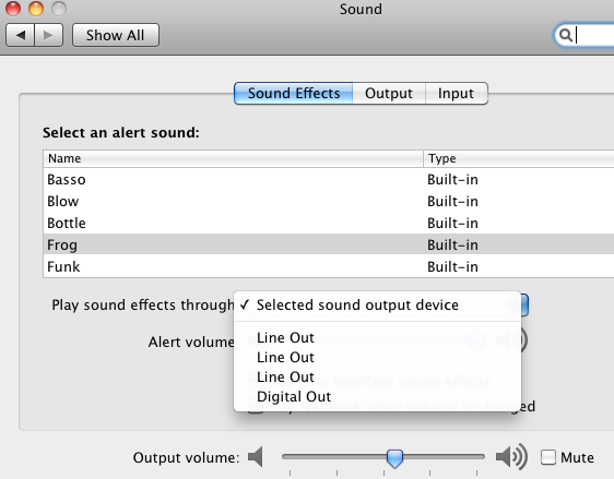

mulcyber Posted April 26, 2011 Share Posted April 26, 2011 YEEEEEEEEEEES. Thanks a lot, mulcyber. Andy's ATi Fix did it. Now I only have to fix that minor audio problem I have: Still I can't get any Sounds out of the Audio/Headset Ports from the motherboard. When I connect my USB Headset, it works perfect. But OSX doesn't want to give me any sound on the lineout... How splendidly Dalmation Lady (101) evil! This is what tonymac had to say about audio and 10.6.7 ----------------------------------------------- "What we know about 10.6.7 so far...http://tonymacx86.blogspot.com/2011/03/mac-os-x-1067-update.html 10.7.0 Darwin kernel (No Sandy Bridge support) No Sandy Bridge Intel HD 2000/3000 Graphics support No ATI 6xxx support BREAKING: Sandy Bridge MBP models receiving separate build of 10.6.7 Most supported systems will not need to make post-installation fixes, but here are a few points to be aware of. Graphics - If you're using a NVIDIA 4xx "Fermi" card, you will have to re-run the tonymacx86 NVIDIA Update to regain full acceleration. Audio - The Combo update will replace your AppleHDA.kext. If you aren't using the ALC889a codec, you will have to reinstall AppleHDA Rollback using [url="http://www.insanelymac.com/forum/topic/279450-why-insanelymac-does-not-support-tonymacx86/"]#####[/url]. If you're using VoodooHDA, you will not need to make any modifications." --------------------------------------- I check for audio information two places. About This Mac --> More info... and the click on Audio (Built in); expand the arrow so that it points down. Mine says Intel High Definition Audio Audio ID: 889 S/PDIF Optical Digital Audio Output: Connection: Internal Line Output: Connection: 1/8-Inch Jack Line Output: Connection: 1/8-Inch Jack Line Output: Connection: 1/8-Inch Jack Line Output: Connection: 1/8-Inch Jack External Microphone / iPhone Headset: ------------------------------------------------- Connection: 1/8-Inch Jack Line Input: Connection: 1/8-Inch Jack Headphone: Connection: 1/8-Inch Jack S/PDIF Optical Digital Audio Output: Connection: Combination Output S/PDIF Optical Digital Audio Input: Connection: Combination Input --------------------------------------------------- What is the audio codec for your motherboard. Is it ALC889 like mine? If it is or whatever it is, the Audio ID: (889) the audio ID: has to match your system to have the right driver. Some drivers that are not written well or are only close to right, will have limitations in their behavior. For instance, I think perhaps the voodoohda* driver will provide limited functionality and can also cause conflicts with other audio drivers and then sometimes ports will work in the back but not in the front. I'm not sure but perhaps with the right audio kext and AppleHDA 10.6.2 rollback, because you have 10.6.7 installed, these kexts may need to be (re-)installed. I don't know if this will fix it. The next place I check audio is under System Preferences -> second row down -> Sound I will attach a screenshot of mine. The thing to notice is if the sound effects like Frog are dark which means they work and I can hear a frog croak (speakers), because if the alert sounds are greyed, they don't work. My screenshot covers up two choices that are checked, Player user interface sound effects and: Play feedback when volume is changed I've found that if these are greyed out (your alert sounds) it means the wrong audio ID (driver) is being used. sudo cp boot / will copy boot to the root directory where you want it, if you issue the command from the folder where the boot file is located. There are quite a few times when you need to use sudo which requires that you know the admin password. I think you will need one. This uses up my meager audio knowledge. Quote Link to comment https://www.insanelymac.com/forum/topic/255517-just-a-simple-beginners-fault/#findComment-1674781 Share on other sites More sharing options...
silliconevil Posted April 27, 2011 Author Share Posted April 27, 2011 a little bit off topic first: since i'm not natively speaking english (you may wonder ), i sometimes have to look up some words or phrases. How splendidly Dalmation Lady (101) evil! I wondered, if you were trying to make fun of my nick name so i asked mister google for that. I still don't know for sure, but I found this very exciting link I have to share with you http://www.yatego.com/trenditionals/p,4d70...dalmatian-lady- Sorry for the little excursion to german fashion, now BACK TO TOPIC!! ---- My soundchip should be the same as yours. The board is Rev. 2, the board's manual and gigabyte website say it is ALC889. And my Audio Setup in System Profiler looks exactly like the one you've posted (btw: i've been workin on Macintosh computers for more than ten years and sometime ago Ifound out that having system profiler as a dock icon is quite helpfull... ). But in the system prefs, there's no output device device detected, unless i connect my USB Headset. If it is connected, all sound are avaiable, if not they're greyed out. I double-checked all the jacks, but i remember having some problems when i ran windows seven on this computer. Somehow the motherboard/win7 recognizes, if there is a plug in the jack or not, if not there is not sound in windows either... Does it work with your board? And another question: is USB3 working on yours? I don't have any device yet, but any USB2.0 HDD should work in the yellow ports on the back, don't they? Quote Link to comment https://www.insanelymac.com/forum/topic/255517-just-a-simple-beginners-fault/#findComment-1675424 Share on other sites More sharing options...
mulcyber Posted April 28, 2011 Share Posted April 28, 2011 a little bit off topic first:since i'm not natively speaking english (you may wonder ), i sometimes have to look up some words or phrases. I wondered, if you were trying to make fun of my nick name so i asked mister google for that. I still don't know for sure, but I found this very exciting link I have to share with you http://www.yatego.com/trenditionals/p,4d70...dalmatian-lady- Sorry for the little excursion to german fashion, now BACK TO TOPIC!! ---- My soundchip should be the same as yours. The board is Rev. 2, the board's manual and gigabyte website say it is ALC889. And my Audio Setup in System Profiler looks exactly like the one you've posted (btw: i've been workin on Macintosh computers for more than ten years and sometime ago Ifound out that having system profiler as a dock icon is quite helpfull... ). But in the system prefs, there's no output device device detected, unless i connect my USB Headset. If it is connected, all sound are avaiable, if not they're greyed out. I double-checked all the jacks, but i remember having some problems when i ran windows seven on this computer. Somehow the motherboard/win7 recognizes, if there is a plug in the jack or not, if not there is not sound in windows either... Does it work with your board? And another question: is USB3 working on yours? I don't have any device yet, but any USB2.0 HDD should work in the yellow ports on the back, don't they? Taking into account your username, I wasn't sure that it would be appropriate to say "Good job!" You might have taken it as an veiled, subtle criticism. So I compromised by saying something obscure. http://en.wikipedia.org/wiki/101_Dalmatians_%281996_film%29 "Cruella de Vil is a fictional character and the primary villain"-> is an "evil" character in a story, but not seriously, it's a Walt Disney movie. Kick-Ball Für alle die den Fussball schon beherschen. all the football already beherschen for. Mit Baumwolle umhäkelt. With crochet cotton. -------------------------------------------------------- I don't have System Profile in the Dock yet but I will. However, I have Terminal as a Desktop icon My posts have been I suppose, to detailed for a user of your experience, but I took my hint from subject:"beginner's fault" and that you posted in the New Users Lounge. I don't have a USB3 device either although I have a port for it. I think that there is a .kext needed to make it work. My headphones work in Windows front and back jacks and the speakers, both at once. I've found that if these are greyed out (your alert sounds) it means the wrong audio ID (driver) is being used. (What driver are you using for the ALC889?) More later... EDIT: removed duplicate screenshot Quote Link to comment https://www.insanelymac.com/forum/topic/255517-just-a-simple-beginners-fault/#findComment-1675606 Share on other sites More sharing options...
mulcyber Posted April 28, 2011 Share Posted April 28, 2011 But in the system prefs, there's no output device device detected, unless i connect my USB Headset. If it is connected, all sound are avaiable, if not they're greyed out. I double-checked all the jacks, but i remember having some problems when i ran windows seven on this computer. Somehow the motherboard/win7 recognizes, if there is a plug in the jack or not, if not there is not sound in windows either... Does it work with your board? The screenshot from last post was from System Preferences --> Sound. One thing I noticed is that there is a ? question mark with information about how to change settings. My headset works with my mobo both front and back jacks, but not both, speakers too, at the same time as it did in Windows. I think it is likely that you have the wrong audio driver installed for Audio ID: 889. In S/L/E, I have AppleHDA.kext installed, and also HDAEnabler889.kext installed. I have seen an AppleHDA889.kext(.zip) floating around, but I don't have that installed. I had a big conflict with the voodoohda.kext installed at the same time as the different 889 driver; I had to delete it. In this screenshot, I think the HDAEnabler889.kext came from an earlier install under Non-DSDT HDAEnabler. I think that with 10.6.7 all you need is RealTek ALC8xx--> ALC8xxHDA and AppleHDA Rollback checked. Rebuild cache and permissions. I remember once having to delete a bunch of extra kexts, like ALC882, ALC888 etc. It's a [url="http://www.insanelymac.com/forum/topic/279450-why-insanelymac-does-not-support-tonymacx86/"]#####[/url] 3.4 screenshot. Viel Glueck Quote Link to comment https://www.insanelymac.com/forum/topic/255517-just-a-simple-beginners-fault/#findComment-1675621 Share on other sites More sharing options...

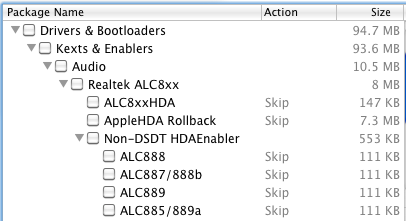

silliconevil Posted October 11, 2011 Author Share Posted October 11, 2011 So. Added the kexts for the mobo, repaired permissions and it seems, that everythings working. Thanks for all the help. Unfortunately I will have to update the os since lion is out in the meantime... Quote Link to comment https://www.insanelymac.com/forum/topic/255517-just-a-simple-beginners-fault/#findComment-1758587 Share on other sites More sharing options...
silliconevil Posted December 1, 2011 Author Share Posted December 1, 2011 Just to let you know: Yesterday, in an unmindfull moment I ran auto-update to 10.6.8. Sound wasn't working an after reinstalling the audio drivers via [url="http://www.insanelymac.com/forum/topic/279450-why-insanelymac-does-not-support-tonymacx86/"]#####[/url] (the one i used for installing to 10.6.7 - probably my second fault) I#m stuck at the very beginning and the Computer doesn't start. Hell. I wonder if im going to install Windows 7 now... Quote Link to comment https://www.insanelymac.com/forum/topic/255517-just-a-simple-beginners-fault/#findComment-1774999 Share on other sites More sharing options...
