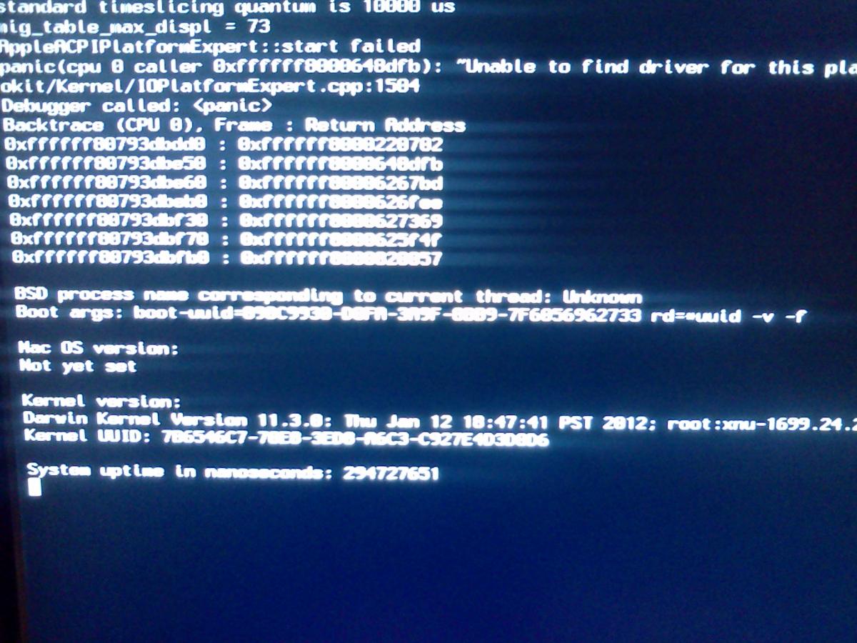

notdave Posted March 9, 2012 Share Posted March 9, 2012 i get this error Link to comment https://www.insanelymac.com/forum/topic/253697-dell-inspiron-530/page/2/#findComment-1804551 Share on other sites More sharing options...
LatinMcG Posted March 9, 2012 Share Posted March 9, 2012 u need smbios.plist made in /Extra .. boot it and use chameleon wizard to make it MacPro3,1 did u set Raid in sata in bios ? (i used dsdt editor to add AHCI orange icon fix .. it injects ESB2 id 2681 apple compatible) theres a voodohda edited in earlier pages for a lot of outputs. i havent tested it .. but i remove HDEF in dsdt ad voodoohda works fine. what video card u using? Nvidia ? boot with -v -x -f GraphicsEnabler=Yes GeneratePStates=Yes GenerateCStates=Yes to disable the dsdt thats loading add after CStates.. DSDT=none exact CaPiTaLiZaTion! your mistakes booted into lion and installed chameleon rc5 r760 onto lion (needs newer 2.1 go to new releases and click chameleon 2.1 by ermac) replaced AppleACPIPlatform.kext and IOPCIFamily.kext (try this one http://netkas.org/?p=1053 ) <key>device-properties</key> <string>6a02000001000000010000005e0200000d00000002010c00d041..... remove it and try GraphicsEnabler in chameleon wizard. u have hdmi in use ? u need a dsdt edit for gfx-hda or was it hda-gfx .. one of them for voodoohda to work with it. for others sound stopped working after.. i think it was IRQ related. one note i have not tried Lion in it. but i could go to friends shop and test one if REALLY needed Link to comment https://www.insanelymac.com/forum/topic/253697-dell-inspiron-530/page/2/#findComment-1804611 Share on other sites More sharing options...
