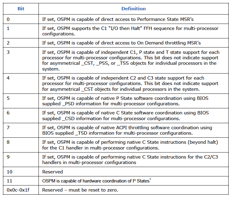

Time2Retire Posted May 27, 2011 Author Share Posted May 27, 2011 Interesting. I compared the _PCT objects, a vital component to get P-States working, of a MacBookPro8,3 with the one found in the iMac12,2 and our Asus ACPI tables. This is what I found out. Let's start with the one found in the MacBookPro8,3: Name (_PCT, Package (0x02) { ResourceTemplate () { Register (FFixedHW, [color="#FF0000"]0x00[/color], // Bit Width [color="#FF0000"]0x00[/color], // Bit Offset 0x0000000000000[color="#FF0000"]000[/color], // Address ,) }, ResourceTemplate () { Register (FFixedHW, [color="#FF0000"]0x00[/color], // Bit Width [color="#FF0000"]0x00[/color], // Bit Offset 0x0000000000000[color="#FF0000"]000[/color], // Address ,) }, }) Here's the one used in the iMac12,2: Name (_PCT, Package (0x02) { ResourceTemplate () { Register (FFixedHW, 0x10, // Bit Width 0x00, // Bit Offset 0x0000000000000199, // Address ,) }, ResourceTemplate () { Register (FFixedHW, 0x10, // Bit Width 0x00, // Bit Offset 0x0000000000000198, // Address ,) } }) And this is the (factory) one we have: Name (_PCT, Package (0x02) { ResourceTemplate () { Register (FFixedHW, [color="#FF0000"]0x40[/color], // Bit Width 0x00, // Bit Offset 0x0000000000000199, // Address ,) }, ResourceTemplate () { Register (FFixedHW, 0x10, // Bit Width 0x00, // Bit Offset 0x0000000000000198, // Address ,) } }) I wonder why Asus wants to read/write all 64 bits (0x40) since 16 (0x10) is all we need. And I might be wrong, but this looks suspiciously like the MSR's we are reading out. Note: I am using the iMac one because of the formentioned reason. Link to comment https://www.insanelymac.com/forum/topic/253642-dsdt-for-asus-p8p67-m-pro/page/23/#findComment-1689253 Share on other sites More sharing options...
flAked Posted May 27, 2011 Share Posted May 27, 2011 I changed the 0x40 to 0x10 and this is the result: May 27 14:53:32 slave kernel[0]: MSRDumper: multiplier: 16 May 27 14:53:37 slave kernel[0]: MSRDumper: multiplier: 16 May 27 14:53:42 slave kernel[0]: MSRDumper: multiplier: 39 May 27 14:53:47 slave kernel[0]: MSRDumper: multiplier: 39 May 27 14:53:52 slave kernel[0]: MSRDumper: multiplier: 39 May 27 14:53:57 slave kernel[0]: MSRDumper: multiplier: 39 May 27 14:54:02 slave kernel[0]: MSRDumper: multiplier: 39 May 27 14:54:07 slave kernel[0]: MSRDumper: multiplier: 16 May 27 14:54:12 slave kernel[0]: MSRDumper: multiplier: 30 May 27 14:54:17 slave kernel[0]: MSRDumper: multiplier: 16 May 27 14:54:22 slave kernel[0]: MSRDumper: multiplier: 16 May 27 14:54:27 slave kernel[0]: MSRDumper: multiplier: 30 May 27 14:54:32 slave kernel[0]: MSRDumper: multiplier: 16 May 27 14:54:37 slave kernel[0]: MSRDumper: multiplier: 16 May 27 14:54:42 slave kernel[0]: MSRDumper: multiplier: 26 May 27 14:54:47 slave kernel[0]: MSRDumper: multiplier: 26 May 27 14:54:52 slave kernel[0]: MSRDumper: multiplier: 26 May 27 14:54:57 slave kernel[0]: MSRDumper: multiplier: 26 May 27 14:55:02 slave kernel[0]: MSRDumper: multiplier: 16 At first I thought it only swings between 16 and 39, but after letting it run a while... I wonder why Asus wants to read/write all 64 bits (0x40) since 16 (0x10) is all we need. And I might be wrong, but this looks suspiciously like the MSR's we are reading out. They might want to read "IDA engange", whatever that is. Or one of the secret reserved bit fields. And yes those are PERF_CTL and PERF_STATUS registers. There is a new beta BIOS for the P8P67 - I shall flash thee. Link to comment https://www.insanelymac.com/forum/topic/253642-dsdt-for-asus-p8p67-m-pro/page/23/#findComment-1689348 Share on other sites More sharing options...
Time2Retire Posted May 27, 2011 Author Share Posted May 27, 2011 I changed the 0x40 to 0x10 and this is the result:...At first I thought it only swings between 16 and 39, but after letting it run a while... Now try a different value in _PSD. They might want to read "IDA engange", whatever that is. Or one of the secret reserved bit fields. And yes those are PERF_CTL and PERF_STATUS registers. IDA = Turbo There is a new beta BIOS for the P8P67 - I shall flash thee. Let's hope this clears the lock bit. Link to comment https://www.insanelymac.com/forum/topic/253642-dsdt-for-asus-p8p67-m-pro/page/23/#findComment-1689357 Share on other sites More sharing options...
flAked Posted May 27, 2011 Share Posted May 27, 2011 Now try a different value in _PSD. With 0xFE = HW_ALL I get the same stepping behavior. I'm now trying your stripped down version, to prove that PSD is ignored OK, so with the stripped down version with only APSS, ACST and APSN, I get normal stepping. Now, setting "Name(APSS, Zero)" still loads AICPUPM but the multiplier stays the same: May 27 15:46:54 slave kernel[0]: MSRDumper: multiplier: 16 May 27 15:48:42 slave kernel[0]: MSRDumper: multiplier: 16 May 27 15:48:47 slave kernel[0]: MSRDumper: multiplier: 16 May 27 15:48:52 slave kernel[0]: MSRDumper: multiplier: 16 May 27 15:48:57 slave kernel[0]: MSRDumper: multiplier: 16 May 27 15:49:02 slave kernel[0]: MSRDumper: multiplier: 16 May 27 15:49:07 slave kernel[0]: MSRDumper: multiplier: 16 May 27 15:49:12 slave kernel[0]: MSRDumper: multiplier: 16 May 27 15:49:17 slave kernel[0]: MSRDumper: multiplier: 16 May 27 15:49:22 slave kernel[0]: MSRDumper: multiplier: 16 May 27 15:49:27 slave kernel[0]: MSRDumper: multiplier: 16 May 27 15:49:32 slave kernel[0]: MSRDumper: multiplier: 16 May 27 15:49:37 slave kernel[0]: MSRDumper: multiplier: 16 This was running Geekbench with 4800 points. Now then, defining APSS like so Name (APSS, Package (0x2) // Performance Supported States, used by SMC_PlatformPlugin { Package (0x06) { /* 2200 MHz */ 0x898, 0xd971, 10, 10, /* 22 */ 0x1600, 0x1600 }, Package (0x06) { /* 1600 MHz */ 0x640, 0x92d9, 10, 10, /* 16 */ 0x1000, 0x1000 } }) Will result in the following error: May 27 16:02:12 slAve kernel[0]: P-State Stepper Error 18 at step 41 on CPU 0 May 27 16:02:12 slAve kernel[0]: P-State Stepper Error 18 at step 37 on CPU 3 I'm sorry, I neglected APSN, if I do this: Name (APSS, Package (0x2) // Performance Supported States, used by SMC_PlatformPlugin { Package (0x06) { /* 2400 MHz */ 0x960, 0xf2fe, 10, 10, /* 24 */ 0x1800, 0x1800 }, Package (0x06) { /* 1600 MHz */ 0x640, 0x92d9, 10, 10, /* 16 */ 0x1000, 0x1000 } }) Name (APSN, 0x00) // Number of turbo states (see Intel Datasheet for your CPU). I can set arbitrary P-states. This shows: May 27 16:21:33 slave kernel[0]: MSRDumper: multiplier: 16 May 27 16:21:38 slave kernel[0]: MSRDumper: multiplier: 24 May 27 16:21:43 slave kernel[0]: MSRDumper: multiplier: 24 May 27 16:21:48 slave kernel[0]: MSRDumper: multiplier: 24 May 27 16:21:53 slave kernel[0]: MSRDumper: multiplier: 24 May 27 16:21:58 slave kernel[0]: MSRDumper: multiplier: 24 May 27 16:22:03 slave kernel[0]: MSRDumper: multiplier: 24 May 27 16:22:08 slave kernel[0]: MSRDumper: multiplier: 24 May 27 16:22:13 slave kernel[0]: MSRDumper: multiplier: 16 With Geekbench score 6700. So, what can we take from this? 1) With EIST enabled in BIOS (and reflected in the MSR) there is no hardware-controlled throttling going on at all. 2) AICPUPM is only interested in A* definitions (APSS, APSN, ACST) 3) AICPUPM is throttling our CPU (according to APSS) Link to comment https://www.insanelymac.com/forum/topic/253642-dsdt-for-asus-p8p67-m-pro/page/23/#findComment-1689366 Share on other sites More sharing options...
