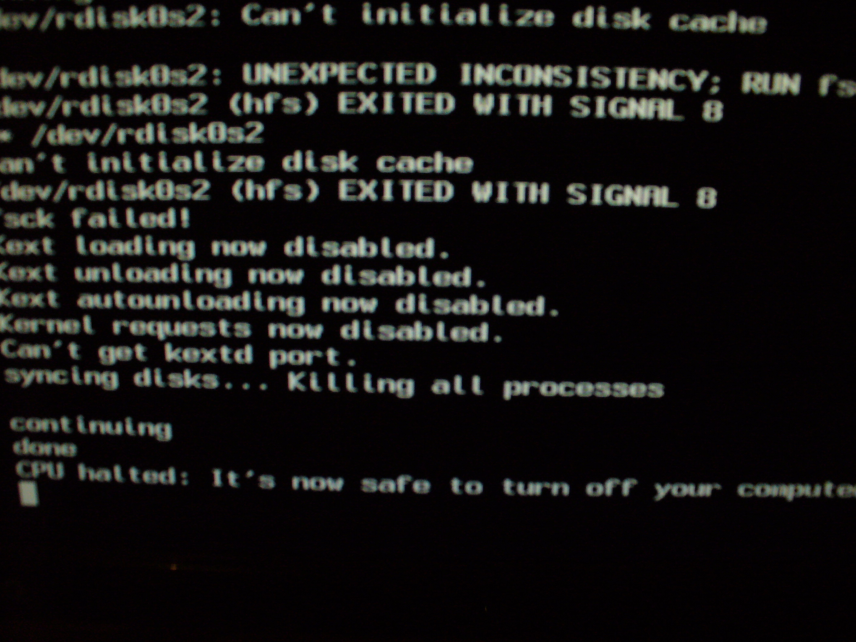

I was able to install but when I try to boot it I get some even more strange thing.
My PC shuts down when it comes to this point:
After the "CPU Health is ok..." is no more line.
The PC shuts down, I dont know what I should do. :/
I've tried -x -v -f, BootCD 1.6 but nothing worked, I disabled all unnessecary things in the Bios, still that Problem..
Please help. =(
I see some messages that could indicate file corruption.
Boot into single user mode with -s and follow the prompt showing you how to run a disk check with fsck.
If you see a message saying "FILE SYSTEM WAS MODIFIED", run fsck again until you no longer see that message.
If you can't do that, boot from your install DVD and run a disk repair on your OS X partition with Disk Utility.
