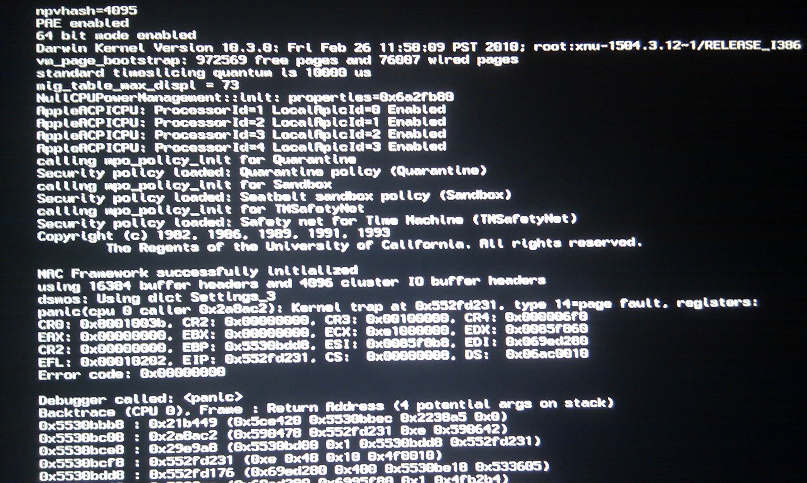

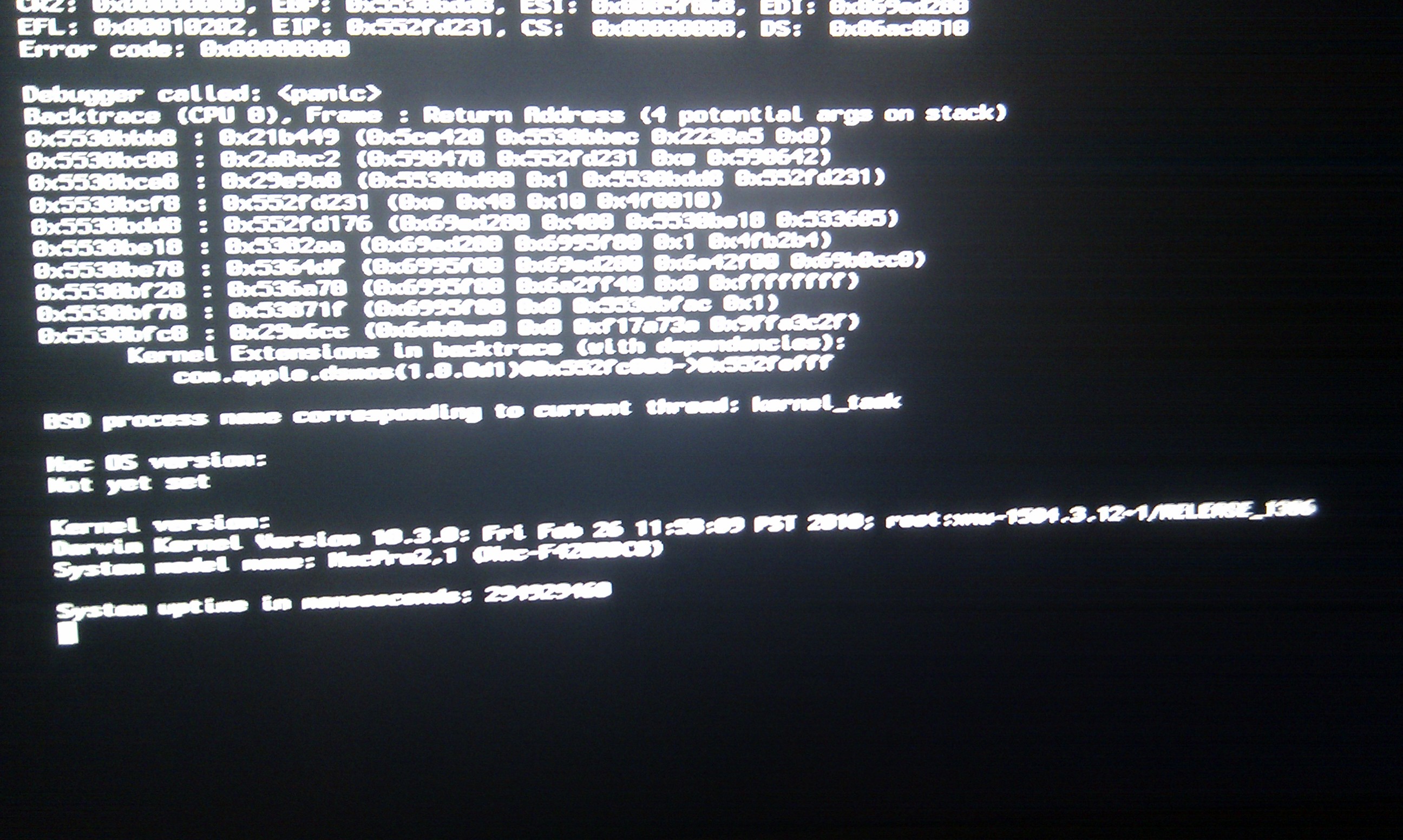

BPMb Posted February 19, 2011 Share Posted February 19, 2011 Hi there! I have a similar board and a similar problem: ASUS P5Q-E (BIOS 2001 modded by Juzzi) 8GB DDR2 800 RAM (tested all with 4GB though) Gigabyte ATI HD5770 1GB SATA 1: Samsung 160GB (my intended SL drive) SATA2: Samsung DVDRW SATA3: Seagate 500GB SATA4: Seagate 500GB SATA5: Seagate 1.5TB I tried the following: Boot discs: [url="http://www.insanelymac.com/forum/topic/279450-why-insanelymac-does-not-support-tonymacx86/"]#####[/url] Empire EFI Dell Inspirion (found in a P5Q-E guide) 132 boot Mars by Ian T Install discs: Snow Leopard Retail on USB thumbdrive (tried 2) 2nd partition on GUID partitioned Samsung 160GB with SL Retail Snow Leopard Universal 3.6 on DVD AHCI has been enabled along with ACPI 2.0 in the BIOS, DVDRW is set as 1st boot device Each and everytime I tried I get a Kernel Panic after loading of the KEXTS, see screenshots. It also says each time "64 bit enabled" eventhough I set the 'arch=i386' flag on boot (tried -x32 as well) ? Also tried boot flags: -x -v GraphicsEnabler=No Still I get a Kernel Panic each time? I don't know what to try next? To the OP: Here's a guide a lot of people seem to be able to follow quite succesfully: http://www.insanelymac.com/forum/index.php?showtopic=189414 Quote Link to comment https://www.insanelymac.com/forum/topic/248172-p5q-retail-mac-snow-automatically-updated-to-1067-was-installation-problem/#findComment-1641849 Share on other sites More sharing options...
Gringo Vermelho Posted February 19, 2011 Share Posted February 19, 2011 You don't need a modded BIOS to install or run Snow Leopard on the P5Q-E. You should reflash your board with the latest 2101 BIOS from ASUS. If you have a Core 2 Duo or Quad CPU you're good to run in 64-bit kernel and drivers mode, so don't worry about that. Make sure the ICH10R is set to AHCI mode and that ACPI 2.0 and all advanced CPU features (except CPUID Limit) are enabled in the BIOS. Everything else you can leave at the default settings. I like to disable stuff that I don't use like Floppy Controller, Serial Port, Drive Xpert etc etc. During installation, use a SATA DVD drive and a SATA hard drive, connected to the ICH10R (red SATA ports). Looks like the problem is with dsmos? I've never seen that on my P5Q-E. Make sure your boot CD has fakesmc.kext on it. (...) I put this together for you, it's like my own P5Q-E boot CD except there are no ACPI tables on it, GraphicsEnabler is not active and sound will not work. There is nothing "special" on it that you can't get anywhere else. It uses the latest Chameleon 2.0 RC5 trunk version of cdboot fresh out of the compiler. BPMb00t.iso.zip I don't have any experience with ATI cards so if something needs to be added for that to work, you're going to have to add it yourself. Reading my guide here: http://forum.voodooprojects.org/index.php/...31.html#msg2131 ..and you will soon have a general idea about the elements a Chameleon boot CD is made of, and you can take this one apart and rebuild it if you need to. Use a CD-RW, you will thank me for that suggestion later. Like all other boot CDs, this one will only work for booting retail (install DVD or restored to HDD partition) so don't waste your time trying to boot your hacked DVDs with it. Good luck. Quote Link to comment https://www.insanelymac.com/forum/topic/248172-p5q-retail-mac-snow-automatically-updated-to-1067-was-installation-problem/#findComment-1641880 Share on other sites More sharing options...

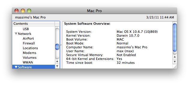

pusillus Posted March 23, 2011 Author Share Posted March 23, 2011 Dear friends, I forgot to disable automatic updates on my machine, so yesterday it installed automatically 10.6.7 and rebooted. ...few seconds of fear and the system booted with no errors. Hope this can help someone. Quote Link to comment https://www.insanelymac.com/forum/topic/248172-p5q-retail-mac-snow-automatically-updated-to-1067-was-installation-problem/#findComment-1659565 Share on other sites More sharing options...
