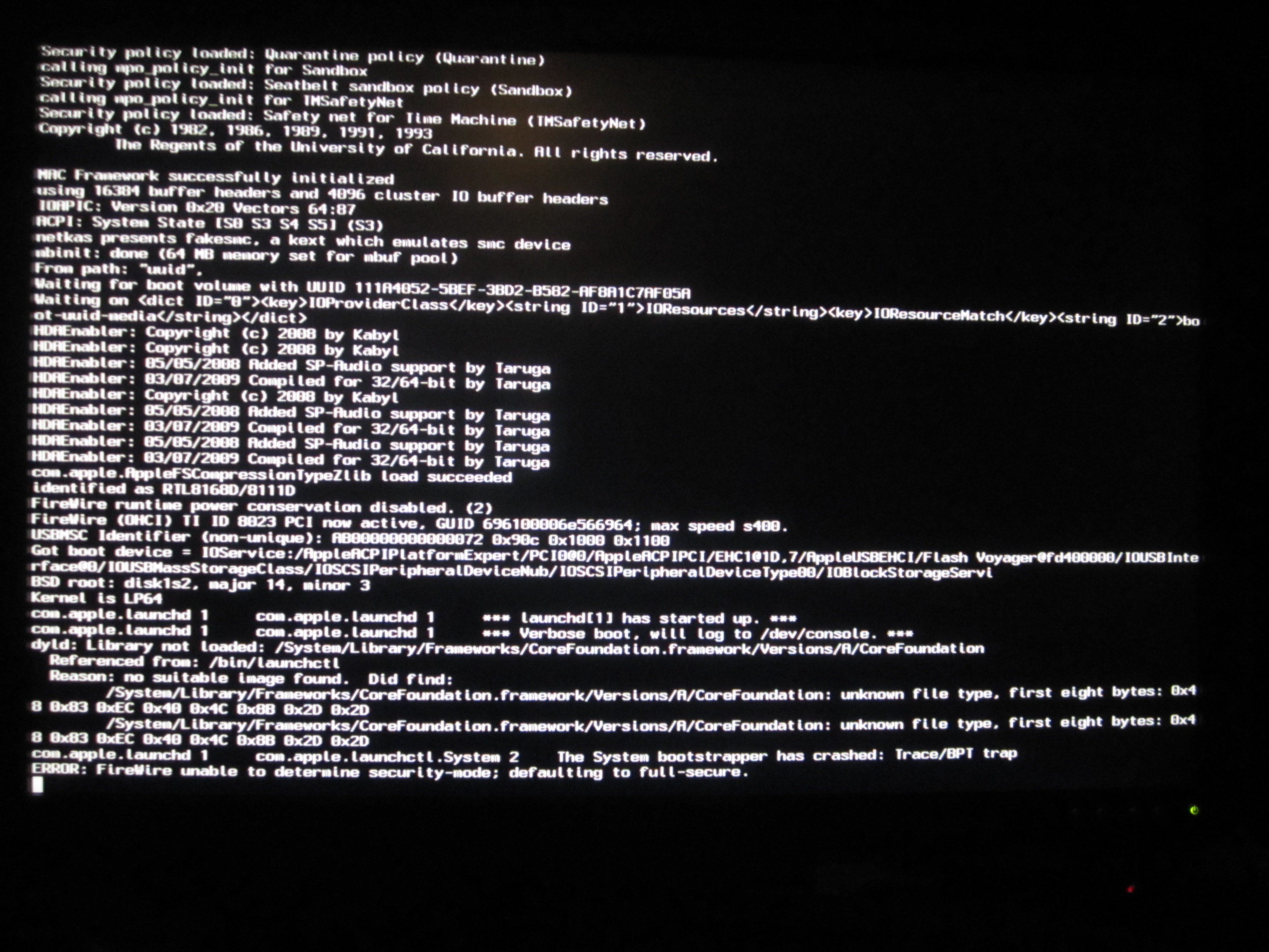

xdanisx Posted February 15, 2011 Share Posted February 15, 2011 What kexts should I use? Thanks. Link to comment https://www.insanelymac.com/forum/topic/247908-106-hangs-on-this/ Share on other sites More sharing options...
Krishna21 Posted February 15, 2011 Share Posted February 15, 2011 What are your computer's specs? Are they the ones in your signature? Link to comment https://www.insanelymac.com/forum/topic/247908-106-hangs-on-this/#findComment-1639744 Share on other sites More sharing options...
xdanisx Posted February 15, 2011 Author Share Posted February 15, 2011 i7 930 @4.0 EVGA SLI LE 6GB Gskill 1600MHz 8-8-8 2x EVGA GTX 470 Onboard sound/lan Link to comment https://www.insanelymac.com/forum/topic/247908-106-hangs-on-this/#findComment-1639765 Share on other sites More sharing options...

Gringo Vermelho Posted February 17, 2011 Share Posted February 17, 2011 RAM: It can depend on which kernel extensions you're using. Some seem to cause kernel panics when you go above x gigabytes of RAM. This happens most frequently with older kernel extensions that have been modified by someone in the community. You can experiment with this by using the maxmem bootflag. Boot with maxmem=2048 (for example) and the OS only sees 2 GB RAM. Very useful for troubleshooting. GPU: Pay a visit to the fermi thread to make sure, but beware of outdated and obsolete files and info, especially the stuff in the first post. There is no need to mess up your system with patched stuff if you can get the 470 working with unmodified files. Read further inside the thread for more current information: http://www.insanelym...howtopic=214219 Past 10.6.5 you should be able to install the latest drivers from nvidia + the latest version of Chameleon and have graphics fully working with GraphicsEnabler=y in /Extra/org.chameleon.Boot.plist. Many users are still reporting strange issues with fermi-based cards though. Read and then read some more. Type "Fermi" in the search box and see what you can come up with. Link to comment https://www.insanelymac.com/forum/topic/247908-106-hangs-on-this/#findComment-1641249 Share on other sites More sharing options...

xdanisx Posted February 19, 2011 Author Share Posted February 19, 2011 OK Update: I did a complete reinstall of SL. First I used rc5 as my bootloader, but it doesn't work. Rc4, however, works like a pro. I guess rc5 just doesn't work with my board. Also, sound randomly works now without adding any kexts... Link to comment https://www.insanelymac.com/forum/topic/247908-106-hangs-on-this/#findComment-1642274 Share on other sites More sharing options...
