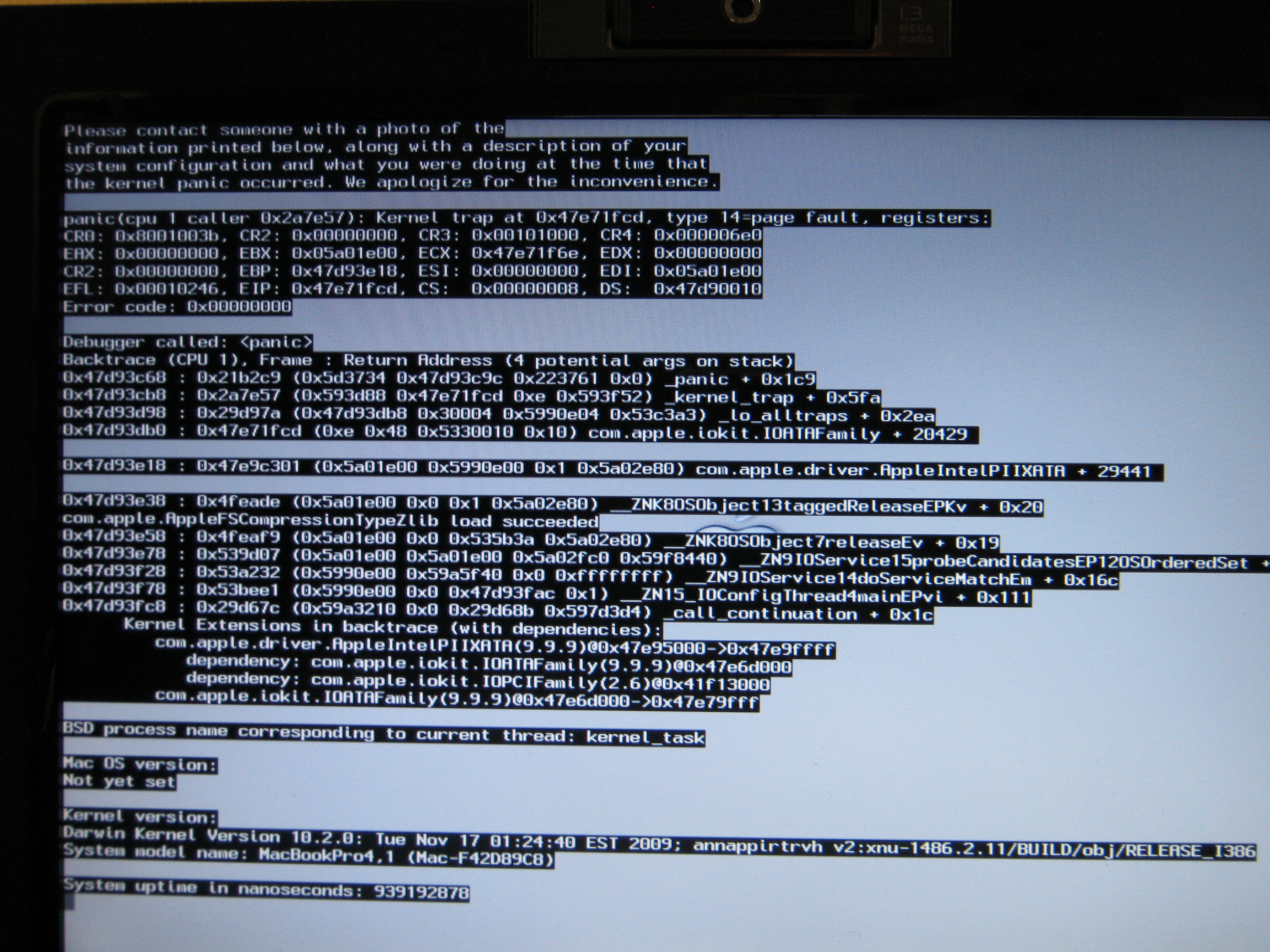

mistero Posted March 21, 2011 Author Share Posted March 21, 2011 I read in some forum, but i not remember where, need to install snow leopard a modified bios. When i try to install, appeared on screen this image Thanks in advance P.S. sorry for my english Quote Link to comment https://www.insanelymac.com/forum/topic/243561-snow-leopard-for-asus-f9e/#findComment-1658499 Share on other sites More sharing options...

mistero Posted March 24, 2011 Author Share Posted March 24, 2011 The image Quote Link to comment https://www.insanelymac.com/forum/topic/243561-snow-leopard-for-asus-f9e/#findComment-1660219 Share on other sites More sharing options...
Gringo Vermelho Posted March 24, 2011 Share Posted March 24, 2011 The driver for your PATA/SATA controller is causing the kernel panic. A "modified BIOS" is not the way to fix this. Try different BIOS settings for your drive controller, try unplugging all other drives, whatever else you can think of. What's your install method and what's an Asus F9E, post some specs. Quote Link to comment https://www.insanelymac.com/forum/topic/243561-snow-leopard-for-asus-f9e/#findComment-1660327 Share on other sites More sharing options...
mistero Posted March 24, 2011 Author Share Posted March 24, 2011 Setting for SATA/PATA on bios screen are: IDE Configuration SATA Operation Mode Compatible or Enhanced Primary IDE Master Auto or CD/DVD or ARMD i'm try all but no success. always show panic In uploading a video because i dont have a good photo machine. In attachment the video with bios settings Video Bios Screen Quote Link to comment https://www.insanelymac.com/forum/topic/243561-snow-leopard-for-asus-f9e/#findComment-1660514 Share on other sites More sharing options...

mistero Posted March 25, 2011 Author Share Posted March 25, 2011 I did not understand the question. By inserting the DVD. i dont know other metods. I'm try to start with -s, cpus=1. no success. Quote Link to comment https://www.insanelymac.com/forum/topic/243561-snow-leopard-for-asus-f9e/#findComment-1660710 Share on other sites More sharing options...

mistero Posted March 27, 2011 Author Share Posted March 27, 2011 I solved myself. I'm try with retail DVD + suitable boot CD but no success I'm using: 1 - SL_10.6.6i_by_Hazard 2 - PPF-O-Matic_Windows 3 - SL_10.6.6i_IOATAFamily.ppf I have integrated on point 1 with tool in point 2 the patch on point 3 Result: Successfully install Snow leopard. A this time dont work my integrated webcam and wireless intel 3945 The update operating system to 10.6.7 causes the crash. The other update work correctly. I hope with my work be useful to someone!!!!! Sorry for my english I am proud to be Italian Quote Link to comment https://www.insanelymac.com/forum/topic/243561-snow-leopard-for-asus-f9e/#findComment-1661647 Share on other sites More sharing options...
