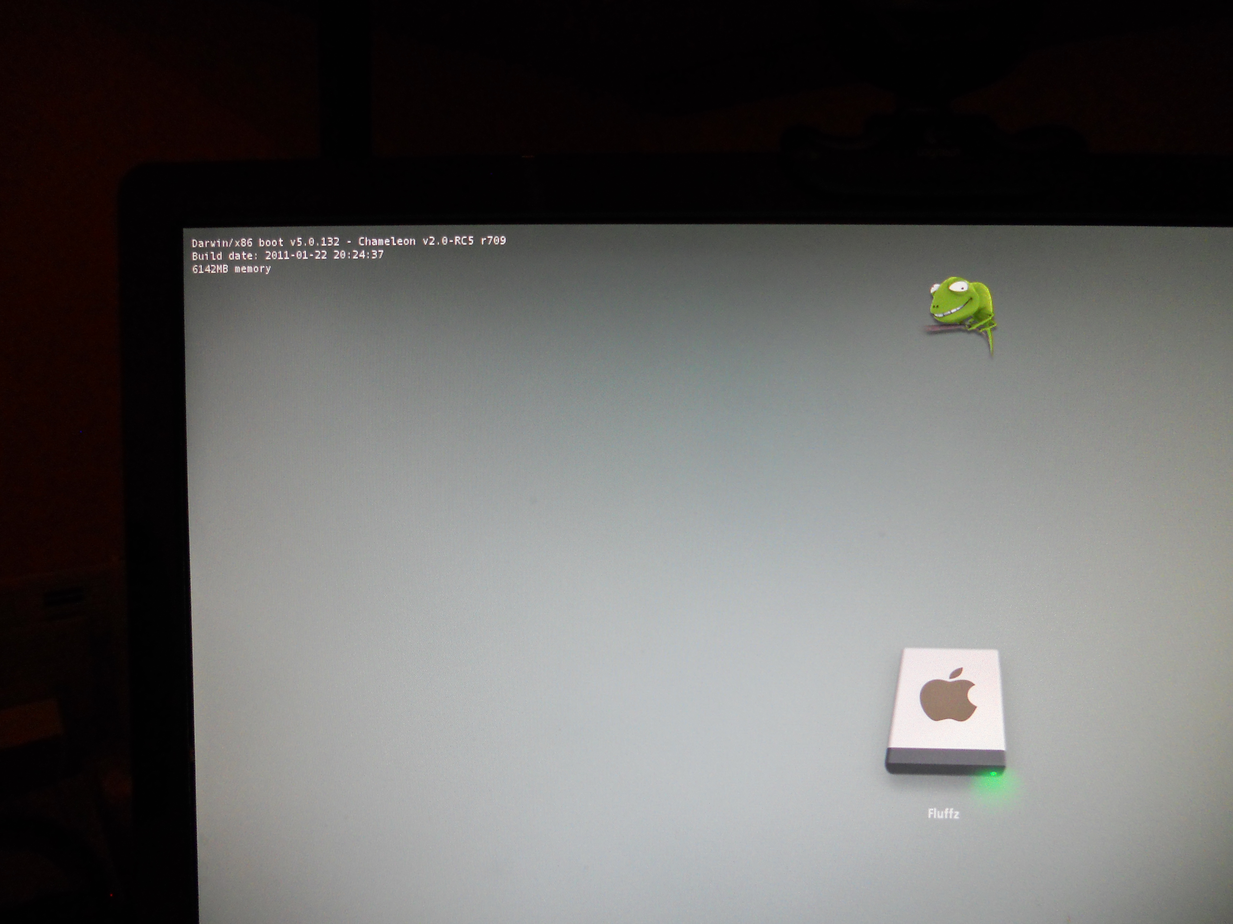

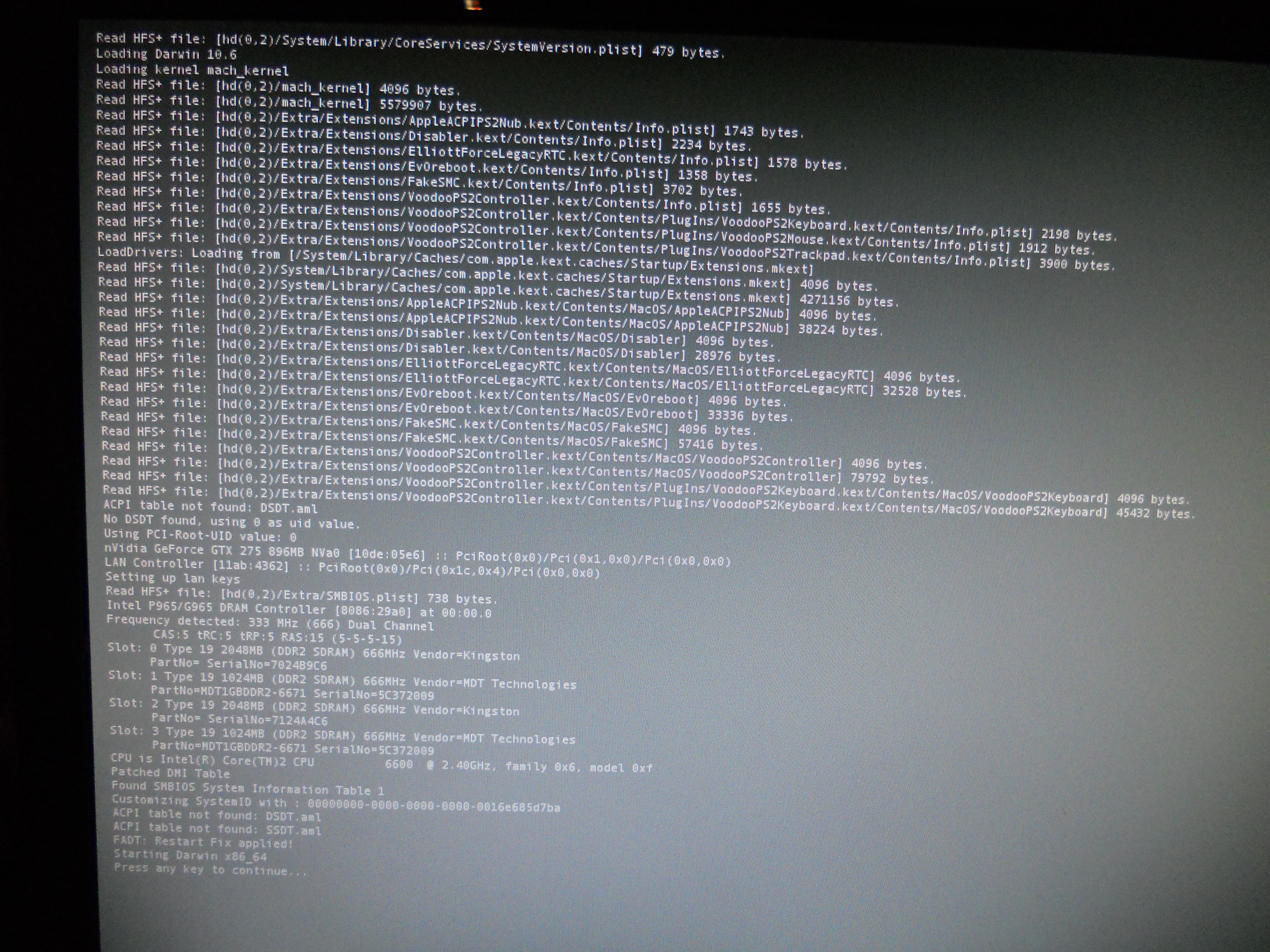

Hades Posted January 22, 2011 Author Share Posted January 22, 2011 Hi Gringo I did everything you asked me...! yehaa Here the pictures. I hope they look good to you? Link to comment https://www.insanelymac.com/forum/topic/243479-help-korg-legacy/page/2/#findComment-1627622 Share on other sites More sharing options...
Gringo Vermelho Posted January 22, 2011 Share Posted January 22, 2011 That's it, well done, now we're getting somewhere! As you can see, there is a "Restart Fix Applied!" message from Chameleon now. So, next up, try moving Ev0reboot.kext out of /Extra/Extensions and see if you can shut down and restart correctly without it. The Chameleon restart fix doesn't seem to work for everybody. It works for me. If it doesn't work (ie you have to press the reset button to shut down/restart again) remember to boot up with -s and run fsck like I showed you in post #28. Then put Ev0reboot.kext back in /Extra/Extensions. We'll get to that later, with a little luck there is a much nicer way to fix this. But it should work now, let me know. Any change with Video and Korg Legacy? I guess not since you didn't mention it. Let me know. I can't tell how you had your video card working before, you had Natit, NVEnabler and a Device Properties-String all active at the same time, it surprises me it was working at all. I think I was on the right track with the PciRoot setting, your EFI studio "PciRoot(0x1)/Pci(0x1c,0x4)/Pci(0x0,0x0)" has the PciRoot at 1 - but as you can see in the Chameleon verbose output, Chameleon sets it to 0 - which is the Chameleon default. We'll deal with this later. Did you take a look under "Memory" in System Profiler? Pretty cool. Chameleon at work! Let's move on, there are a couple more things to do still. I need two things from you: Download LSPCI for OS X from here: http://uploaded.to/file/b7gy5i (I think you need to reboot after installing it) Then open Terminal, type LSPCI -nn and press enter. Post the output here. Copy+Paste the Perl script below into Terminal and press enter: perl -e 'open(CMD, "ioreg -lw0 \| grep DSDT|") or die; while(<CMD>) { chomp; if($_ =~ /\"DSDT\.?\d?\"=<([^>]*)>/) { $buff = $1; open(PIP, "|xxd -r -p > ~/Desktop/dsdt.aml") or die; print PIP "$1"; } }' DSDT.aml will appear on your desktop. Zip it and attach it here. Link to comment https://www.insanelymac.com/forum/topic/243479-help-korg-legacy/page/2/#findComment-1627637 Share on other sites More sharing options...

Gringo Vermelho Posted January 23, 2011 Share Posted January 23, 2011 Yes, that is perfect. As you can see, LSPCI shows device and vendor IDs for all your hardware. The numbers at the beginning of every device (e.g. 00:1f.0) is the location of the device, its 'address'. I can use these numbers to locate each device in your DSDT. It's good that restart works. I will attempt to fix your shutdown by editing your DSDT so you can delete Ev0reboot.kext. When I'm done you'll be able to get rid of ElliottForceLegacyRTC.kext as well. Most importantly I think I might be able to do something about your LAN and graphics. Two more things: Are you using USB or PS2 mouse and keyboard? More house cleaning: zip and attach your disabler.kext from /Extra/Extensions. Disabler.kext is a community made kernel extension that can be configured to disable loading of kernel extensions that are incompatible or cause issues when running OS X on a PC. I want to have a look inside it and see what it disables, I don't think you need this kext at all. I have to go out now, I'll look at your DSDT later this afternoon. In the meantime, use this com.apple.Boot.plist: com.apple.Boot.plist.zip I removed the wait and -v flags and put your timeout back so you dont have to press any keys when booting up. I also set the PciRoot to 1, so let me know if there are any changes to video and ethernet - check if it's set as built-in now and, as before, remember to delete the networkinterfaces plist file (refer to post #7) before you reboot. Link to comment https://www.insanelymac.com/forum/topic/243479-help-korg-legacy/page/2/#findComment-1627881 Share on other sites More sharing options...
Hades Posted January 23, 2011 Author Share Posted January 23, 2011 Hi YOU ARE A MAGICIAN !! gfx card fully detected ! And screenshot working again ! Chipsatz-Modell: GeForce GTX 275 Typ: GPU Bus: PCIe Steckplatz: Slot-1 PCIe-Lane-Breite: x16 VRAM (gesamt): 896 MB Hersteller: NVIDIA (0x10de) Geräte-ID: 0x05e6 Versions-ID: 0x00a1 ROM-Version: 0x00 Monitore: SyncMaster: Auflösung: 1680 x 1050 @ 60 Hz Pixeltiefe: 32-Bit Farbe (ARGB8888) Hauptmonitor: Ja Synchronisierung: Aus Eingeschaltet: Ja Rotation: Unterstützt Monitoranschluss: Status: Kein Monitor angeschlossen Korg Legacy all registered ! WOW THX I am using PS2 Keyboard and USB Mouse Here is the disabler.kext.zip you wanted to see Disabler.kext.zip I am happy right now Link to comment https://www.insanelymac.com/forum/topic/243479-help-korg-legacy/page/2/#findComment-1627936 Share on other sites More sharing options...
Gringo Vermelho Posted January 24, 2011 Share Posted January 24, 2011 Great! It turns out it was the PciRoot=1 setting that was needed all along. You must have missed it when I asked you to try it earlier (waaaaayy back in post #9). Again, and I can't stress this enough: I cannot help you if you don't do what I ask. It's highly recommended to use only USB mouse and keyboard on a Hackintosh. If you must use PS2 devices, it's better to use both PS2 keyboard and mouse, never mix USB and PS2 input devices. Macs don't have PS2 ports. Of course you have the community built Voodoo PS2 drivers installed but you're still lucky that this combination works for you! Unzip and drop the attached DSDT.aml in /Extra and delete Disabler.kext (which was never disabling anything anyway, the extensions it's supposed to disable are clearly loaded on your system) ElliottForceLegacyRTC.kext and Ev0reboot.kext from /Extra/Extensions. Reboot, but make the following changes in your BIOS before you boot into OS X again: Limit max CPUID - disabled CPU thermal monitor - enabled ACPI suspend type - S3 No Execute Memory Protect - enabled Some of these are probably set correctly already. Let me know if you can shut down and reboot properly, or if anything funny happens after adding the DSDT. I did not do anything to the Firewire device, have you ever used your Firewire ports, are they working? I would like to see if patching your DSDT was worth the trouble. Do me a favor and run Console.app, find kernel.log in the left pane, save it somewhere, zip it and attach it here. This will allow me to check my work. Well some parts of it at least. In System Profiler, check all your USB ports, they should be seen by OS X as built-in or internal. If I've patched USB correctly in your DSDT, it should not say "expansion card" anywhere! Please let me know. [DSDT removed - updated version on next page] Link to comment https://www.insanelymac.com/forum/topic/243479-help-korg-legacy/page/2/#findComment-1628261 Share on other sites More sharing options...

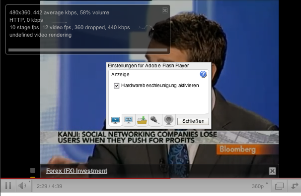

Hades Posted January 24, 2011 Author Share Posted January 24, 2011 Ok I installed the .aml restart without problems... checked the bios settings done here is the kernel log: kernel.log.rtf.zip Uninstalling Adobe Flash player ....install the new flash player ...no changes.... I noticed i can watch the video in fullscreen and have working start/stop buttons in fullscreen but not normal size X-Fi isnt that important because the tascam has much better quality and works like a charm with logic Link to comment https://www.insanelymac.com/forum/topic/243479-help-korg-legacy/page/2/#findComment-1628571 Share on other sites More sharing options...
Gringo Vermelho Posted January 24, 2011 Share Posted January 24, 2011 Good news, these error messages are gone: Jan 24 16:21:12 localhost kernel[0]: USBF: 1. 49 AppleUSBEHCI[0xffffff800e250000]::CheckSleepCapability - controller will be unloaded across sleep Jan 24 16:21:12 localhost kernel[0]: USBF: 1.173 AppleUSBEHCI[0xffffff800e380000]::CheckSleepCapability - controller will be unloaded across sleep Which means the USB 2.0 EHCI patch worked like it should. You have a new error message: Jan 24 17:47:07 xxx-iMac kernel[0]: ACPI_SMC_PlatformPlugin::pushCPU_CSTData - _CST evaluation failed Jan 24 17:47:07 xxx-iMac kernel[0]: ACPI_SMC_PlatformPlugin::registerLPCDriver - WARNING - LPC device initialization failed: C-state power management not initialized Which means my LPC device patch has failed! I'll see what I can do about it. AppleHDA is loading for your on-board sound now but throws some assertion errors: Jan 24 17:47:06 xxx-iMac kernel[0]: Sound assertion "0 == pathMap_aDriverInstance" failed in "/SourceCache/AppleHDA/AppleHDA-199.4.12/AppleHDA/AppleHDADriver.cpp" at line 1667 goto Exit Jan 24 17:47:06 xxx-iMac kernel[0]: Sound assertion "0 != createAudioEngines ( fPathMap_aDriverInstance )" failed in "/SourceCache/AppleHDA/AppleHDA-199.4.12/AppleHDA/AppleHDADriver.cpp" at line 202 goto Exit Those don't necessarily mean that it won't work though. Let me know if you'd like to use your on-board sound and I'll look into it. Lastly, it is strange that kernel.log says "your-iMac" everywhere, since you should be using this: smbios.plist.zip Extract this smbios.plist, place it in /Extra (overwrite the one that's there, if there is one) and reboot. Then check System Profiler, it should say MacPro 3,1 now. Let me know. You're not running a Firefox 4 beta version are you? It has known issues with flash content on OS X. Go back to Firefox 3.6. Download the non-beta and replace Firefox in your Applications folder. Don't worry, you will not lose your personal data, all that stuff is stored in your user folder somewhere. Make sure your flash version is 10.1.102.64. In Firefox, click Tools -> add-ons -> plugins, then click the "find updates" button at the bottom left. Update any other outdated plugins you might have. If you have duplicate versions of Flash installed that the uninstaller didn't catch, follow the steps outlined here to get rid of them: http://support.mozilla.com/en-US/kb/Flash%...plicate-plugins Have you tried shutting down with the DSDT installed, did it work? Please run Terminal and do kextstat -k >~/desktop/kextstat.txt And attach the kextstat.txt here. Link to comment https://www.insanelymac.com/forum/topic/243479-help-korg-legacy/page/2/#findComment-1628586 Share on other sites More sharing options...

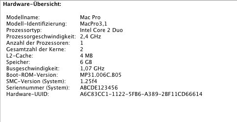

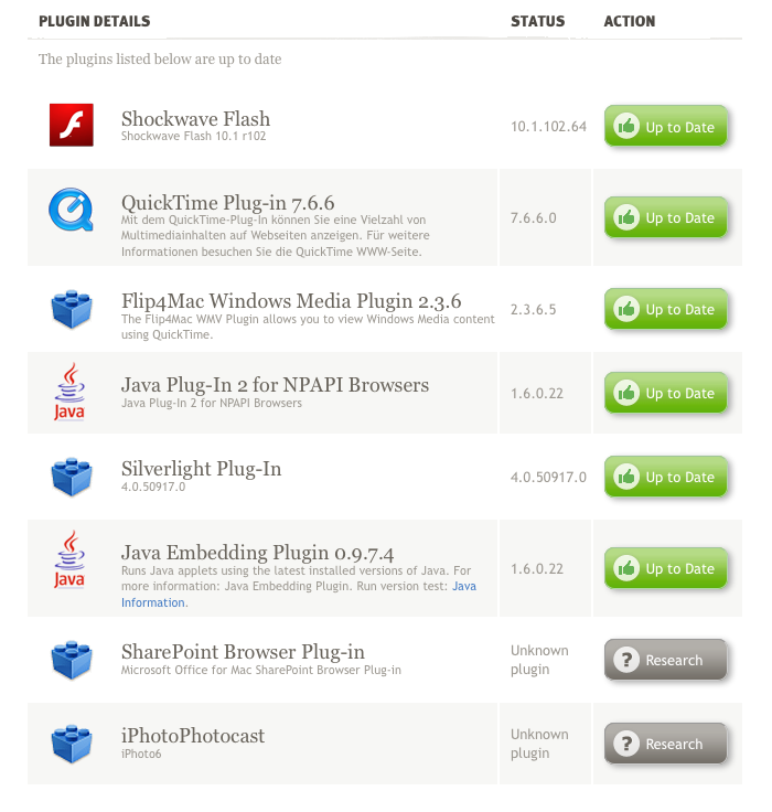

Hades Posted January 24, 2011 Author Share Posted January 24, 2011 Hi Gringo No i dont run an beta of firefox its version 3.6.13 i made a screenshot after the plug in check: And here is a screenshot before i replace the smbios.plist : shutdown also works like it should I dont think i use the onboard X-fi because the Tascam has much better sound quality Here is the output from kextstat kextstat.rtf.zip Link to comment https://www.insanelymac.com/forum/topic/243479-help-korg-legacy/page/2/#findComment-1628611 Share on other sites More sharing options...
Gringo Vermelho Posted January 24, 2011 Share Posted January 24, 2011 That's weird then that kernel.log insists on iMac when System Profiler clearly says MacPro. Maybe it's simply this: Open System Preferences, open the sharing preference pane and change the "computer name" to [yourname]'s MacPro. I was asking about your motherboard's built-in audio, your X-fi XtremeMusic is not on-board, it's a PCI expansion card. If you would you like to have working on-board audio just let me know and I'll look into it. Something to try to fix your youtube issue, go here: http://www.macromedi...gs_manager.html Scroll down and click the link to the "Website Storage Settings Panel", then click the "Delete All Sites" button. Install Adobe Shockwave - get the 64-bit download: http://get.adobe.com.../otherversions/ Then test if this game works (but be careful, it's terribly addictive ): http://www.kongregat...t-touch-my-gems Quit Firefox, open it again and go to youtube.com and check if anything has changed. Here's a revision to your DSDT: dsdt.aml.zip Fixes/patches applied: Powerbutton fix (power button works like on a real Mac) RTC length fix (prevents CMOS reset) Added MCDP method (Master Chief's version of Apple's DTGP method) Added ICHx HDAEnabler code (THe KiNG) Removed useless floppy controller and parallel port code Renamed PX40 to LPCB and patched device ID to 2815 (was 2810) Renamed PX43 to SBUS and added BUS0 and DVL0 subdevices Renamed COPR -> MATH, TMR -> TIMR, PIC -> IPIC, HUB0 -> PCIB Removed IRQs from RTC, TIMR and IPIC (THe KiNG) Renamed USBE and USE2 to EHC1 and EHC2, USB0-4 to UHC1-5, AZAL to HDEF USB 2.0 external -> internal fix (AAPL clock-id) Gigabyte shutdown fix and HPET device (AsereBLN) Fixed 1 compiler warning and 3 errors As before, place DSDT.aml in /Extra, overwriting the one that's there. Don't reboot yet. Oddly, AppleLPC.kext appears to be loaded, it's in your kextstat, so I don't know why kernel.log has the LPC device error in it. Maybe it's a cache thing. Run Terminal and delete the extensions cache, like this: sudo rm -rf /System/Library/Caches/com.apple.kext.caches/Startup/Extensions.mkext Type your password when prompted. Reboot. It will take a little longer than usual as there is now no extensions cache. It'll be rebuilt automatically. Link to comment https://www.insanelymac.com/forum/topic/243479-help-korg-legacy/page/2/#findComment-1628631 Share on other sites More sharing options...

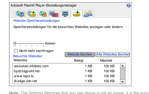

Hades Posted January 26, 2011 Author Share Posted January 26, 2011 Hi Gringo I have found on the flash site the panel and only could see it after installing shockwave. I know there is a button "delete all websites" but i can´t use the panel cause its like a picture. Took minutes till i see a dialog popup to confirm the deletion Here is the screenshot: But nothing changed on youtube after it Link to comment https://www.insanelymac.com/forum/topic/243479-help-korg-legacy/page/2/#findComment-1629765 Share on other sites More sharing options...
Gringo Vermelho Posted January 26, 2011 Share Posted January 26, 2011 This is a strange issue, I have never heard of it and I can't find anything in google either so far. I believe that since Flash works in Safari, and you've done all that can be done now to the Flash plugin, then it must be a problem with Firefox itself. Try the youtube troubleshooting steps outlined here: http://www.google.com/support/youtube/bin/...y?answer=143007 Especially the stuff about javascript and popup blocking software. Ignore the Firewall part, it can't be that since youtube videos work for you in Safari. Run Software Update from the Apple menu and look for a Java update (yes I know that Java and JScript is not the same thing). Java updates are 100% safe to install for you. You can also try a full reset of Firefox. Backup your bookmarks: Click bookmarks, organize, click the third (star) icon at the top, click 'Backup...' and save the .json file somewhere convenient so you can easily restore it later. Unless you already have all your passwords written down somewhere, backup all your passwords: Right-click this link: "Firefox3 compatible password exporter" click save link as, and save it to your desktop. (You can go here: http://wejn.org/stuff/moz-export.html to read about the file you just downloaded) Although it is not necessary, at this point you will probably feel better about what happens next if you unplug your network cable or disable your network connection first. Don't forget to enable it again later. Double click on the file you saved. A new Firefox window will open. Click 'allow' on the prompt that appears. A list of your passwords and the sites they belong to will appear. You can sort the order if you want. When you're done, click 'export as text file' at the top left. Now run textedit.app, then copy and paste all your passwords into it and save the file. All done. You'll still have to enter them all manually later though! Quit Firefox. Now we will completely wipe your Firefox user profile, preferences, etc. Hopefully this will help with your Youtube issue. Run Terminal.app, type... /Applications/Firefox.app/Contents/MacOS/firefox-bin -profilemanager ...and press enter. This will bring up the Firefox Profile manager. If yours is the only user account on your Hackintosh, delete all profiles. Restart Firefox and import your bookmarks in the same way that you exported them. Try Youtube again. And please tell me that it's working now!! Link to comment https://www.insanelymac.com/forum/topic/243479-help-korg-legacy/page/2/#findComment-1629813 Share on other sites More sharing options...
