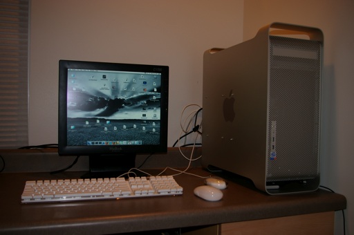

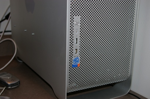

apple fanboy Posted September 19, 2005 Author Share Posted September 19, 2005 Just an update. Have now dual booted with XP Home. After some scary moments of not being able to boot into OSX again (after having followed the release 1 instructions to the letter) I got back in. On a whim, tried my bluetooth dongle (usb) that I got with my Apple bluetooth mouse. They both work like a charm in OSX. No workey in XP hence the extra mouse on the desktop..... Now for the pics of my baby.... Link to comment https://www.insanelymac.com/forum/topic/2424-its-alive/#findComment-17405 Share on other sites More sharing options...
