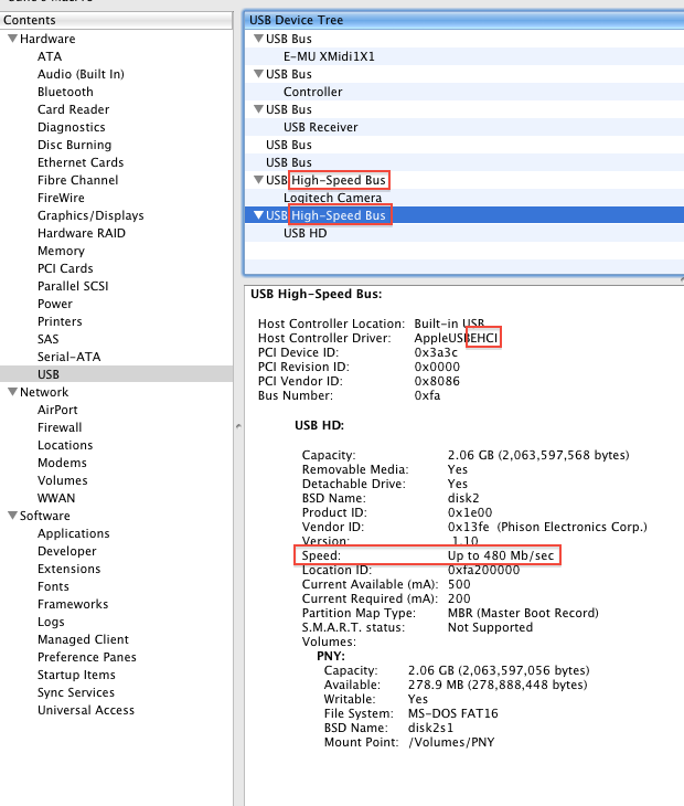

Gringo Vermelho Posted December 2, 2010 Share Posted December 2, 2010 OS X cannot talk to your USB 2.0 controller (USBEHCI) for some reason, your USB ports are working at USB 1.0 speeds. This is what it's supposed to look like: Download and install LSPCI, type LSPCI -nn in terminal and post the output here. Quote Link to comment https://www.insanelymac.com/forum/topic/238671-usb-is-very-slow/#findComment-1595345 Share on other sites More sharing options...

Gringo Vermelho Posted December 3, 2010 Share Posted December 3, 2010 Try enabling EHCI handoff. Quote Link to comment https://www.insanelymac.com/forum/topic/238671-usb-is-very-slow/#findComment-1595913 Share on other sites More sharing options...
