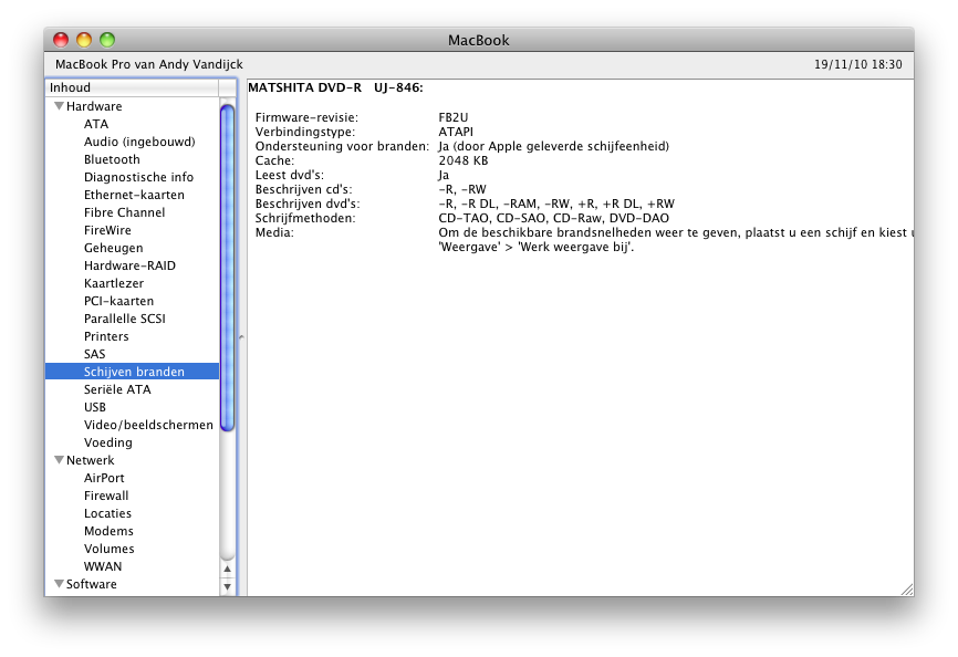

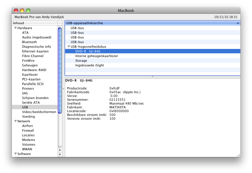

Andy Vandijck Posted November 19, 2010 Share Posted November 19, 2010 This driver enables you to fully utilise your USB DVD drive as Apple Shipping Drive. This also fixes DVD Player for computers without internal DVD drive. I tested it on my Freecom USB DVD drive and it works like a charm. This is also the only way to get DVD Player working on a netbook without internal DVD drive. Installation howto: You need to get your vendor and device ID through System Profiler or IORegistryExplorer and insert them under "Fake DVD Drive SCSI ID" and "Fake DVD Drive Interface" parts Next look up under IOSCSIPeripheralDeviceNub in IORegistryExplorer the Product Identification and Vendor Identification and insert them in the "Fake DVD Drive SCSI ID" part. If you need IORegistryExplorer look under AnyCardReader in this forum, it contains a link to download this. Next install it under /System/Library/Extensions. Reboot with the drive plugged in and check System Profiler, if it says "Apple Shipping Drive" under the burning support all is good to go. Enjoy your full support on the USB DVD drive. Download: http://rapidshare.com/files/431860915/AnyU...Driver.kext.zip Link to comment https://www.insanelymac.com/forum/topic/237665-anyusbdvd-driver-to-get-your-external-usb-drive-recognized-as-apple-shipping-drive/ Share on other sites More sharing options...
