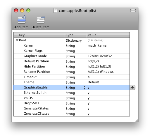

Gringo Vermelho Posted November 15, 2010 Share Posted November 15, 2010 Your Hackintosh will not even boot if your com.apple.Boot.plist is empty! Here's a default com.apple.Boot.plist as it ships with OS X. com.apple.Boot.plist.zip Leave this alone in /Library/Preferences/SystemConfiguration, and make all your modifications to the one you keep in /Extra. Yes, I mean the output that's physically closest to the motherboard. As far as OS X is concerned, that's the primary display output. Each video output does not have an IRQ. The card itself has one. *EDIT Try removing AppleUpstreamUserClient.kext from S/L/E. Put it in a backup folder somewhere. Google the kext to learn why that's worth trying. Try disabling "Spread Spectum" in your BIOS. Disable all hardware that you're not using (such as floppy drive, game/MIDI- serial- and parallel ports). Enable 32-bit data transfer for your hard drives. Make sure your CPU BIOS settings are correct for your CPU. I'm looking at your motherboard manual right now and there's a ton of weird AMD-specific CPU settings in your BIOS that I am not familiar with. Refer to your CPU specs at AMD's website and your motherboard manual. Link to comment https://www.insanelymac.com/forum/topic/237088-transluence-question-should-be-easy/#findComment-1584004 Share on other sites More sharing options...
Pikeman85 Posted November 15, 2010 Author Share Posted November 15, 2010 When I said empty, I meant vanilla re com.apple.Boot.plist - sorry, I should be more exact here. I tried putting <key></key> <string>GraphicsEnabler=yes</string> which may be wrong - tested it, nothing. I suspect I put the key in wrong. usually when I test graphicsenabler, I let my distro install it automatically. The output closest to the motherboard is the DVI slot. I don't believe I have speed spectrum avaliable to me. I will turn off all settings that you specify as well as move that kext. Thanks for all this help! Hopefully my struggle will help someone else in a similar situation sometime. Link to comment https://www.insanelymac.com/forum/topic/237088-transluence-question-should-be-easy/#findComment-1584499 Share on other sites More sharing options...
Gringo Vermelho Posted November 15, 2010 Share Posted November 15, 2010 Yeah, that's wrong. This is what it should look like: <key>GraphicsEnabler</key> <string>y</string> You should use the Property List Editor that comes with Apple Developer Tools (find it on your retail install DVD or google it), it's made just for editing plist files. Worst case scenario; using other editors can screw up the formatting of com.apple.Boot.plist, resulting in your settings not being read on bootup. The Apple Property List Editor looks like this, as you can see it's really easy on the eyes: According to your motherboard manual, you have the Spread Spectrum option. Usually this setting causes slow downs and in extreme cases even freezes and skipping. Google it to learn more. Please verify that those weird CPU settings are correct, there is a lot of stuff in there. Do some googling on your motherboard, there must be lots of other users out there wondering what the hell all those settings are for. Link to comment https://www.insanelymac.com/forum/topic/237088-transluence-question-should-be-easy/#findComment-1584505 Share on other sites More sharing options...
