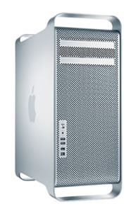

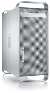

CoopDaVille Posted November 13, 2010 Author Share Posted November 13, 2010 Thanks for replying. I havent bought anything yet either. I and gonna start with the case. I want to get the easier case to mod due to not having to tools to make all the things. I see on ebay.com that the G5's are dirt cheap. I seen 2 for like 50-80 bucks. But the Mac Pro case is like 175 and up for 1 case. I want the Mac Pro case but if there is more modding then its not the case for me. If you find some usable info please post links. Thanks I found this by doing a google search. http://forums.macrumors.com/showthread.php?t=416283 If thats the case that there the same size then, whats the difference in the case's? Mac Pro on Left G5 on Right Link to comment https://www.insanelymac.com/forum/topic/237064-g5-or-mac-pro-case/#findComment-1582907 Share on other sites More sharing options...
