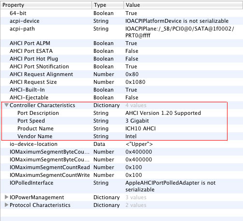

iLeopod Posted February 18, 2011 Share Posted February 18, 2011 No this fix also don't enable kextless restart. But i can live with a kext for that. But found something important while trying to show the SATA Controller name in System Profiler. Currently looking like this: An important fix for sleep is to inject the (non Apple supported) sata controller as Built in . Hero on my first sata controller. Device (SAT0) { Name (_ADR, 0x000E0000) Method (_DSM, 4, NotSerialized) { Store (Package (0x0A) { "AAPL,slot-name", Buffer (0x09) { "Built In" }, "built-in", Buffer (One) { 0x00 }, "device_type", Buffer (0x10) { "AHCI Controller" }, "model", Buffer (0x1C) { "nForce SATA/AHCI Controller" }, "name", Buffer (0x1C) { "nForce SATA/AHCI Controller" } }, Local0) DTGP (Arg0, Arg1, Arg2, Arg3, RefOf (Local0)) Return (Local0) } Device (PRT0) ....... Without that my mainboard show an error on the Onbord conrol LED F3| Init Com Port | COM port initialization ______________________________________ Back to cosmetics fixes: in original mac ioregs the device name is under PRT0/... in that way: Any idea how to inject such "Controller Characteristics"? Link to comment https://www.insanelymac.com/forum/topic/235523-dsdt-auto-patcher/page/90/#findComment-1641474 Share on other sites More sharing options...

MaLd0n Posted February 18, 2011 Author Share Posted February 18, 2011 Any idea how to inject such "Controller Characteristics"? I have no idea I have a Gigabyte with the same problems and never bothered with it if you find a solution share with us Link to comment https://www.insanelymac.com/forum/topic/235523-dsdt-auto-patcher/page/90/#findComment-1641672 Share on other sites More sharing options...
