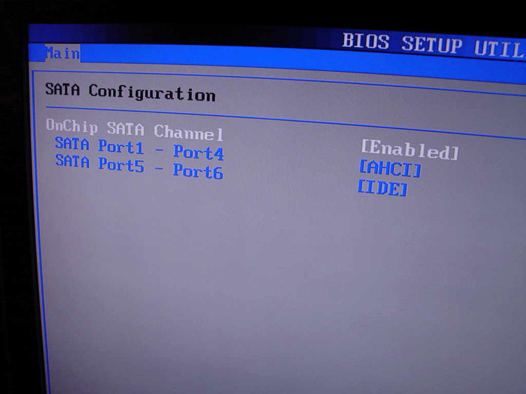

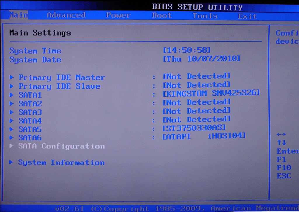

opiniatre Posted October 7, 2010 Share Posted October 7, 2010 Help me again please! After editing DSDT.aml (ordered my video card), the system does not want to boot, says "Still waiting for root device"! Since the original dsdt system to boot!Below is the original and patched dsdt (with the registered card) You can boot from an EmpireEFI_V1085_AMD R2 and then re install correct DSDT. (use LegacyBootCD.iso) I like having a rescue cd with EmpireEfi at hand for those kind of situations. Also check that you are in AHCI mode for the hard drives. I had a problem using 2 Hard drives on this board (slow as hell and beach balls on the second drive and dvd!) so I had to put the second drive and Dvd Rom on port 5 - 6 in IDE mode (and AppleATIPATA.kext in extra/Extensions). (In case you or someone else has this issue with this board) Quote Link to comment Share on other sites More sharing options...
