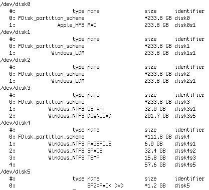

If you're running those two disks as SATA on NTFS, you might have the same problem I had.
You can verify my theories by typing in the following:
diskutil list
If it comes up listing those unmounted hard drives as something other than what they're supposed to be, it could work.
Link to my thread.
Sorry...I just skimmed what you wrote. My procedure might make them mount properly, but to not have them automount at all, you'd probably have to remove the kext driver currently associated with those drives (you'd still have to do diskutil list to see what OS X thinks they are) in order to get it to not mount at all.
IMO, it will be more of a pain to unmount those disks (to avoid the Initialize... screen) than to try to get them to mount.
Okay, try going into /System/Library/Extensions/IOStorageFamily.kext/Contents, editing Info.plist, doing a search for Windows_LDM, delete Windows_LDM, and replace it with a space. If that doesn't work, it's impossible to do what you ask.
The reason why you are having issues with your hard drives is that they are set up as dynamic disks inside of Windows XP instead of basic disks. I don't know of an easy way to convert them to basic, either.

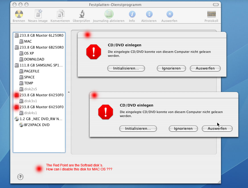

how can i unmount some harddisk ???
i have under windows XP a SOFTRAID with 2 SATA drives.
But MACOS can not read it.
Every Systemstart it post "unknow DVD".
How can i disable this drives for mac OS ???
See Picture :P

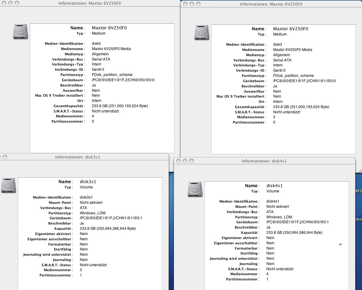

The only thing that I see in your setup, is that your problematic disks are in SATA. The others are in PATA. (I think the Samsung too).
A methode to exclude these disks would be to edit the Plist of the Kext that recognise your SATA and to delete/modify the device ID of your motherboard.
But you'll have to know which it is. Give us some details about your hardware, motherboard's brand and type.
See Picture :)
